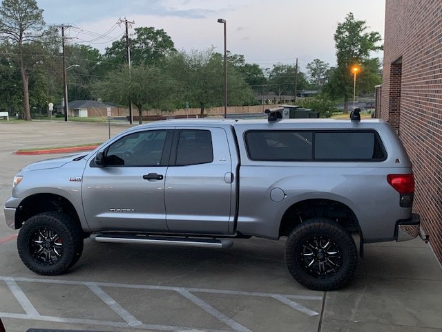

    6" Procomp Stage 2 lift Black Rhino Sierra 20x10 0 offset on 325x65x20 Nitto Ridge Grapplers Smitty Built M1 front grill
    I want to do it so bad. I just don't know if i can fit with the bumper on. I have a ton of wheel well clearance now. The current offset is zero. 325s on 20. truck.jpg

    I might have to get BMC done. I've got a ton of room but might have to cut.

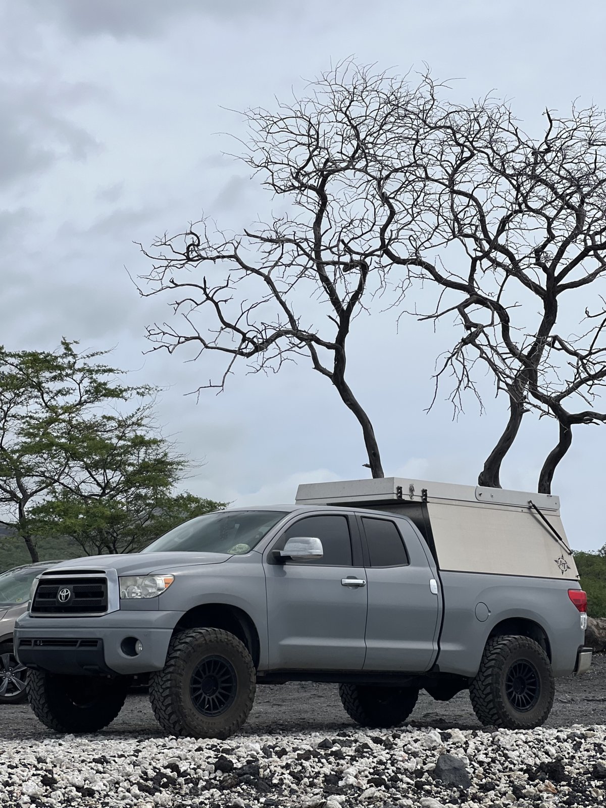

    2012 Toyota Tundra TRD Off-Road
    OME, SPC, CB, Toyo Tires, Method Wheels, 37”, Decked, AT Overland Habitat
    2012 Tundra
    18x9 +18 Method Wheels wrapped in Toyo M/T 37x13.5
    Cab Mount Chopped
    Wheel Wells Recessed
    Front: OME 2.5” plus .5” CB shims, SPC Upper
    Rear: OME shocks w/ 3” CB shackles, Dakar Leaf
    The only issue I have is your diff you can only drop so far down that you’ll have issues with your CV boots popping off. It’s inevitable.
    I’ve had mines pop off twice already and I’ve decided to replace the upper boot with CVJ red boots but haven’t gotten to doing that still.
    I carry an AT Overland Habitat and yes, I daily this bugger with that thing on and have gotten to places off road where midsize go no issues. No rub.

    I have SPC UCA’s. No wheel spacers. About 1” space between UCA and tire. Gotta fut around toe or just take it to the hop and get them aligned properly. Best bet would be to get a 37x12.5 tires on a 18x8.5 0 offset
