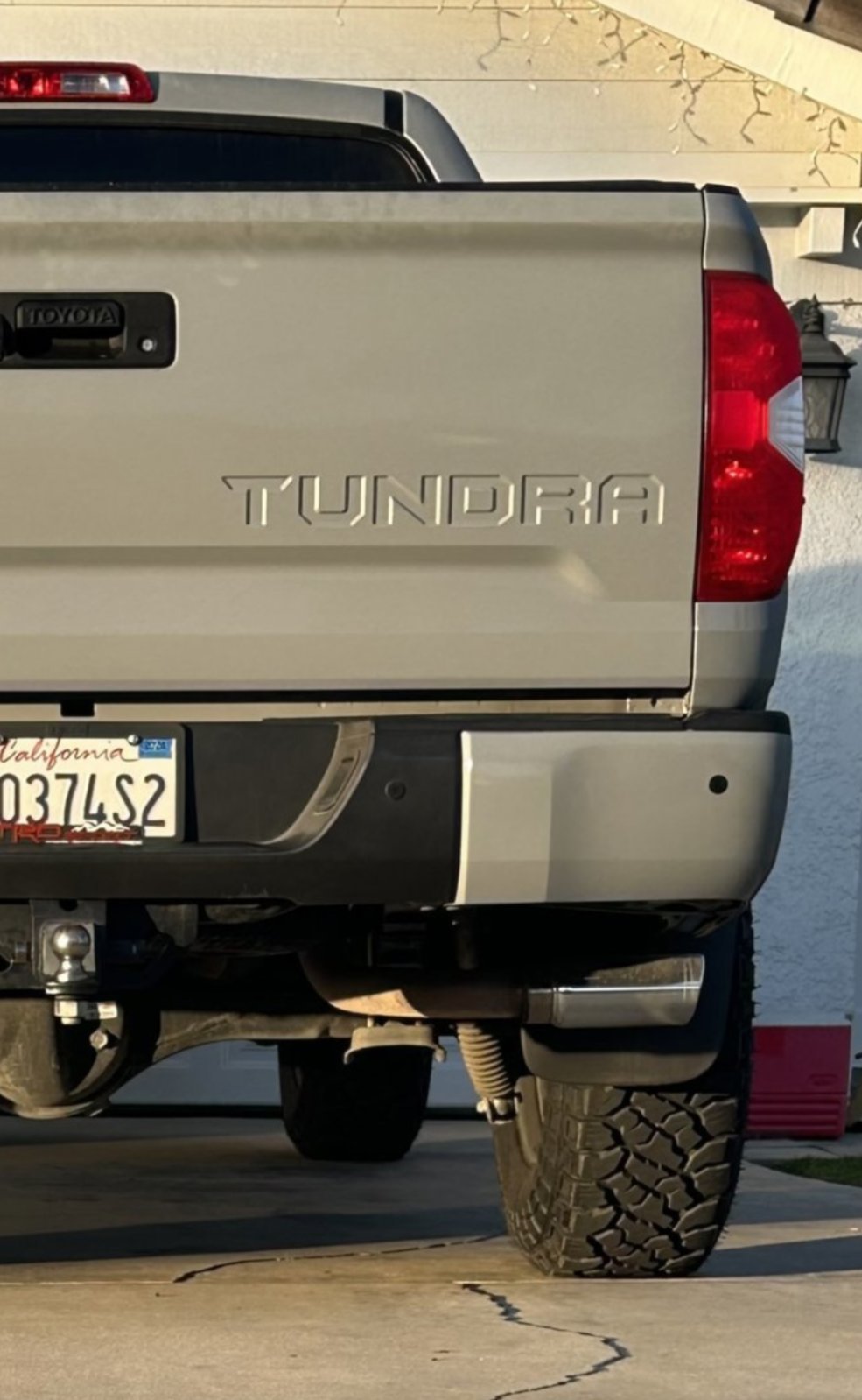

    tire poke pics of my 285s (+18 offset) from before I added fender flares
    [​IMG] [​IMG]

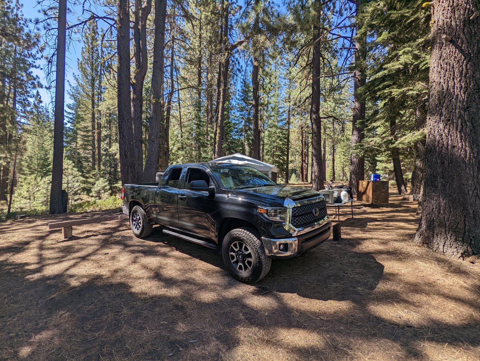

    285/75/18 Falken AT3W on a 3"+1" on OEM TRD rims. Only rubbing on full lock on the passenger side sway bar. Only mod was removing the front fender mud guards, no chop, bumper spacer or UCA's required.
    Truck also aligned all within spec and tracks straight. Tires were also easily balanced without issue.PXL_20220903_180741588.jpg PXL_20220903_180751459.jpg

    @ahern did you get this issue with rubbing fixed?
  6. Dec 11, 2023 at 3:42 AM
    #36
    ahern
    ahern New Member
    Jul 20, 2022
    #80918
    7
    2019 Tundra DBL 4x4
    I haven't taken the time to fix it yet. I don't have pictures but the tire did rub off some of the powder coating off the sway bar. I'm sure a small (5mm) spacer will alleviate the issue but I learned to never go full lock left. Forgot to mention that the rubbing occurs only in reverse haha
