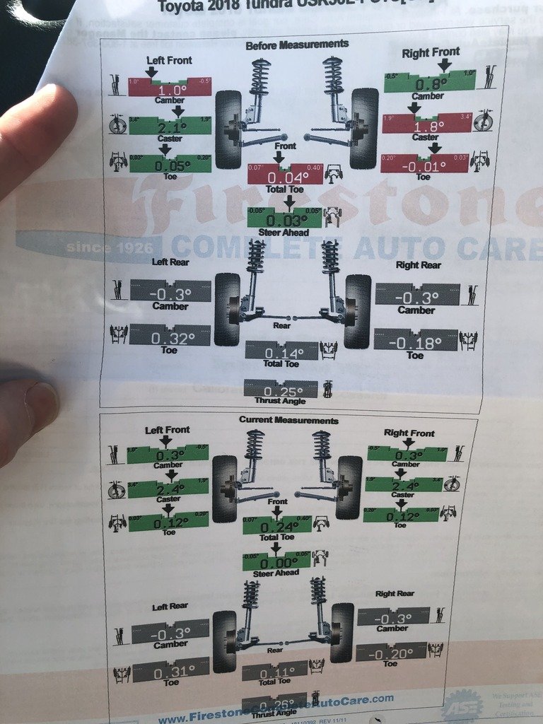

    @15Yota here’s the alignment sheet after picking it up just now. Thoughts?

    They are about spot on. Remind me your lift setup?

    Who aligned it ?

    Any pictures of your front tires now after the alignment?

    Heavens to Betsy. Well I appreciate all the insight, I wouldn’t have gotten it aligned again for awhile if you didn’t say anything. Think I should be alright without UCA’s now?
    Firestone aligned it. They aligned it the first time, but I used a different firestone this time. I should have taken a before tires picture... I’ll run outside in a few and try and get a new one.
