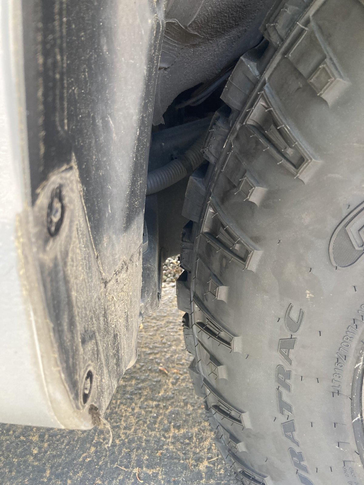

    With 315/70r17 and rock warriors you can fit with only removing the mudflaps. No lift no spacers in these photos (with no issues/rubbing). The big pro of this tire size over 35x12.5 is you can get Load C and D tires which are much lighter, it’s the OG “raptor” tire size.
