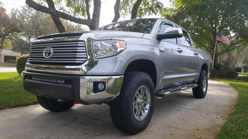

    285X75X18 Nitto Terra Grapplers, 3/1 with 285's look perfect on trucks without fender flares...

    If you go 12.5" wide on stock wheels, you'll likely hit your UCAs.
