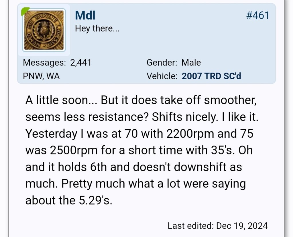

    It may even be a 100rpm less than this.

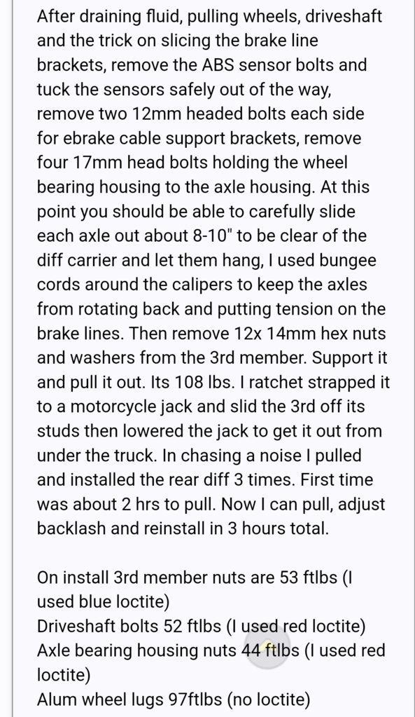

    It's crazy you've done this so many times. I'm hunting around for an installer in Las Vegas.
    Also, dumb question but to they need to drop the axles from the truck when the install, or do the just pull shafts to remove the ring gear? Also, did you replace bearings when you do this mod?
    s

    lol! Lots of trucks. In the front the entire diff comes out as one piece. In the rear, driveshaft is disconnected and axle shafts are slid out enough to pull the third out.

    Here is a write up that is pretty decent. For the rear.
    https://www.tundras.com/threads/diy...ntial-regear-at-home-not-for-beginners.67185/
    http://gearinstalls.com/Chris2014Tundrafront9.htm
