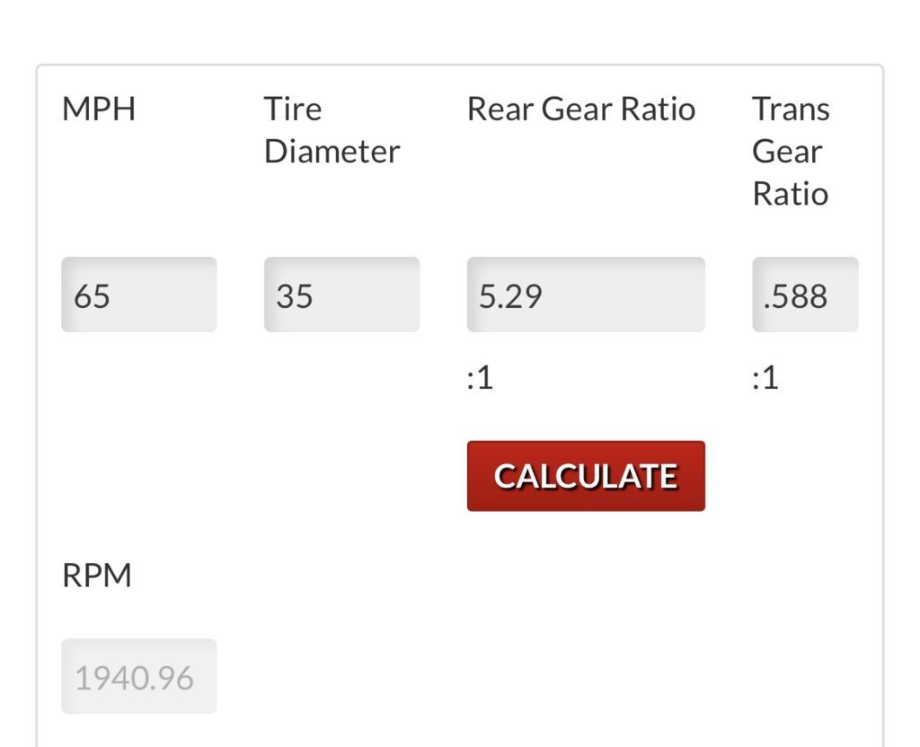

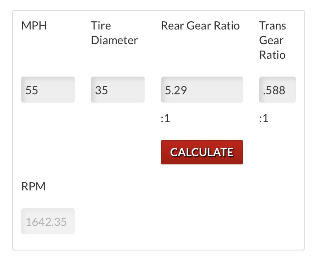

    UTAHRTK
    UTAHRTK [OP] New Member
    Jan 1, 2018
    #11881
    644
    SOCAL
    2017 MGM Tundra TRD CM
    Dirty Deeds 8" standard exhaust, King 2.5's/Bilstein 5160's, Built Right UCA,s, Method 701's, TOYO ATIII 35x12.5x17, TRD LED headlights, Pro Grill
    Ill take that as a 34.4 will be OK:oldglory:

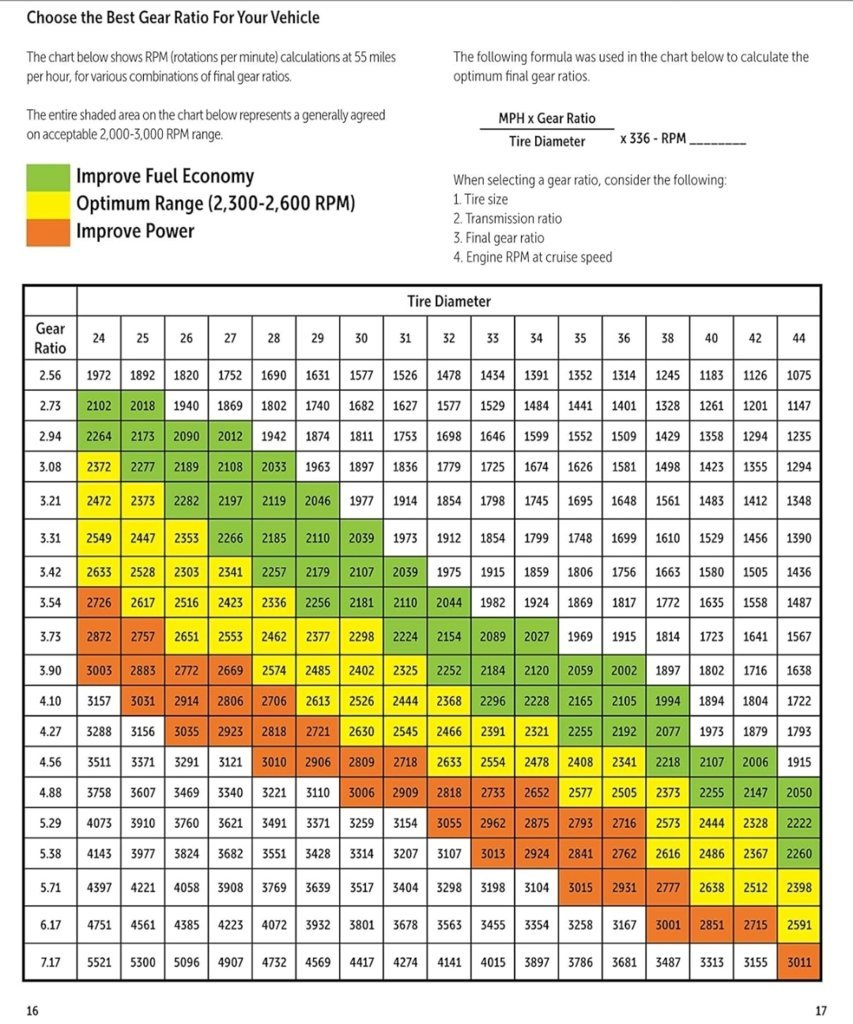

    Silver17
    Oct 3, 2021
    #68847
    3,671
    Eastern PA
    2017 TRD 4x4 Harrop SC
    Looks like that chart is off considerably and doesn’t take into account the 6th gear ratio of .588. 65mph on 35s in 6th with 5.29s is about 2000 rpm like @rcsbguy video shows. 35s on 5.29s makes the effective ratio about a 4.88 on stock tires equivalent. The tundra has tall trans gearing.

    helidave
    helidave Hellacopter
    Oct 3, 2018
    #20151
    1,404
    flagstaff
    2015 DC 4x4
    Magnuson 2650 w/76mm pulley, ADS suspension, 35's, misc overlanding bro-trophies
    Pretty sure that chart is for early 2000's jeeps
