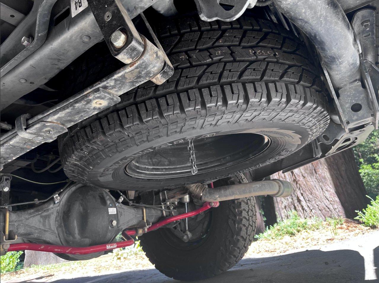

    Black Rhino Rapid 17" 35x12.5 Mickey Thompson Baja Boss Fox Performance Elite 2.5 DSC at 3" with Coachbuilder 1/4" shim on driver side JBA UCAs Fox Performance Elite 2.5 DSC rear shocks Dobinsons HD Leaf Springs Firestone Airbags + Daystar Cradles Prinsu Cab Rack 2024 Four Wheel Camper Project M Camper Mods: Goal Zero Yeti 4000 house battery 200w solar IceCo fridge Truma Propane Heater
    I've fit a Yokohama Geolandar AT in 285/75/18 on the stock steel spare between coachbuilder +3 shackles. Its a very tight fit and I had to grind the guide tabs on the back off. It wouldn't fit without that since it needs to be pushed toward the axle more. It's been there for a couple months now with no issues—on road and mild off road.
    That being said, I don't have a resonator pipe like you mentioned. I also wrapped a part of the tailpipe in heat wrap where it got within 1" of the new spare.
    My long term plan is to ditch the shackles and go back to OEM and achieve lift via new leaf springs

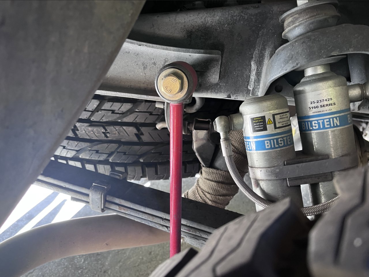

    Just an update. I found a used 285/70/18 tire on Facebook for $40, got it mounted and balanced for $42 at Discount Tire. Went to raise it into place under the truck and it fits between the coachbuilder shackles, but it is hitting the rear bumper and resonator from DirtyDeeds.
    I'm supposed to drive 350 miles this weekend. Is it okay for the spare to rub against the resonator? Any thoughts on a quick solution to get through this trip? Should I buy heat wrap at AdvanceAuto and wrap the resonator? Try to adjust it?
    Thank you for everyone's advice and help so far on my spare tire questions!
  20. Aug 26, 2022 at 8:17 AM
    #50
    DanTundra
    DanTundra Danny
    Apr 2, 2017
    #7074
    109
    Wilmington, NC
    2015 Ribbon Blue Tundra SR5 4x4
    TRD sway bar, airbag kit, Diamondback HD, LED headlights, Pedal Commander, Bilsteins 6112's up front with shims (2.5 inch lift), 5160s in the rear with CB +2 shackles (1.5 inch lift), Falken Wildpeak AT3W 285/75/18, TRD Pro Grill insert, MattGecko under hood and bed light kit,
    Thank you for everyone's feedback. I unbolted the DD resonator and shifted it a little forward and up to make space for the tire. Plenty of clearance now.
    285/70/18 used Toyo Open Country spare on stock rim
    +2 Coachbuilders shackles
    DD resonator
    Removed the tire guides so I guided the tire in place manually as a friend cranked it up.
    Passenger side- There is less than 1" of clearance from shackle to tire
    Driver's side shackle
    Resonator
    Rear bumper
    junior and Tundra18overland[OP] like this.
