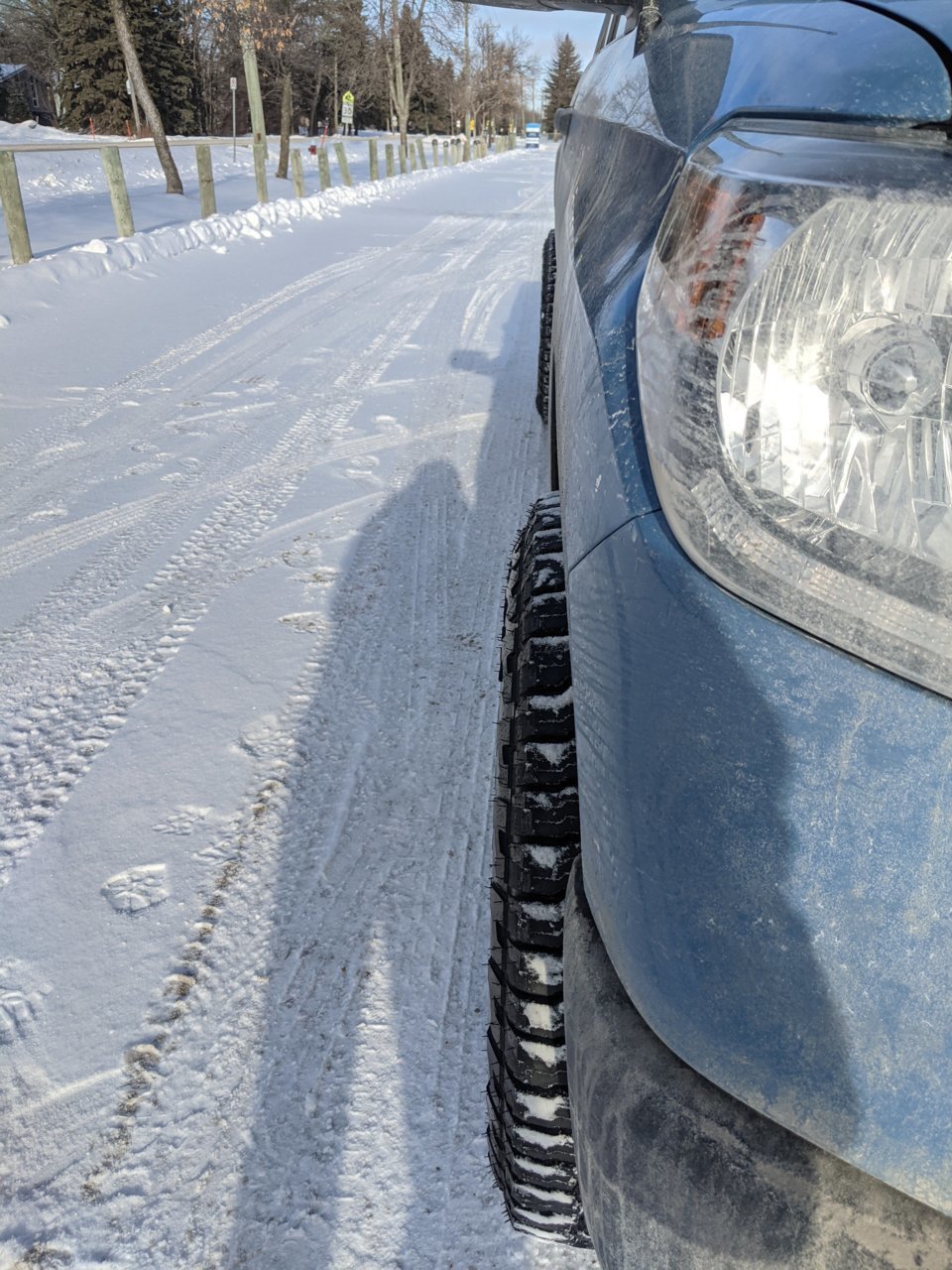

    my 18x8.5's with +10 stick out 1.5" or so. More up front than back. See pic below.
    -18 on a bigger or wider rim will stick out even more. I'm guessing you'll be out 2.5-3.0"
