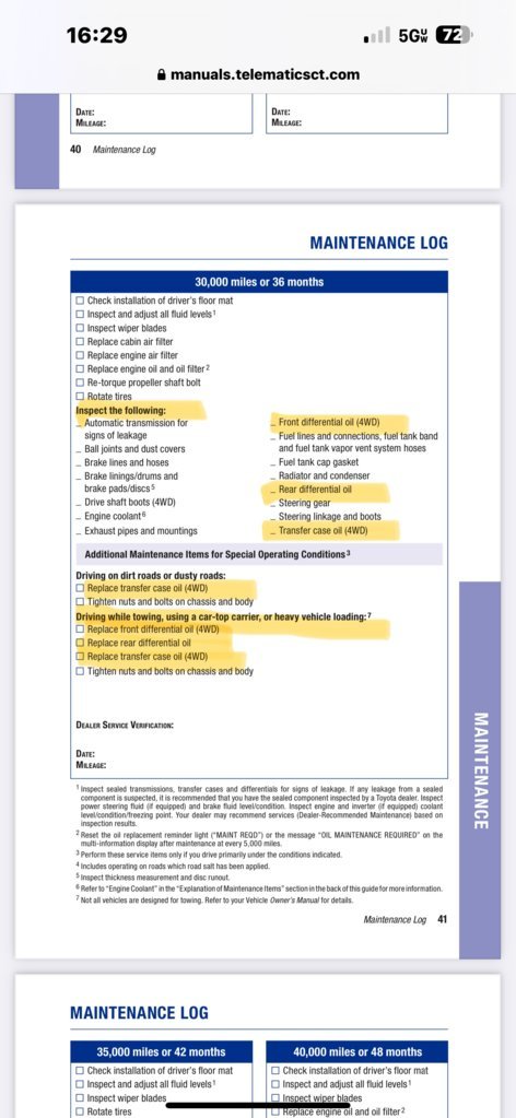

    September update - I finally hit 30k miles on my 2021 and figured I would call another Toyota dealer that has seemed trustworthy in prior service activity. 2nd dealer I called is not as convenient, but as you will see, apparently worth the extra effort. I was curious to see how their 30k mile service list compared to the one above. To my surprise, they only recommended the fuel emissions service, oil change, tire rotation and overall inspection. Total of ~$300 vs. ~$1,500 quoted above. WTF? So I dug into the Tundra warranty and maintenance guide to confirm, and sure enough there is no recommendation for differential fluids, transfer case, alignment, brake fluid, power steering fluid at 30k mile interval. I can only imagine how many folks at my local dealer have paid for a number of the items listed above based on "recommended by Toyota at 30k miles" when it's not even recommended by Toyota.

    Some of it is recommended at 30k miles, depending on how you use your truck.

    Yes, I read the maintenance log and noted that diff fluids and transfer case should be considered at 30k - depending how you use the truck. But they didn't ask me how I use the truck or recommend inspecting the fluids first. And based on my use case (never towed anything, not enough significant dusty road miles...), the differential and transfer case fluids don't need to be changed. Confirmed by the 2nd dealer I called. I asked them about differential and transfer case fluid, and they said it wouldn't need to be done at 30k. This is purely greed and borderline attempted theft by the first dealer.

    Every person uses trucks differently. I try and do diffs every 30k miles (I tow a lot and heavy weight). Now I have also known people that never do axle gear lube for 250k miles. No failures or problems. Go figure. Then there are people that have failures 200 miles outside of the warranty.
    For you, going 50-60K miles probably is a safe bet.

    I too just hit 30k miles on my DC truck. I have big tires and am off-road pretty often. I'll be changing all my fluids myself over the next couple weeks. Except brake fluid. I'll have a shop do that.

    Absolutely. Depress the brake pedal and fix it against the seat with anything, one wheel off at a time, pump a few oz out, top up. The first corner will be longer, because you need to evacuate the reservoir full of old fluid first. But really nothing complicated. ATF replacement is much worse, especially with cat shields installed.

    If you do brake pads at the same time then push pistons back with the bleeding screw open. That would empty the calipers (where the most of old and dirty fluid is).

    Moisture can cause corrosion issues and stuff. And brake fluid can absorb moisture. Also I've been told too much moisture could cause your brake fluid to boil. That can cause spongy brakes. Maybe even total brake failure?

    My 60k is my next service.
    front & rear diffs, transfer case, transmission drain & fill.
    My brakes are good.
    BillyB likes this.
  27. Sep 26, 2024 at 3:58 AM
    #57
    Bammer
    Bammer I'm disinclined to acquiesce your request.
    May 23, 2019
    #30901
    1,483
    John
    Monroe, CT
    2019 Tundra SR5 TRD Crew Max 4x4
    Next service is 90k, this weekend.
    Transmission -drain/fill - every 30k
    T-case -replace - every 30k
    Both diffs- replace - every 30k
    PS fluid - first time - will do every 60k
    Oil/filter - every 5k
    Coolant drain and fill , every 7.5k until 4 cycles, then every 3 years
    Likely front brakes, done at 50k, but rotors were cut, so it's time as I have pulsation when hot.

    I just got half of mine done, at a local shop. The dealer did the oil change and forgot everything else after I declined their fuel cleaning so I am done with them. I use premium non-ethanol 99% of the time so I am not sure worried yet at such low miles.
    Just got the front and rear diffs change, drain and fill on the transmission, and the transfer case.
    Transfer case fluid is over 100 a quart or whatnot from Toyota, blew my mind.
    Total bill: $914.xx
    Labor was about 300, a little under. Fluids were just under 600, and tax was about 40.
    They said that there was metal in all of it, and the rear diff fluid was dirty. I have put loads of stone multiple times in my bed among other loads that might have pushed it. Happy I did the drain and fill, its shifting much smoother. My transfer always was loud and clunky, I am hoping it's smoothed out a little as well, but haven't engaged yet.
