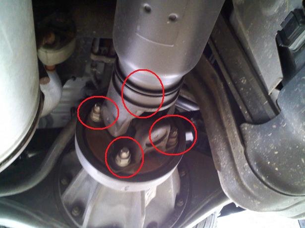

    You need a video on 4bolts/nuts, on the drive shaft?
    Here's a visual aid:
    28573d1273101123-propeller-shaft-re-torq_57628ca60ca25738c8595dc7acf42e6285aad211.jpg
    Good luck with that torque wrench in there, lol.....hence why most ppl don't bother at all, or at best we take a regular open ended wrench and yank on them to take them "tight" once in a while, if we ever remember.

    You can use a crows foot on the end of the torque wrench. There are box end torque adapters available as well but they cost a bit more. Harbor Freight carries the former but not the latter.
    Motion Pro makes a neat tool you use with regular wrenches.
    But yeah, lots of people just use a regular wrench and torque to 1.5 uggas

    Thanks, I guess I will just check if they are tight, that should be fine

    Re torque- break em loose and tighten them to the spec or just throw the wrench on and make sure they are all tight to spec?
