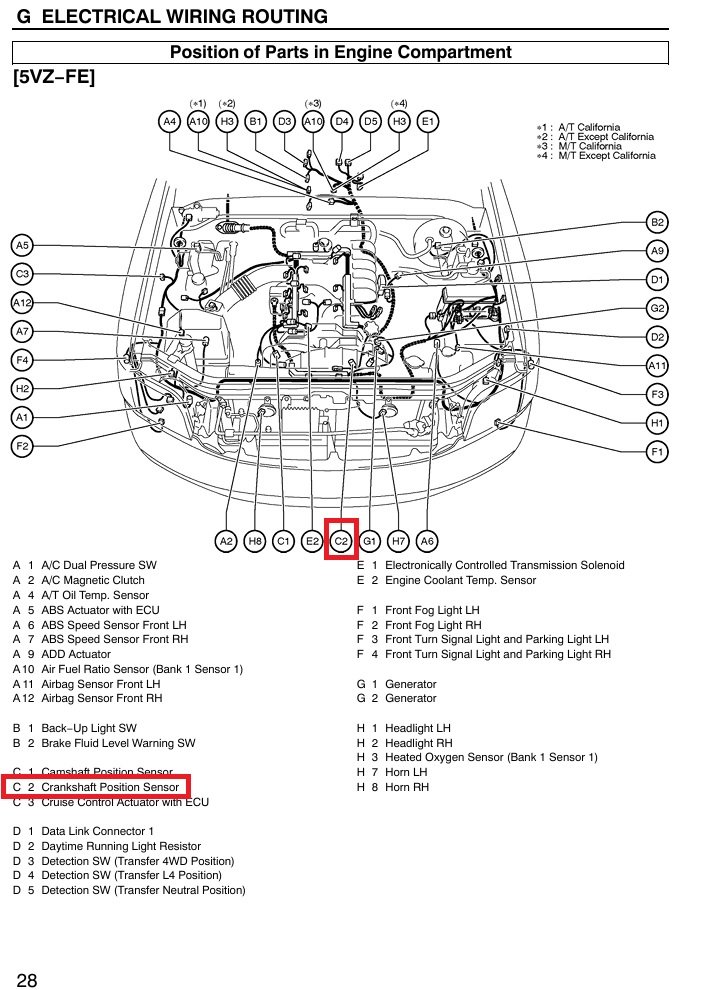

    Hello everyone I'm new here and new to Tundras. I'm having a no start issue on my 2000 3.4l v6 manual Tundra and so far have replaced the starter and the starter relay and tested the battery which is good. Next I'm looking at the crank sensor but I'm having trouble finding it and all the videos I see online are for the v8. Any help is appreciated

    V6 or V8, the crank sensor is driver side down by crank.
