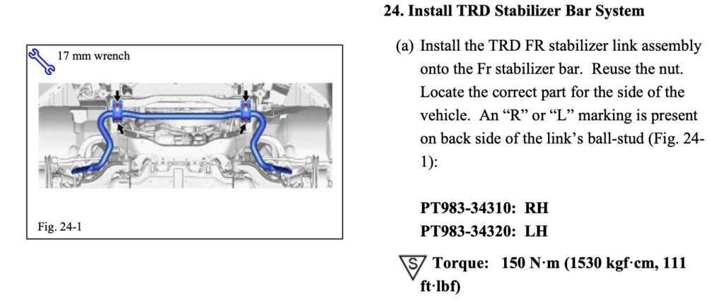

    Do you happen to know the part number for these? Is it this 'stabilizer link' assembly that I'm attaching a screenshot of? Part numbers for that are PT983-34310: RH PT983-34320: LH

    Links go at the end of the sway bar to attach to the lower control arm.
    Are you needing the sway bar spacers?
