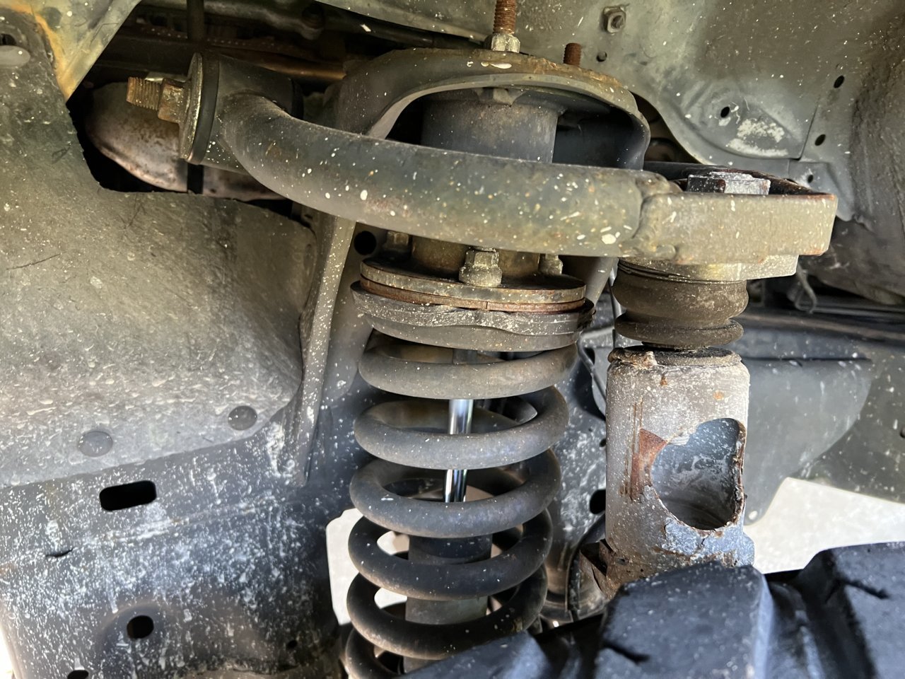

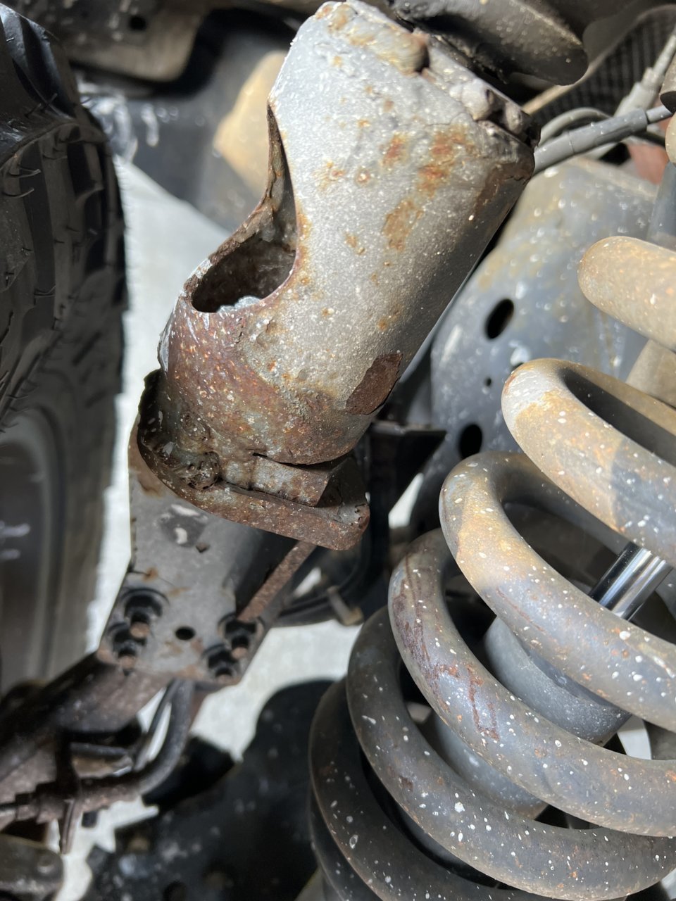

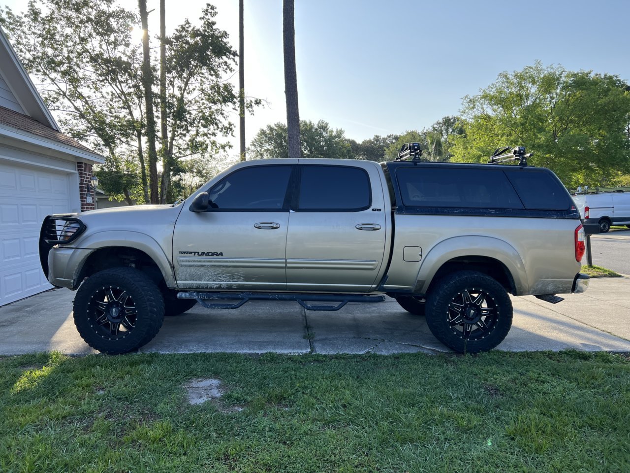

    So, here’s the truck finally. Oh that autozone special brush guard has a chunk ripped out of the lower bracket, probably from trying to pull it out of the mud. It’s a high school age redneck mobile and then some.
    threw in a picture of the TC spindle bracket- literally nothing about that feels safe, and the drop cradle twists when I turn, and no longer consistently holds my control arm in place. So it’s probably got to go regardless.

    It looks like those UCAs are SPC which are a nice product. SPC sells replacement upper ball joints if you're looking to refresh those. I don't see a grease zerk on them like mine however. Maybe that's a cause of one of the clunks?
    If you're going to get the extended Tuff Country spindles, I believe you'll need an SPC slug adapter for the spindles. It doesn't look like it was installed on that spacer thingy? SPC should be able to sell them to you.
    For shocks I would ditch that spacer if you can, but you'll need to get longer shocks made for a 4-6" lift. The Bilsteins I linked above should work, looks like Icon might sell them too. The longer Bilsteins would work in the rear too if you do a custom spring pack to get your rear lifted.

    All good options here. I used the Icons, another guy with this issue I talked to about what I did went with the Bilsteins I believe.
    Doesn't that look like an adjustable UCA? Not factory for sure. Looks like OP may already have SPC's from the picture.
    Just fyi @Gen 1 Frankentruck new Tuff country spindles have new Koyo bearings in them already.

    I do have SPCs. It’s the only thing I wasnt originally planning on replacing. Guess it would have been useful info. Hah, my bad.
