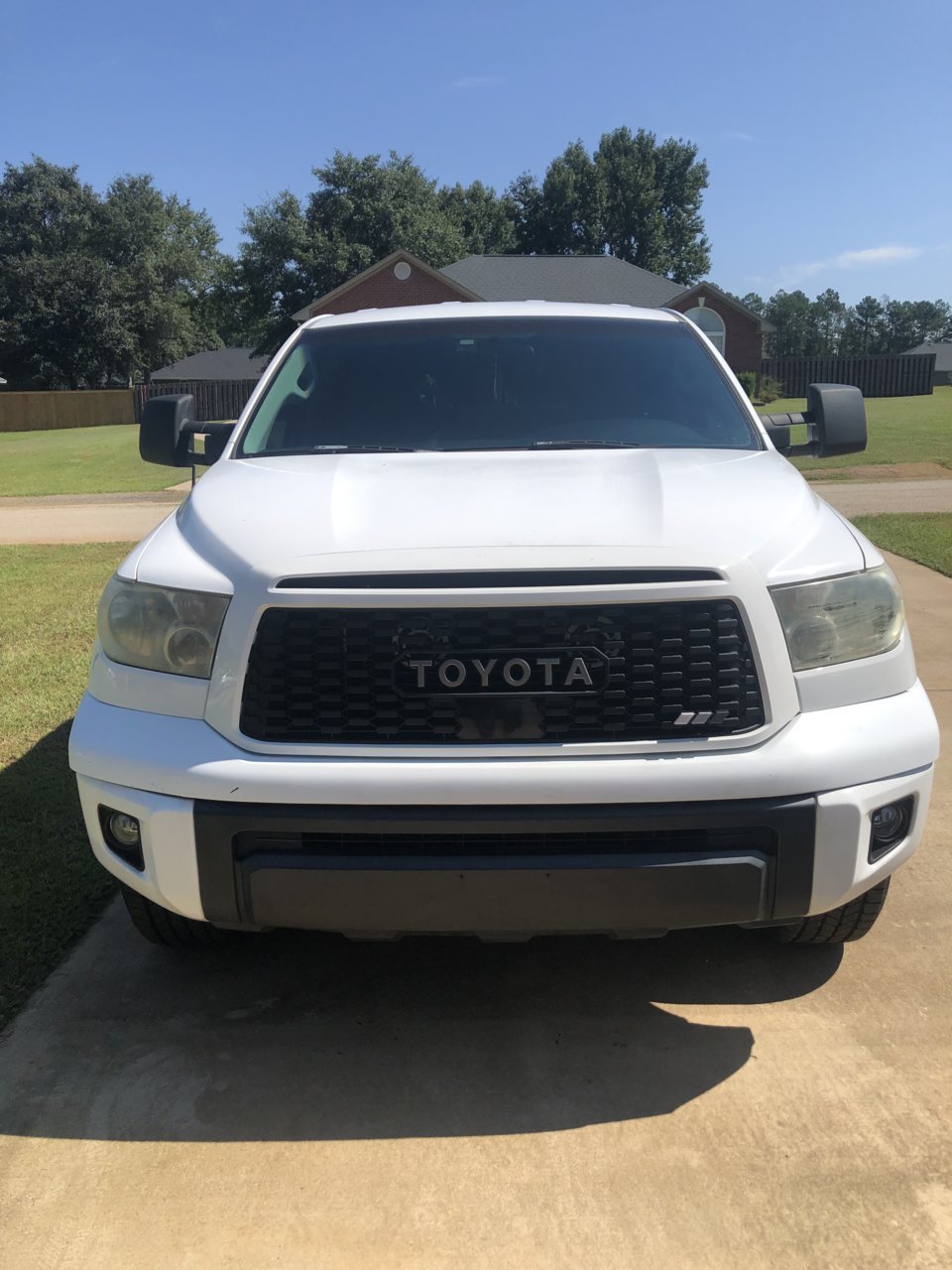

    Got it on the truck! Screw those clips on the insert. That definitely sucked! I know I need new headlights!

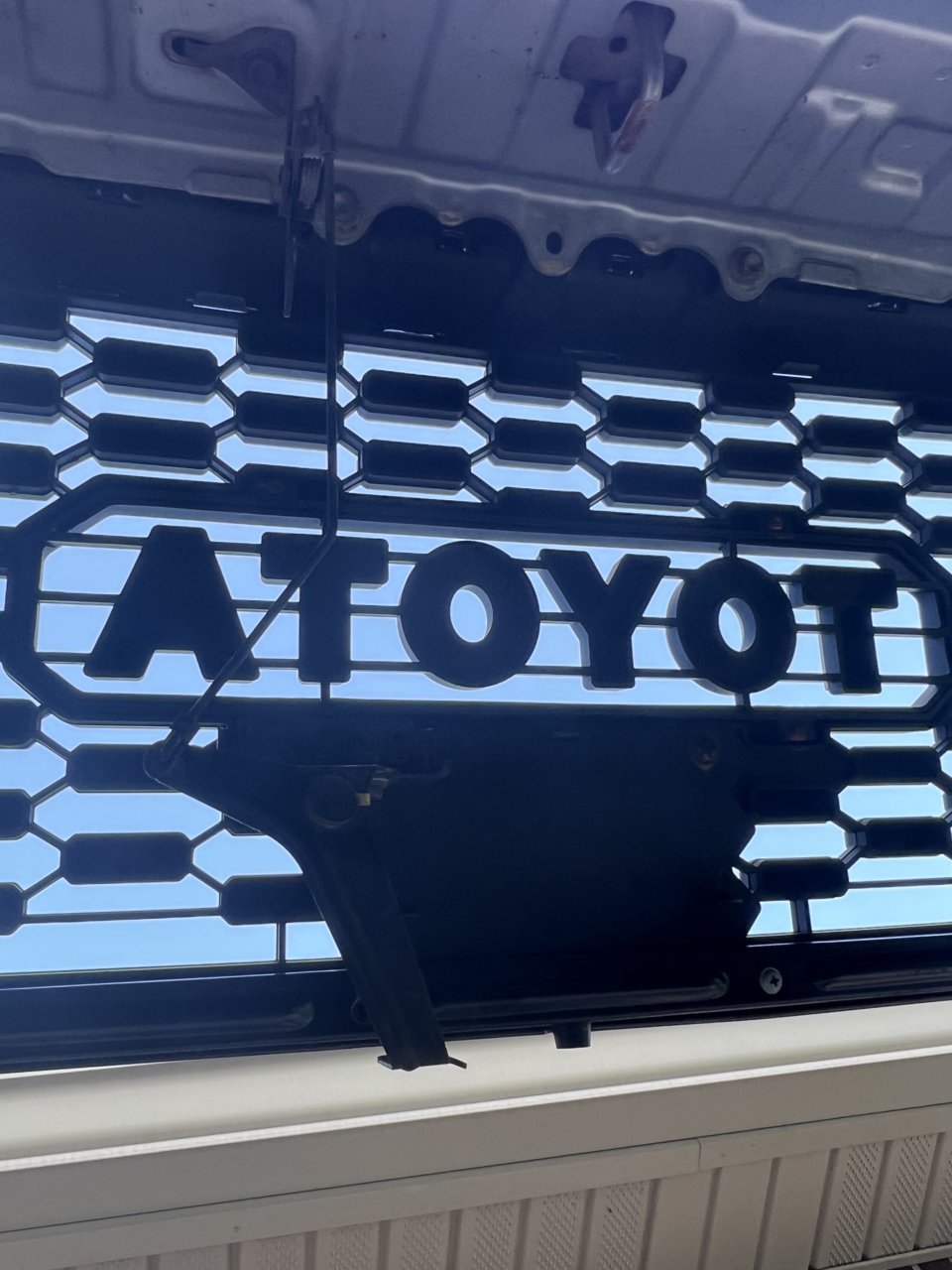

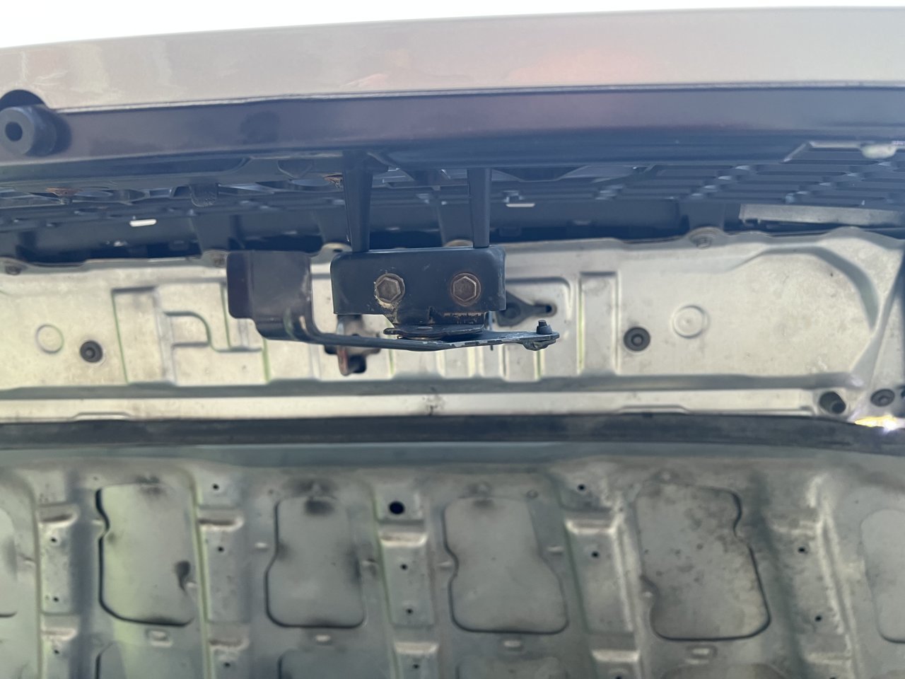

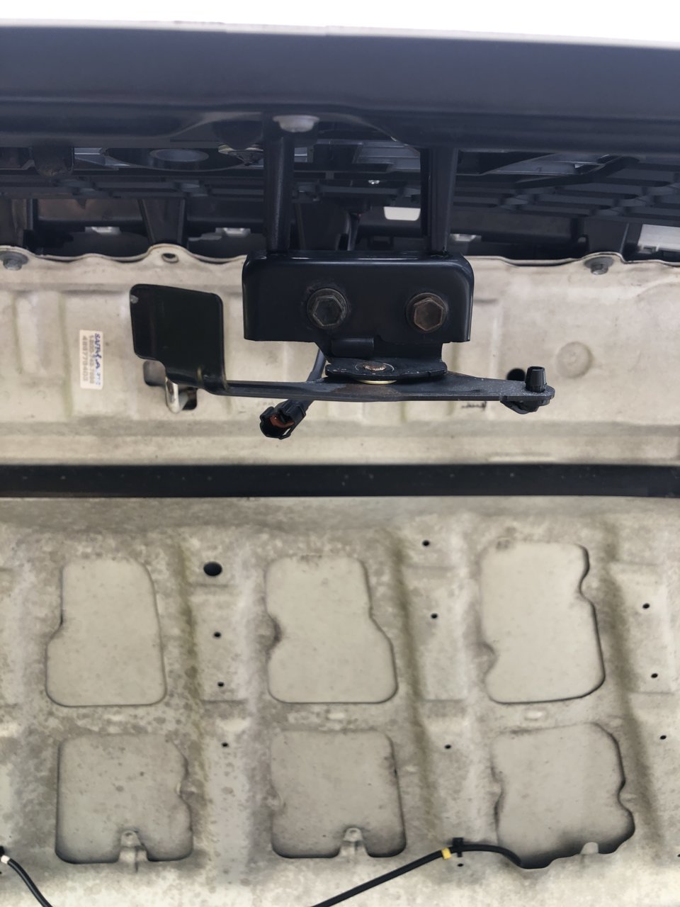

    Can someone post a photo of how the hood latch lever attaches to the grille? I feel like mine is installed incorrectly and I didn't pay enough attention prior to removing it from my old one.

    Thank you sir! I definitely had mine on wrong.

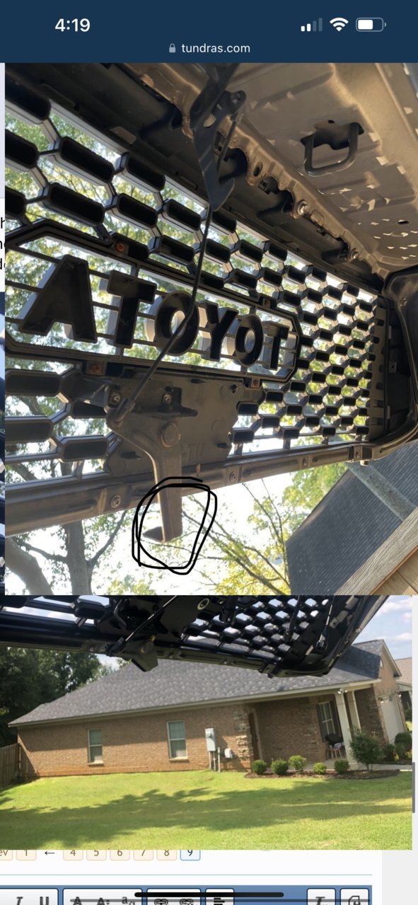

    this is how mine looks and I can’t get it to hook up any other way. Any idea what I’ve done wrong?

    Are you missing the release lever?

    it’s there, I just think I have it installed incorrectly

    That looks like it’s right

    Looks like you need to bend the rod.

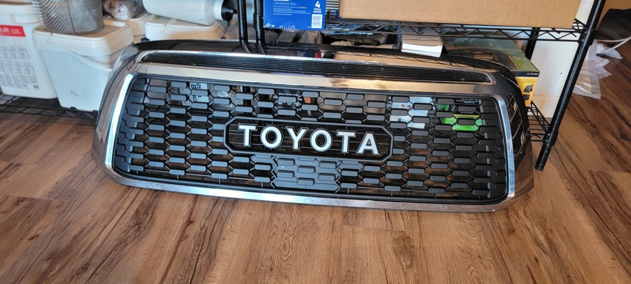

    Finally got mine done. Still need to do the raptor lights. I'm not sure if I just want to tap them into the running lights or run them off a relay triggered by the running lights.20220918_112110.jpg 20220918_112126.jpg
    Before.
    The plan is to color match it again ,when I get a new hood.

    Dude, I have no idea why mine was so straight but bending the rod made it work!
    Lmao. I've been having to snake my arm in the gap between the bumper and grill, grab the rod, and pull downward on it to release the hood. The lever has been completely useless. Thank you man!
