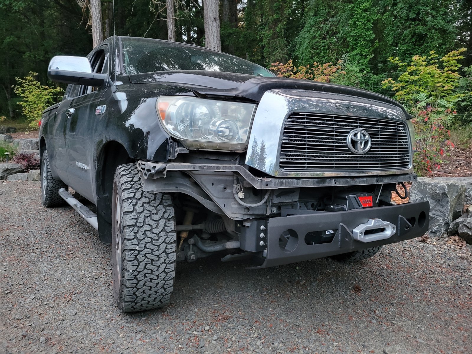

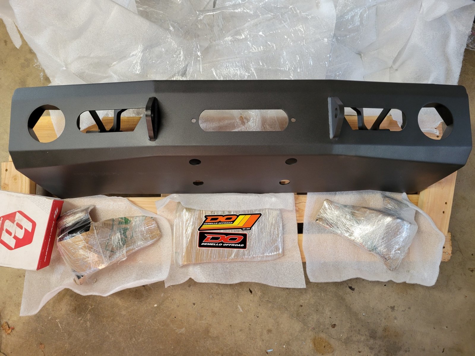

    Easily distracted, I guess: Studied this thread then ran off playing with RC Tundra and Stinger boat, radio installation, Banks Pedal Monster, tire pressure system, etc.
    I'm back, and made my choice:
    Demello Offroad Winch Plate insert (2007-2013) with a Warn Zeon 10-S Platinum winch. I like the stealth look and have no intention of off-road bashing. The winch will be a much needed tool which will also be 'out of sight / out of mind' when not in use.
    Order ahead because they make it just for you when you order and powder coating and shipping takes a bit. Unboxing is fun!
    I hope tearing apart and reassembling my perfectly good truck will be as easy.
    (Haven't unboxed the winch quite yet ;))
    (I also ordered the Baja Designs LED light pods, yet to be unboxed.)

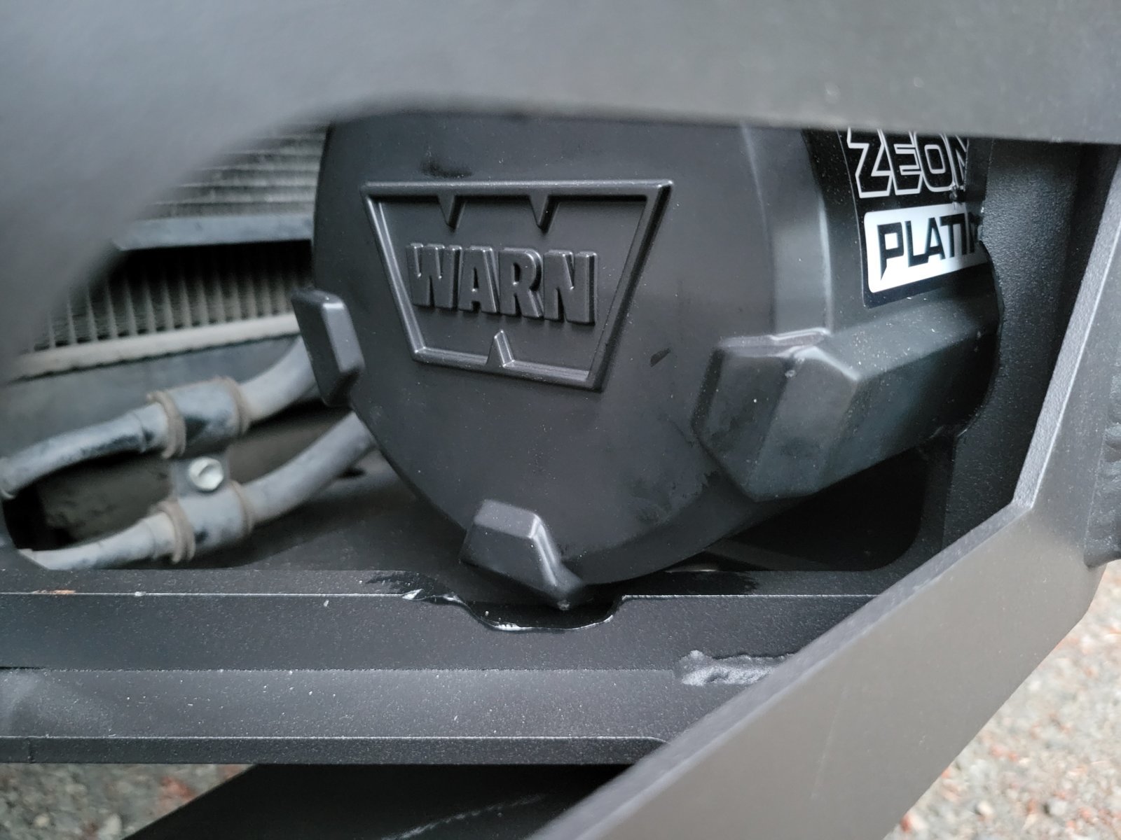

    Albacore tuna season is about to kick off. Last night, I replaced the 48 frame condenser fan motor in my ice machine. Summed up this morning then loaded the Demello Plate and Zeon 10S Winch and headed to mom's shop where there's room to stretch out tools and parts.
    The Demello Plate instructions are for whatever has a chrome bumper (SR5?). My 2008 Tundra Limited is color matched plastic/rubber. Still, nuts and screws were as instructed and disassembly was mostly uneventful.
    My bumper has no fog light support brackets. So, there's no use for the pretty brackets supposed to go in from them at 45 deg to the main plate's center section (behind the spot light holes).
    Regarding the spots: The Baja Designs pods are a bit undersized for the holes and the brackets locate them too far back for my taste. As well, they won't center in the holes without bracket modification, including drilling of the Demello plate mounting slots: Opening a larger hole in the center of a slot will be problematic. Wish they'd left the plate blank without mounting assumptions.
    On that note, the Warn Zeon 10S has a 4.5" x 10-1/8" mounting pattern [EDIT: Warn manual does say 10"x4.5"... but, the holes had to be whittled nonetheless], and the Demello plate holes were only 10", the lesser reason to run back home for my die grinder tool.
    The greater reason is that the Zeon 10S Winch would not fit without whittling out some material from the inner cross bracing... Heavy duty stuff requiring the right tool: a die grinder. Removed 1/2" from the bottom and about 1/2" from the front. Ahh... Just right!
    I painted the bared areas with Rustoleum semi-gloss black: Fortunately, none of the whittle-work will be exposed to full view. Pictured is after a 10 hour day, mostly being tenacious about it...

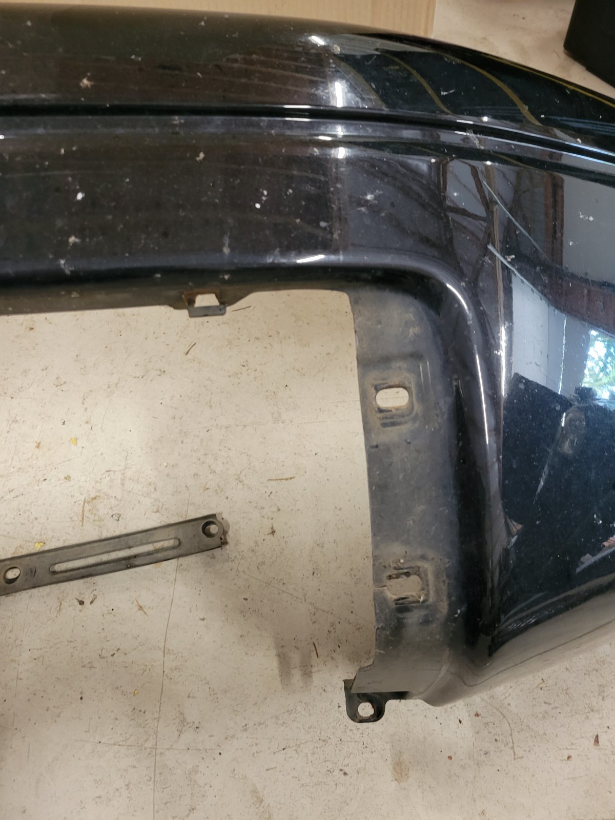

    Tomorrow, I'll tackle reassembly. On that note:
    The rearmost outer corners protrude such that they prevent re-installation of the factory tow hooks without spacers (a stack of washers is in poor taste - though it'd suffice short of lifting the truck with 'em). Cut the corners of the plate and they wouldn't be in the way.
    Instructions suggest cutting the bumper for clearance. What needs to clear are the spot light pentagon outer points... if they were round, clearance wouldn't be a problem. Since my bumper is plastic, I can cut a V with nippers. (If yours is chrome, a V with a cut off wheel would be better than taking out a 2" section.)
    The final hurdle (I don't see a clear 'way-round-it' yet) is that there's no means to attach the inner lip of the bumper to the plate. If that isn't resolved, the bumper will likely flop in the wind. It should be fix-mounted for tenacity sake, at least. Finally, I'm reluctant to cut the tabs (upper and lower) shown below, but suppose it must be done...

    Got my coastal off-road bumper all finished. Probably took about 20-24 hours from start to finish. I did all the work myself including paint. Used spray max primer and 2k hot rod black rattle can paint. Of course with any project I do, there are a few things I wish I could’ve done better and taken more time on but doing anything with work and family is a challenge.
    Trusty Rusty, myt1, OldGuy03 and 2 others like this.
  30. Jul 1, 2024 at 9:38 AM
    #270
    IIonPilgrimg
    IIonPilgrimg New Member
    Nov 29, 2023
    #107720
    186
    2008 Tundra Limited Double Cab 4x4 5.7 6-speed Red Rock
    The Coastal Offroad bumper is a DIY project - not for the timid - and that's some nice weld-work!
    Since it took me 10 hours just to install a bumper (and winch), it took only 12 or so to fab and paint yours to taste.
    Bravo!
