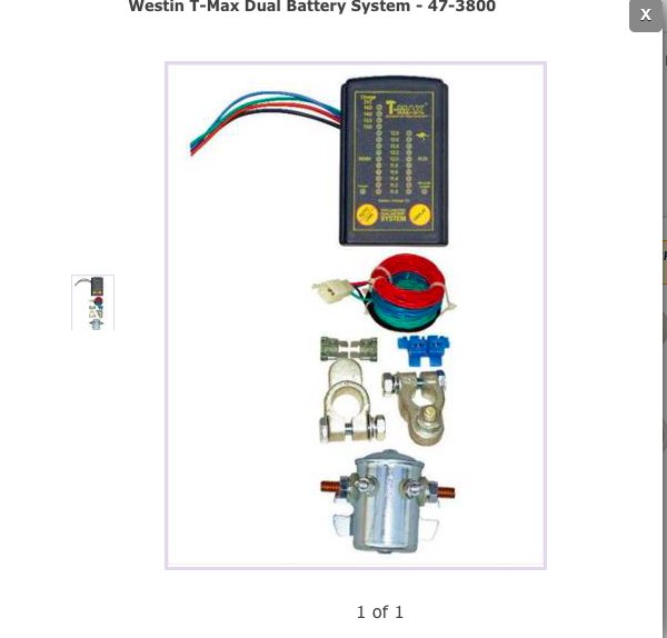

    Ive found a Westin kit for under mounting the additional battery under the hood. They also make another kit for mounting the 2nd battery back on the trailer.

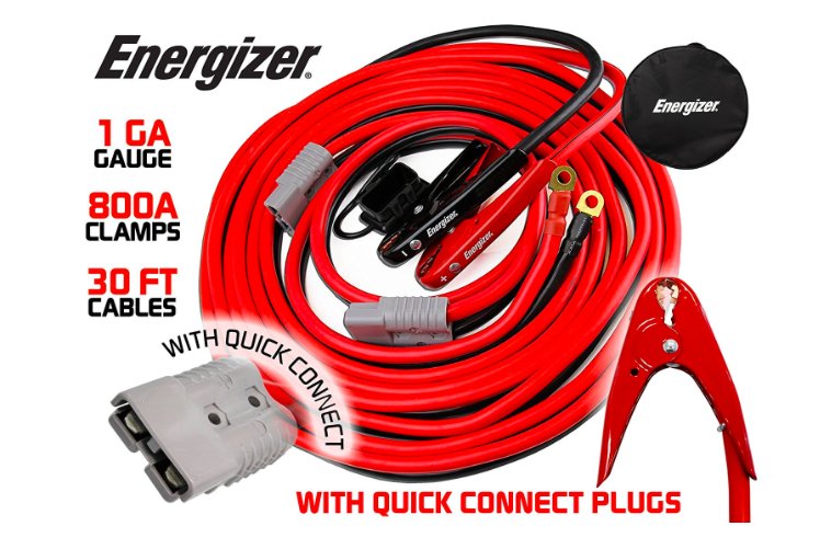

    Decided to go with the under the hood passenger side mounted extra battery. Will run 1 gauge under the truck back to the rear bumper and add a quick connect next to my trailer connectors.
    Trailer winch will have enough cable and the other end of quick connect to reach the truck. I can cut up this 30' cable kit (best bang and everything that I need for the buck) to make what i need and will have plenty of length and gauge for running enough winch power back to the trailer.

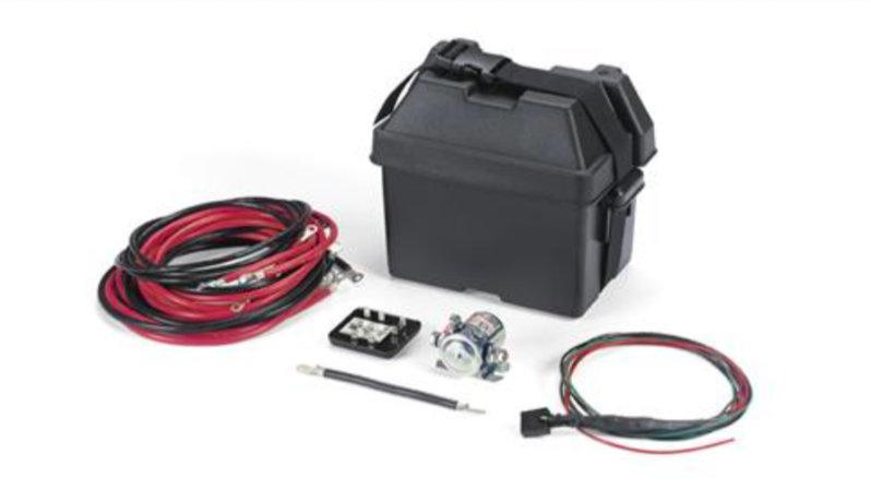

    Isolator kit is pretty straight forward and comes with everything needed under the hood included. Still hunting the right battery and tray. Might go with a Deep Cycle. Will post up some pics when Im done.
    SCREW THE WESTIN CRAP. Talked to a buddy of mine about his dual battery set up and the Westin kit he bought FRICKEN MELTED! All hooked up correctly and while he was testing it it almost caught fire!
