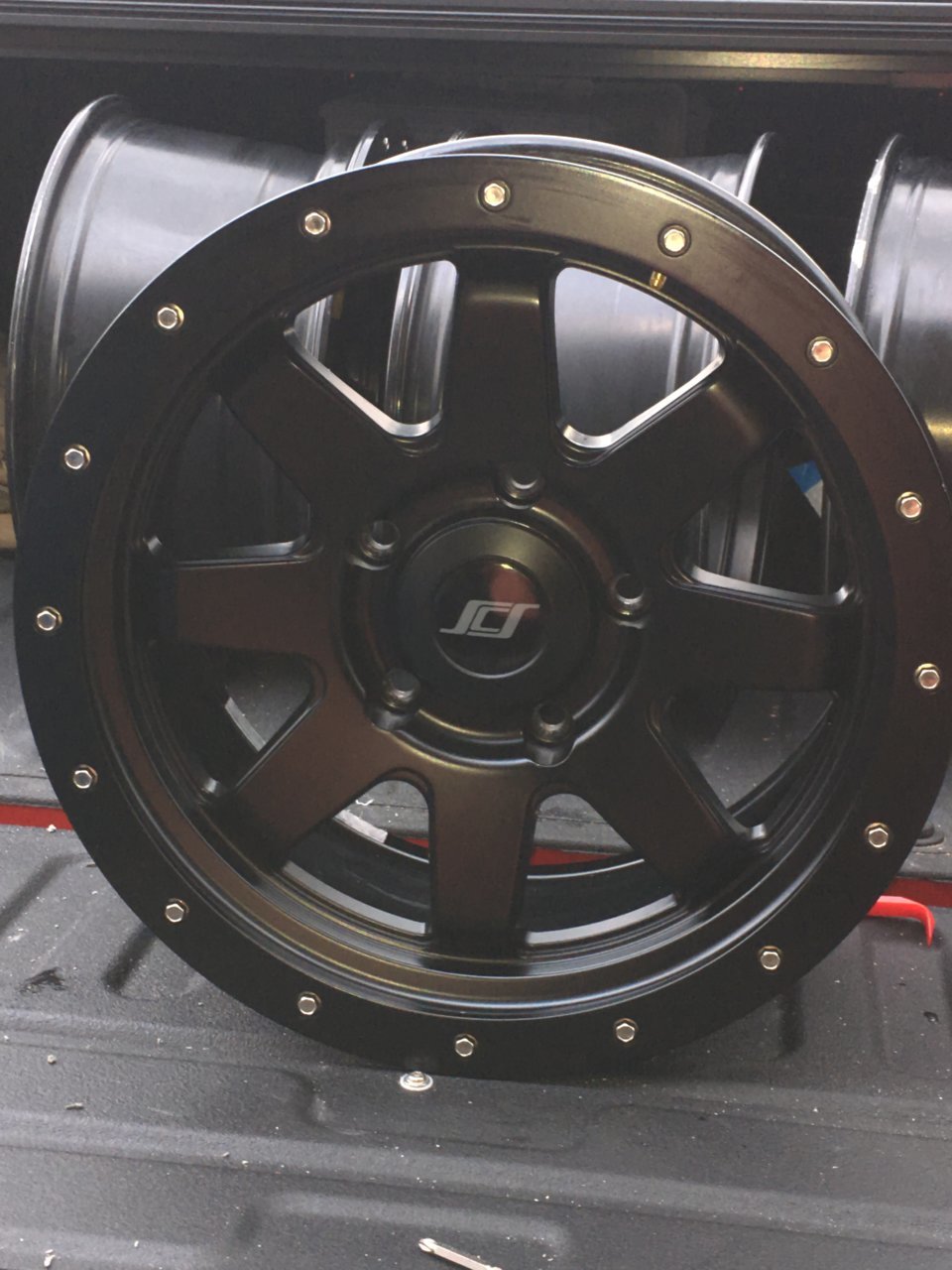

    So, for the steal of the week, I picked up these SR8’s for $500. Now after a ton of research, I’m thinking I want to wrap them in 295/70 18’s.
    I’m about to put the Low Range 3” front spacer lift on with a +3 shackle in the rear so effectively just shy of a 3/2.
    Anyone running similar levels 3/1 or 3/2 have some good pics of tires and size. Trying to affirm my idea of size or maybe see if there may be a better option.

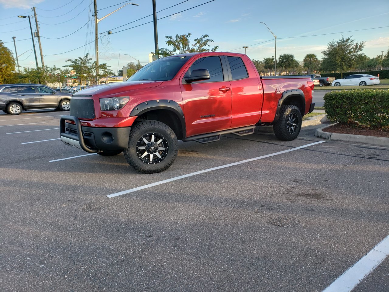

    I have a 3/2 with 285/70/18's Ridge Grapplers. The wheels are +1 offset. The 285's are 33.9. The 295 is 34.2. The advantage to the 285 is 10 to 12 pounds per tire lighter. My Ridge Grapplers are 59 pounds.

    Got any pics of the setup? Did you have to do any trimming? Mine are +25

    Just added pics and no trimming at all.

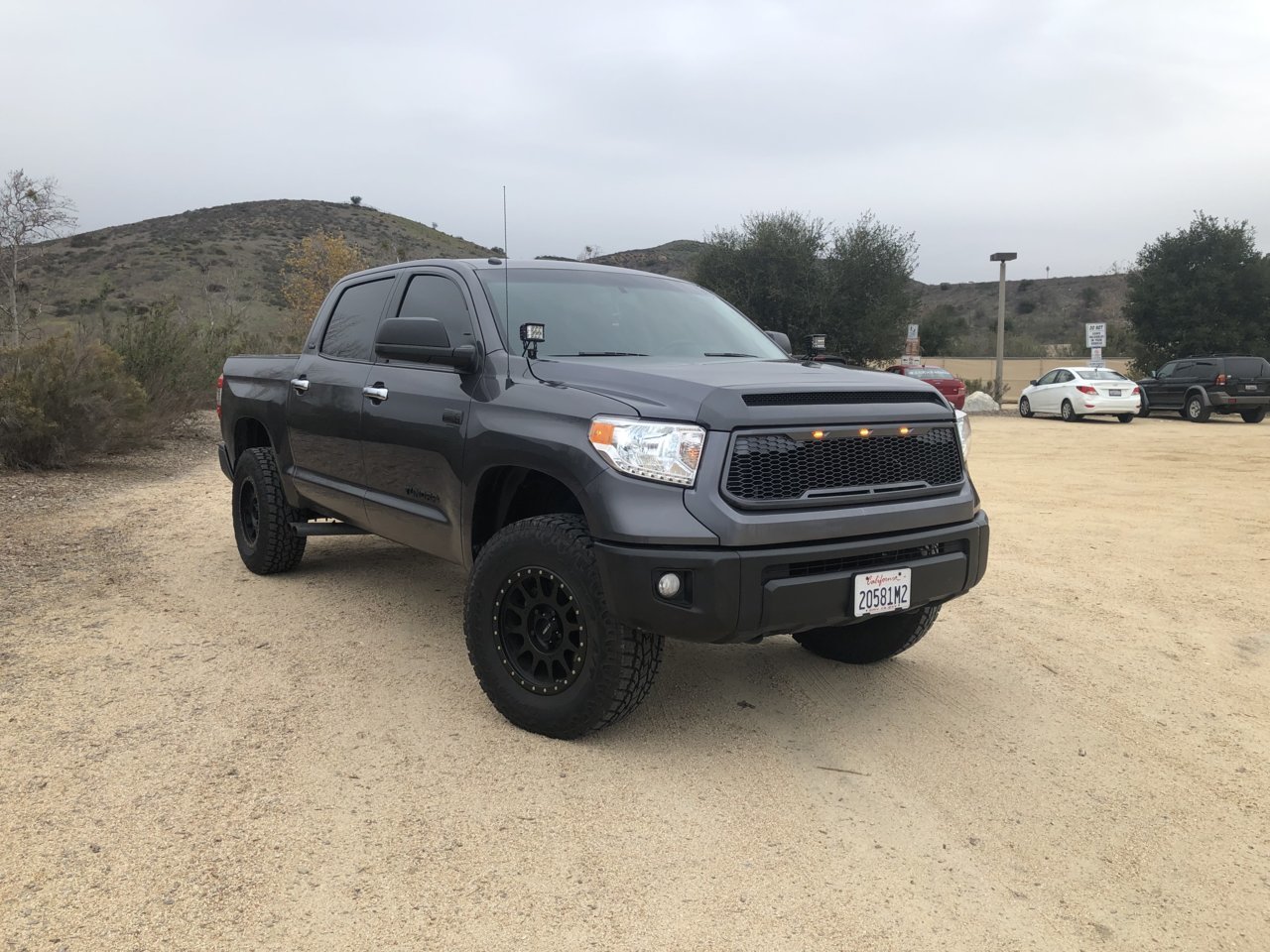

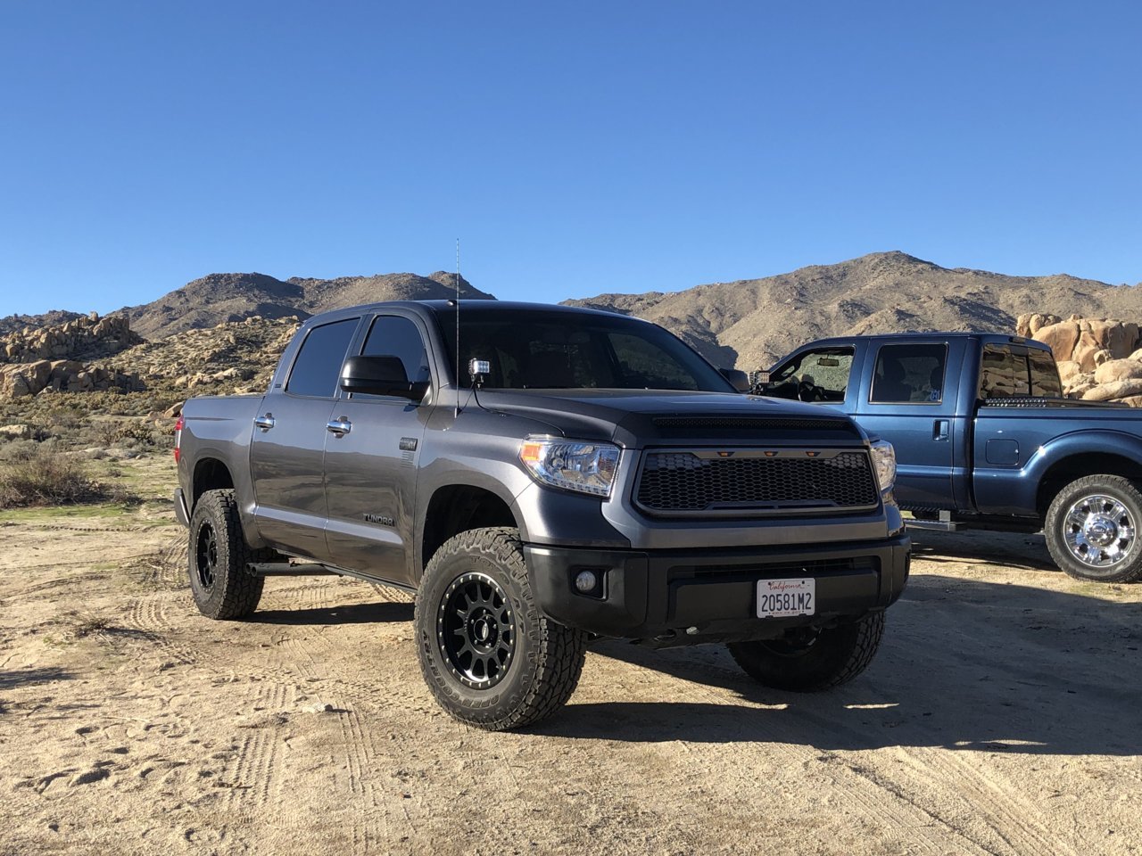

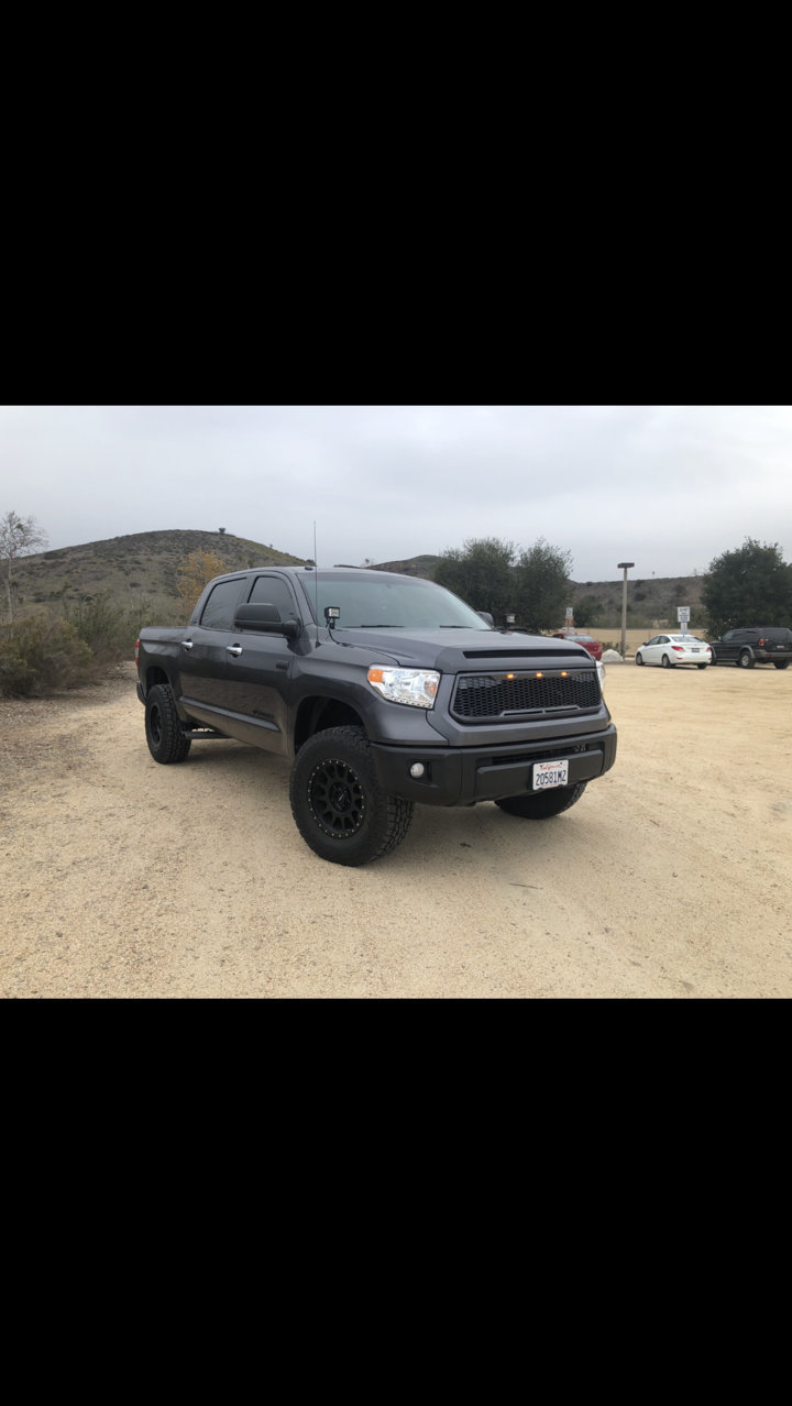

    That is a crazy deal for those. I have 295/70/18 toyo at 2s.
    By the way this is my trucks sweet spot angle hence why all my pics are this way. :rofl:

    Haha we all have our good side. Nice looking ride. What lift are you running?

    I’m running a Toytec/Eibach 3/1 lift.

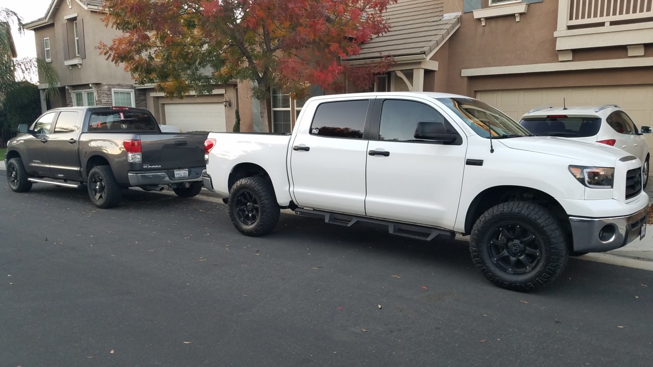

    295/70/18 RGs on 3/1.5

    How much trimming did you have to do?

    Just had to remove mudflaps and push in the fender liner.
