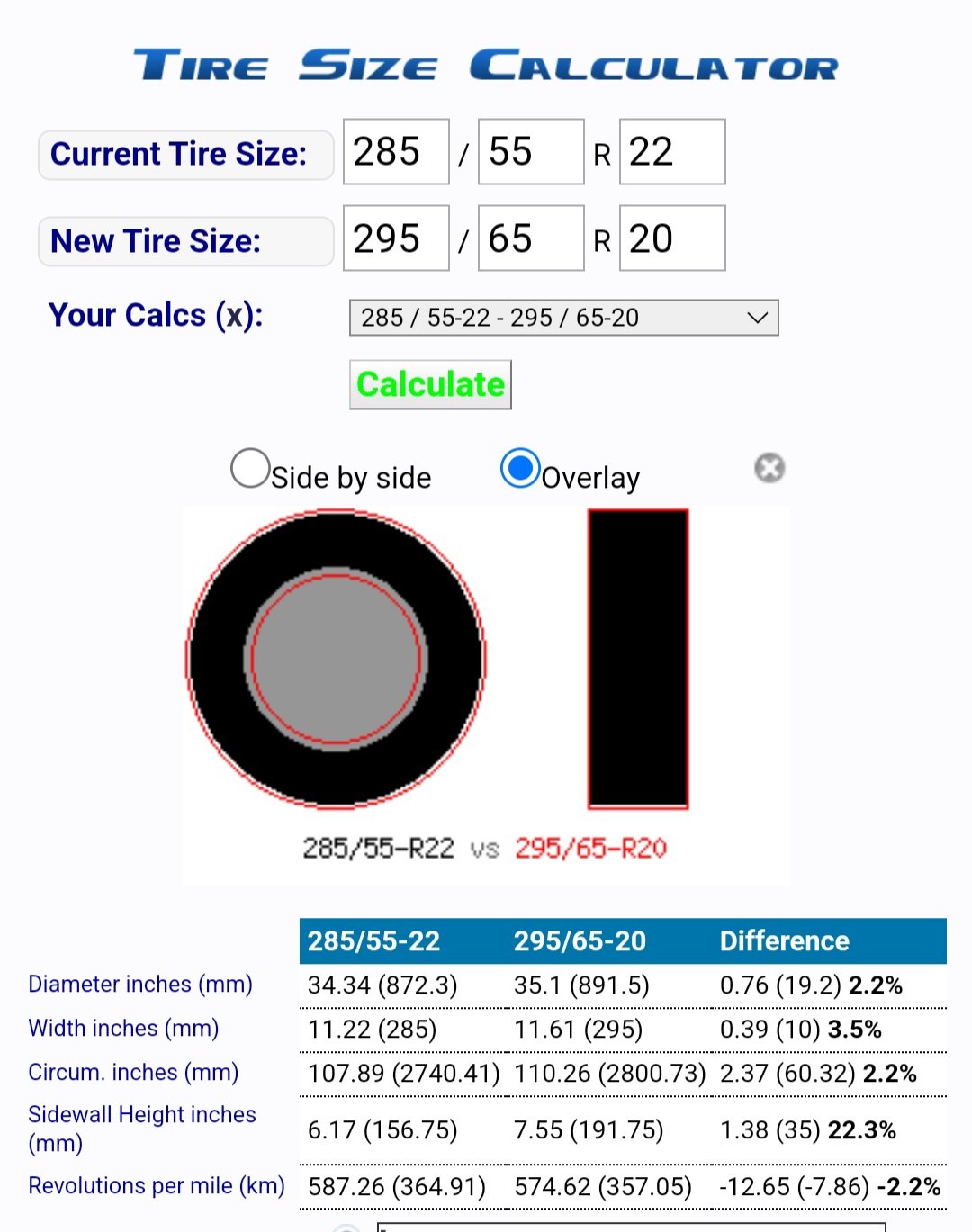

    Here's a chart with what I have and what you'd like to do,I didn't install a lift or spacers and have zero rub full lock on L&R my factory rims have a plus 27 off set I'm nit sure what your rims have for an off set.
