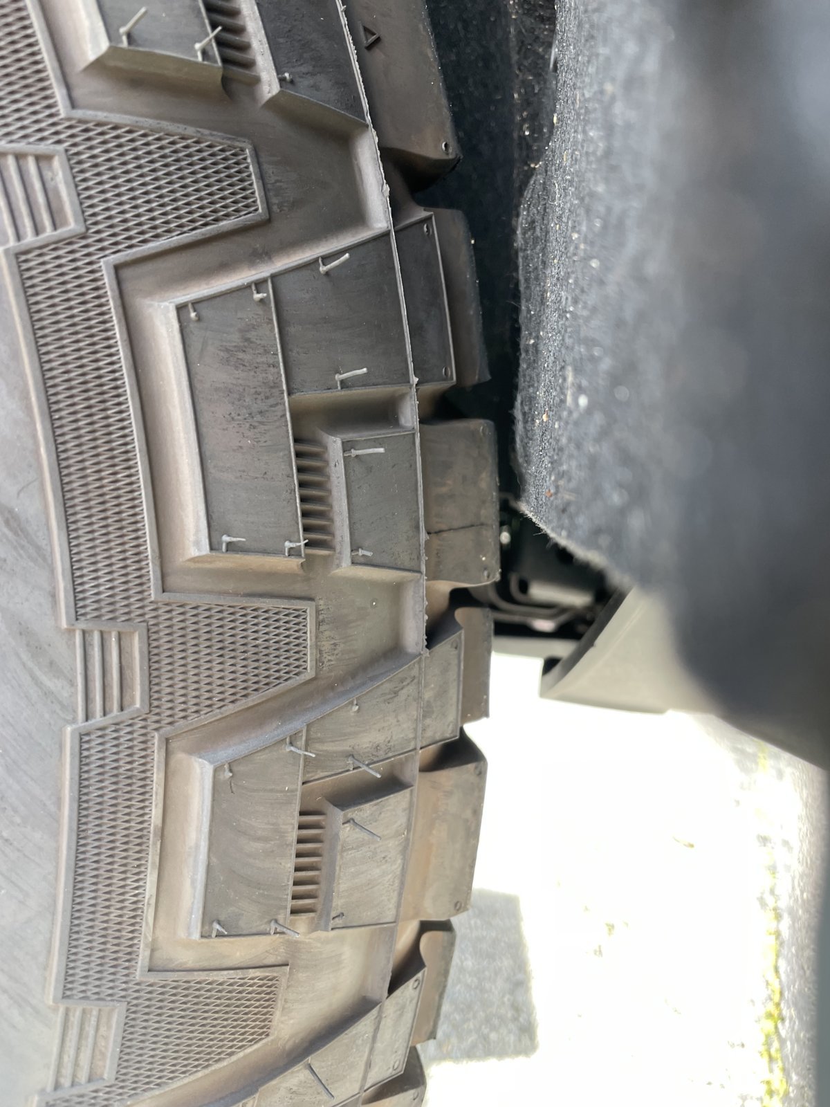

    Thanks! If I’m in full articulation going faster and hitting a bump, I might. Everything is good. Here are some photos reversing on an incline.
    Front liner
    Body mount side

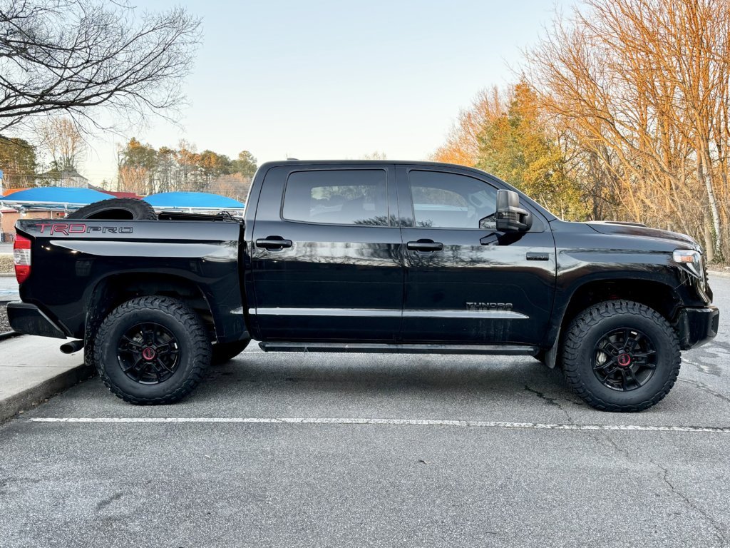

    RAS Road-Active Suspension System HD. 2" (estimated) Spacer and Block Lift . S&B CAI - closed VLED Footwell lighting MESO Customs Interior Lighting 285/65/18 KO2 Gator Hard Cover Tri-Fold AJT Designs interior trim CSU 9 - year ceramic coating Rigid Amber Fog Covers Full Tint (70% Windshield) 20% all others.
    285/75r18
    BFG KO3
    2” spacer lift
    upgraded from 285/65r18 KO2

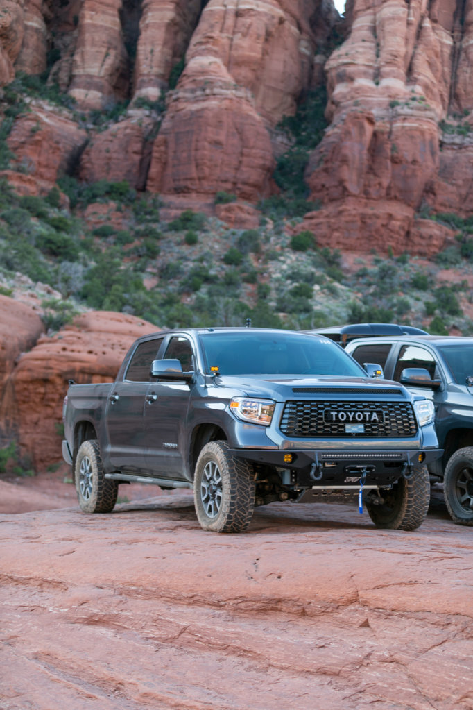

    Not a Pro but 2” of lift up front and an extended shackle in back.
    285/70 18
    285/75 18
