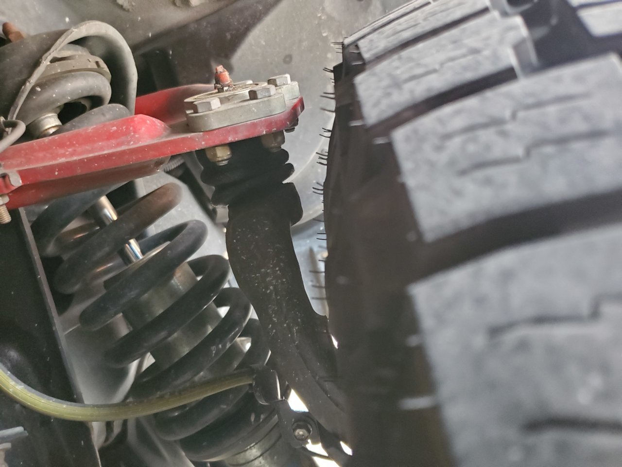

    Since UCA clearance came up earlier, I took a photo of mine.
    285/75/18 Toyo AT3, +60mm BBS TRD Pro wheels, JBA UCA

    Here is the simple explanation about offsets. Mine is a 0 offset. I have an aftermarket bumper as well. The 285/75 won't fit on mine with that offset due to how close the tire is to rubbing the body mount on the back side of the wheel well.
