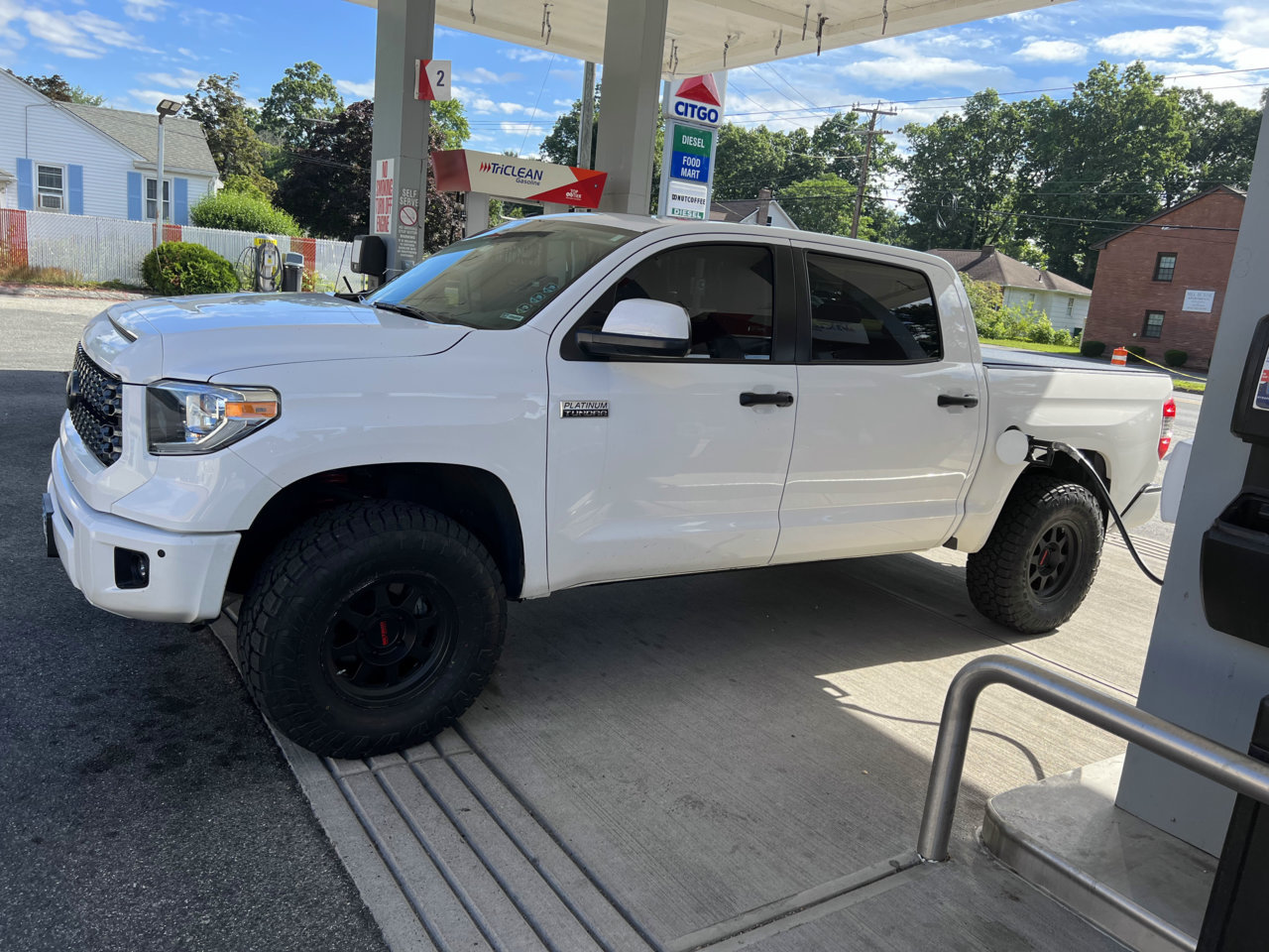

    I’d look into the CB bumper shims or aftermarket bumper. Also depends on the tire… I’ve seen some in here run duratracs in this size with no spacers or trimming
  2. Dec 19, 2022 at 9:22 AM
    #92
    bmw345
    bmw345 New Member
    Jan 24, 2022
    #73610
    339
    CT
    2018 Platinum Pro, Pro Fox's TRD Skid
    Already running the CB bumper shims. Plus everything was pushed forward a solid inch by relocating the holes. Still get a slight rub when backing up. Hoping going from 35's on 0 offset 17's to plus 18 offset 18's with 285/75/18's solves that!
    COTundra23[QUOTED] likes this.
  3. Dec 19, 2022 at 9:26 AM
    #93
    bmw345
    bmw345 New Member
    Jan 24, 2022
    #73610
    339
    CT
    You can see the bumper shims in this pic

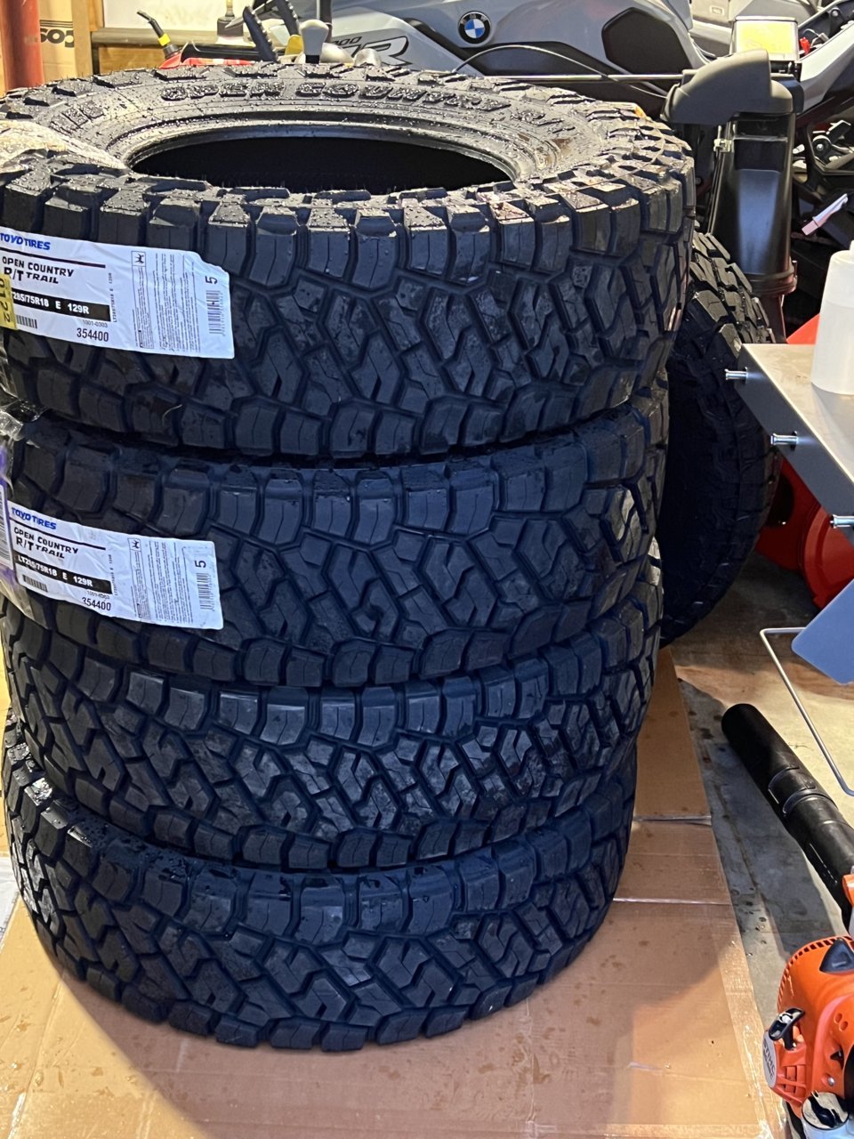

    I am currently running 0 offset 17’s with 35x12.5. Got some plus 18’s 18” wheels and I just ordered 285/75/18. Already running a bumper spacer so hopefully that alleviates the rub! Nice truck BTW!

  13. Dec 22, 2022 at 9:31 AM
    #103
    bmw345
    bmw345 New Member
    Jan 24, 2022
    #73610
    339
    CT
    Thanks, I hope so, I went with 285/75/18 Toyo Open country RT trail's. Website says they are 34.8. We will see!
    COTundra23 likes this.

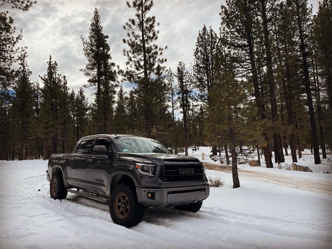

  16. Dec 26, 2022 at 8:21 PM
    #106
    Cue_32
    Cue_32 New Member
    Nov 18, 2018
    #21847
    28
    Don
    TRD Off Road
    Hope you guys can help. I have a levelled (2.25" front, stock read) 2018 OffRoad running stock 18" rims. Was set on pulling the trigger on 285\70R18 Nitto Ridge Grapplers, but then I saw this thread. Any suggestion on what size would fit best without rubbing?
  17. Dec 26, 2022 at 8:55 PM
    #107
    Terndrerrr
    Terndrerrr 923000 miles to go
    Jul 8, 2019
    #32965
    6,215
    Music City
    6UR-FE
    285/70R18 will fit fine. 285/75R18 will work as well, and you have more options in that size. That’s what I run with a 2” level. I get minimal rubbing when off-camber off-road. 295/70R18 clears the OEM UCAs as well, but just barely.
    SnowLizard and Cue_32[QUOTED] like this.

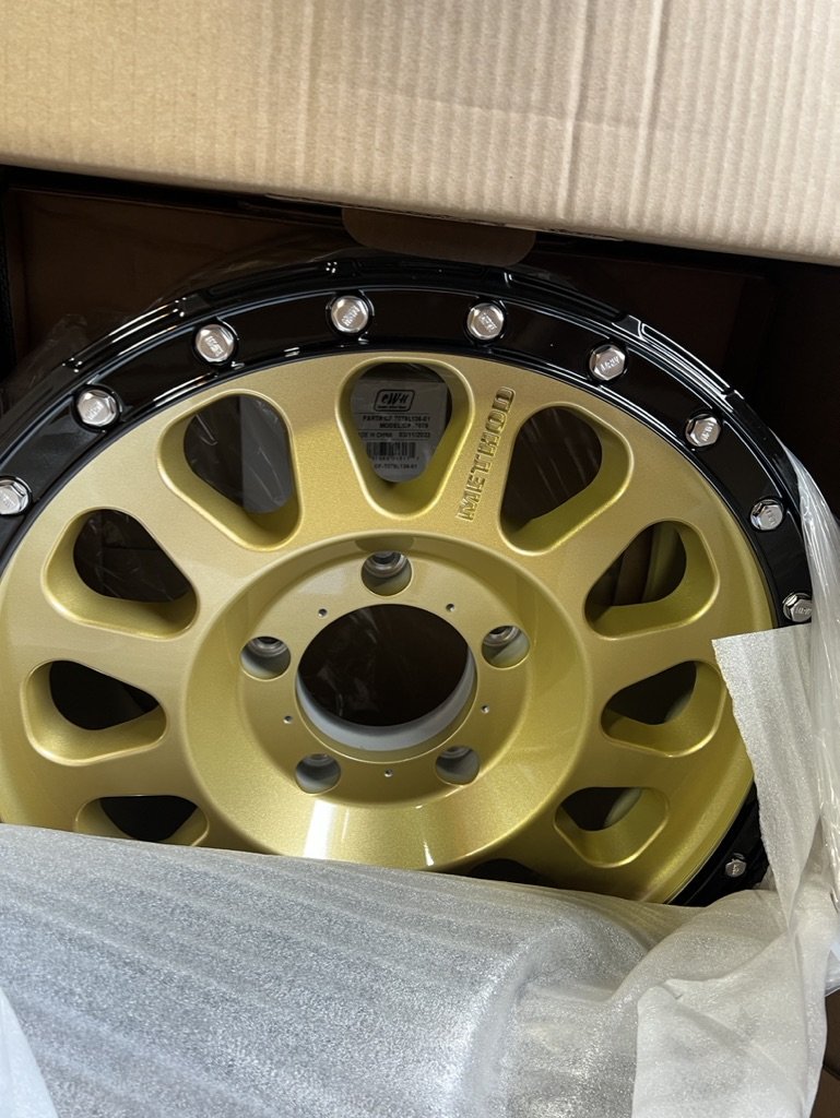

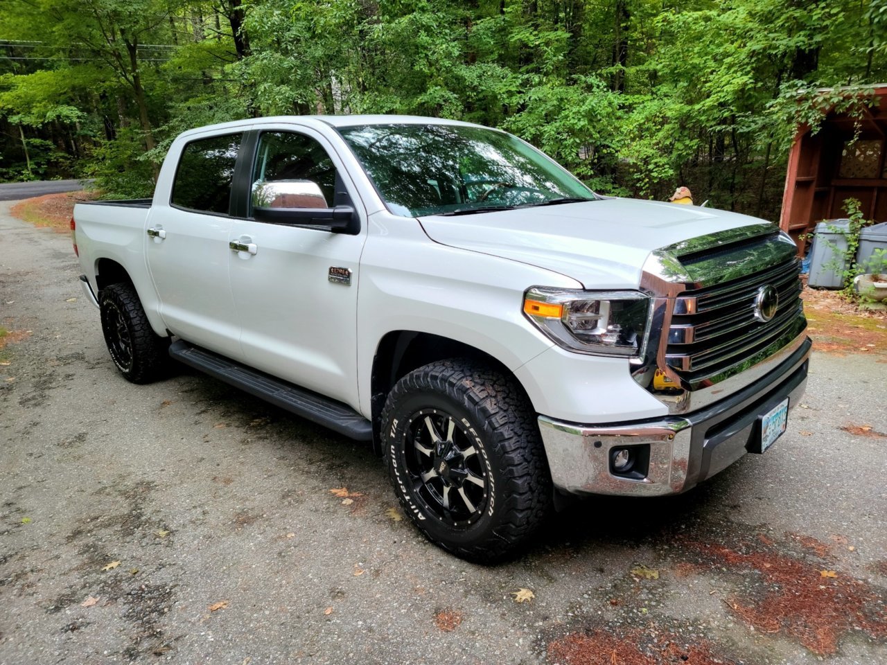

  18. Jan 7, 2023 at 6:34 AM
    #108
    bmw345
    bmw345 New Member
    Jan 24, 2022
    #73610
    339
    CT
    I am currently on 35x12.5x17 on 0 offset Method 701's. I couldn't pass up on a deal from Method for some closeout 18's and I just got my 285/75/18's so this set up will be going on in the spring.

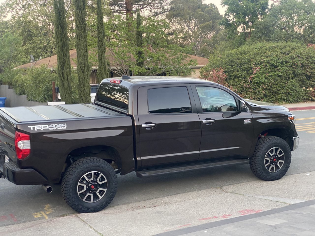

  30. Apr 28, 2023 at 12:17 PM
    #120
    TeaRD
    TeaRD New Member
    Mar 27, 2023
    #94535
    41
    S.F. Bay Area
    2020 Crewmax 4x4 1794 Edition
    Ironman FCP 3/2 Lift | JBA UCAs | Spidertrax 1.25" spacers | 285/75/18 Toyo RT Trails | F/R SwayBar delete
    Thanks for all the info and pics in this thread. Chose the 285 75 18 size over the 35 12.5 and I think It looks good.
