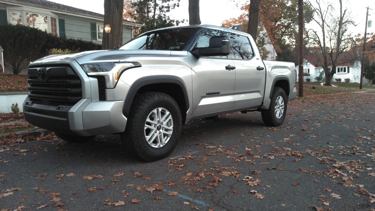

    Just installed 285 75 r18 Toyo Open Country A/T3s on stock suspension and stock sr5 wheels. My truck didn't come with mudflaps. No rubbing anywhere.

    How much distance do you have between the tire and the upper control arm? wondering if 305/70r18 will fit or rub on the UCAs

    It would definitely be model dependant if a 305 width would work. I can fit my hand between the tread and edge of UCA, so the extra 10mm MAY clear if the inside sidewall lugs are not terribly aggressive.
