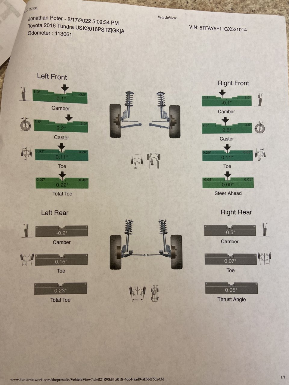

    Im sitting on these alignment numbers… looks pretty good to me on the stock UCA’s. Still gonna do SPC’s soon though.

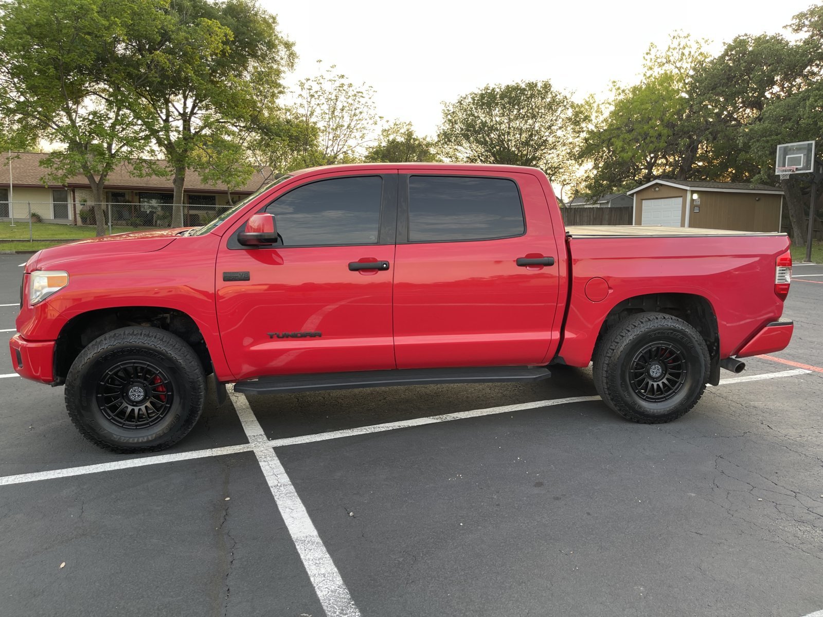

    Icon 17" bronze rebounds with 285/75r17 toyo at3s. Toytec eibach kit with JBA UCAs. I trimmed the skid plate and removed the front mud flaps just in case prior to install. No rubbing. Love the setup.

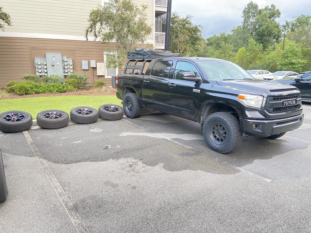

    Method 316, 285x75r17 toyoAT3, OME Nitrocharger front/rear

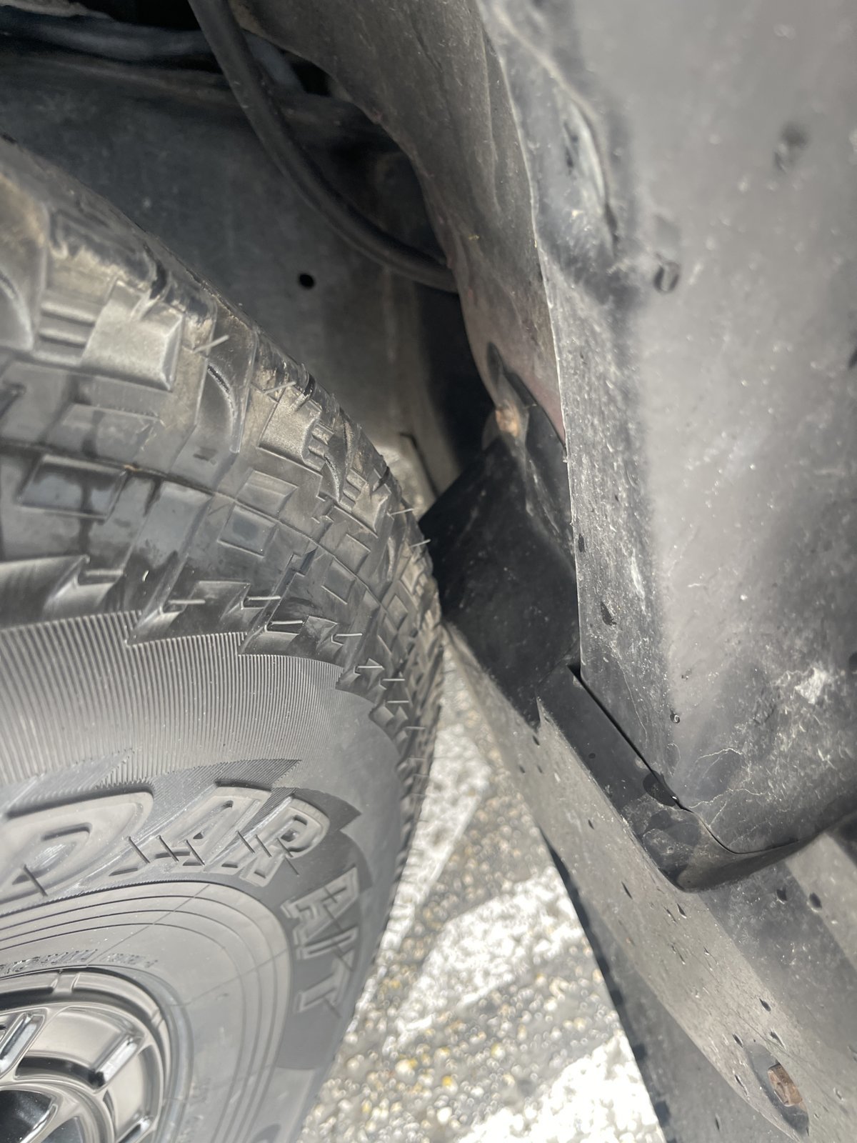

    Mine are running on 285/75R17 Yokohoma Geloander AT G015 with Method 314 on +25MM offset. Have RCI skid plate. Has rubbing with full turn on the back mudflaps but will probably remove or install aftermarket mudflaps. I did remove the front mudflaps. Discount Tire had them on 45 PSI but adjusted between 35-40 PSI rides better for me. Has Bilstein 5100 front and back on the highest setting.

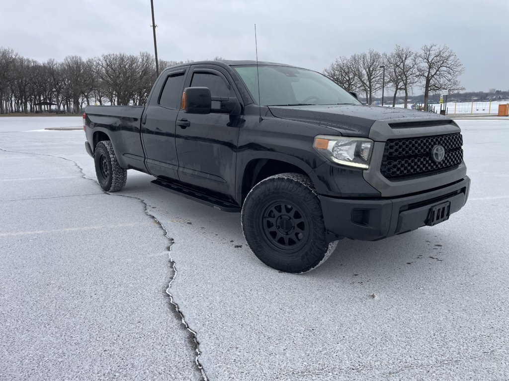

    I threw on the combo you quoted and it works great. Had to remove the front air deflectors on the front wheel wells and push that area in about an inch with a heat gun, but no rubbing now. Took maybe 20 minutes with the gun and checking by myself. Pic has the deflectors on but gives an idea

    Awesome, thanks for the reply. Truck looks great. I am trying to decide between 255/80/r17 e rated or 285/75/r17 which have a c rated option. I'd prefer the pizza cutters for gas mileage and snow performance but I'm nervous about ride quality with the e rating.
