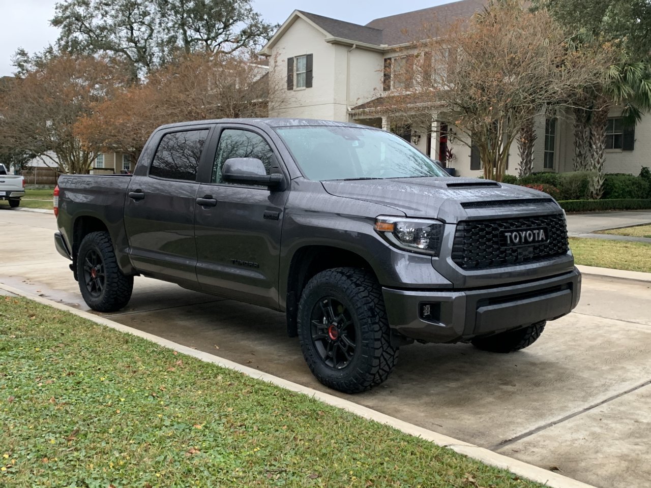

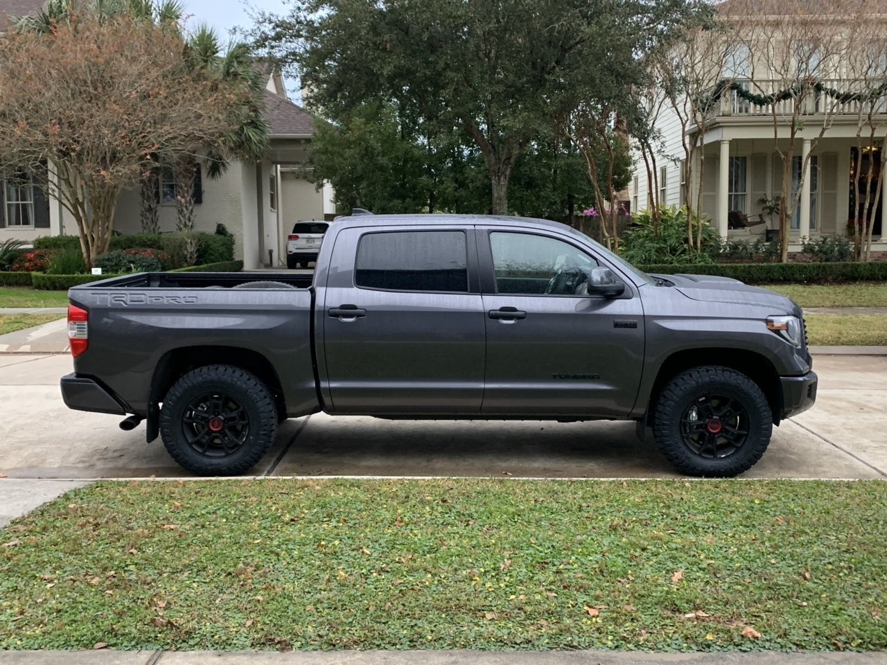

    Put on 285/70r18 Nitto Ridge Grapplers yesterday. 34 x 11.5 in. No rubbing at full lock forward or reverse. Stock TRD Pro suspension and rims. No trimming and all madflaps remain in place. Only difference that I can tell is that they’re a little louder at interstate speeds. No mileage data yet. Very happy with them so far.

    Love the green!! Did you swap out front suspension? You mention pro but truck has OR package so just clarifying for my future plans
