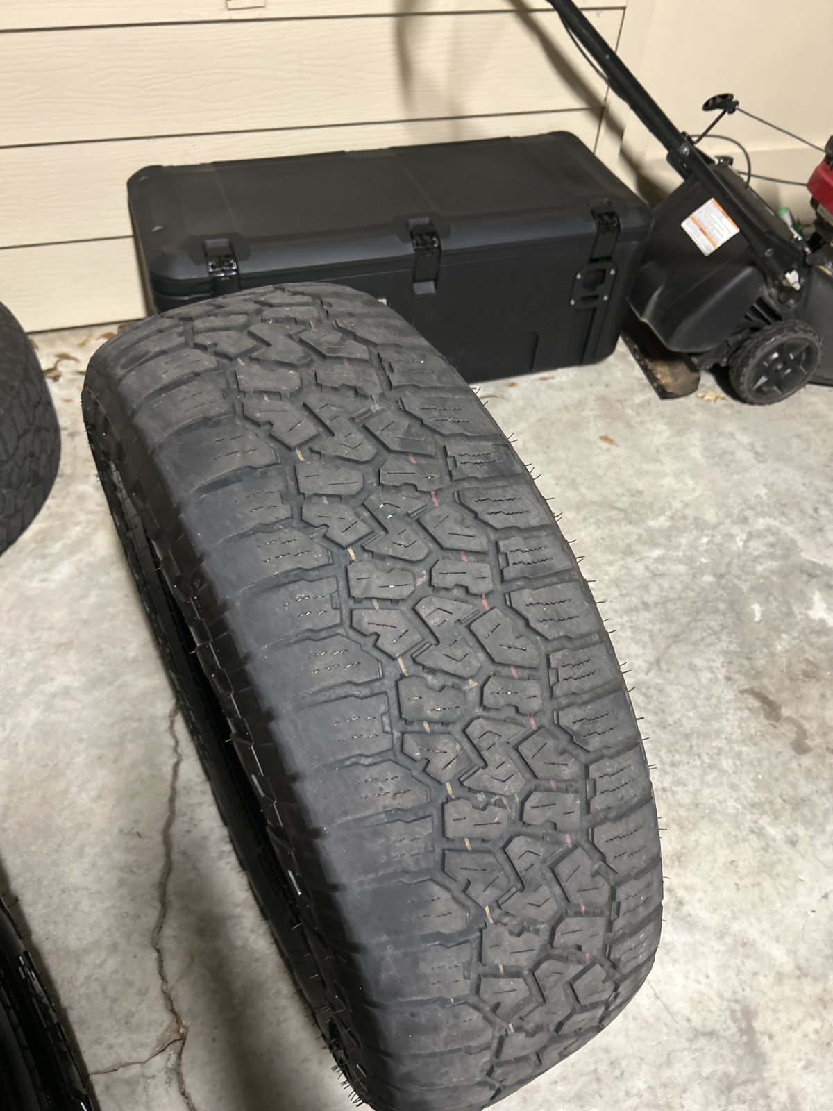

    I had a different experience - I bought new 295/70r18s this week, to replace the stock tires on my 2023 tundra trd pro. When discount tire tried doing the alignment, they said the specs did not come up on the computer for my vin, so they would not be able to complete. Told me I should take to dealership for proper alignment. This makes sense now due to the discrepancy in the alignment numbers that Toyota has/had wrong.
    I have about 8k on the stock tires and brought them home with me vs disposal. Tonight after learning about this alignment issue for the first time, went outside to check my tires - (will post a picture) I can already see a tread issue with the front outside tires.
    I guess I will have to take a trip to dealership to get a proper alignment. Not sure if I can do anything about the damage that was done to my original tires due to this issue or not? Does anyone have the correct specs as maybe when I get to dealership they have no idea about.

    I have a 2023 Pro that just hit 5K miles, same issue on front tires. Local dealer is not aware of a problem with alignment on pros but granted I am in a small town and there are not many on the road here.
    My question is for the people who have upgraded to a 35" tire, or a tire other than the factory wildpeaks: Are you noticing uneven wear in the front on the new tires? From all the research I am doing, it seems like these factory wildpeaks are just crap tires. I haven't seen anyone who has upgraded their tire complain of the wear problem yet.

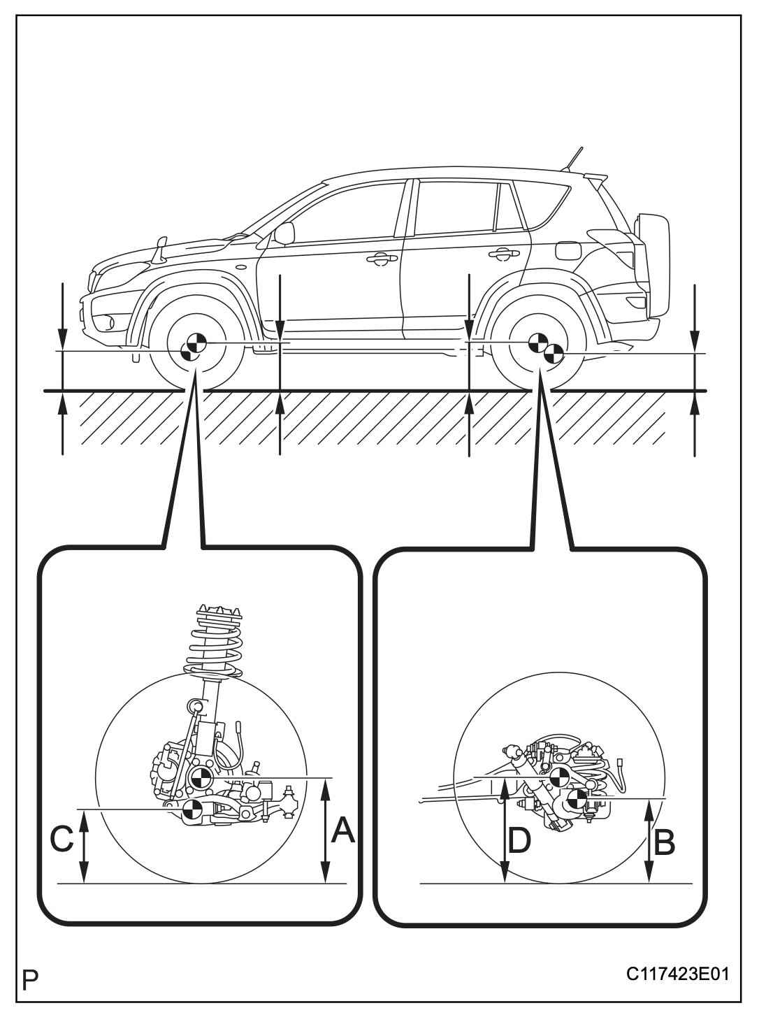

    Everyone with an alignment issue should take this PDF with them to the dealership. As you can see, alignment specs vary depending on vehicle ride height. There is not a one-size-fits-all spec.

    TRD-Pro:
    FRONT VEHICLE HEIGHT
    14 mm (0.55 in.) 19 mm (0.75 in.) 24 mm (0.94 in.)
    Thought all Pro's were the same, yet give 3 diff heights ?

    I am spent on this issue. Bought a 23 1794 in May. 17k on the truck and I have tires that are simply unsafe to drive. No tread and cupping like above. Corp has been no help and 3 dealers same deal. One dealer offered two new tires. Not sure what else to do but sell it.

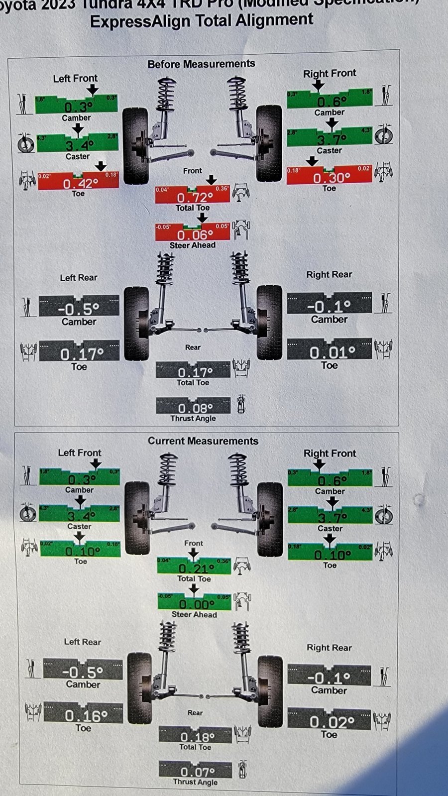

    Yeah, its tough when Toyota is not working on a root cause fix. I as well am spent. Sitting right now at local Off Road shop who are working the alignment now. After Toyota's latest attempt, new front wearing heavy due to excessive camber. TOE appears okay as no cupping on outside.
    Right now at the local reputable Off Road shop who are working the alignment now. Going with TOE not to exceed .1 each side/max combined less the .20. Camber set to as close as zero as possible. I will share final numbers once I have them

    Here are the new alignment specs used today. Huge improvement in steering feel and response

    probably as good as it can get within stock adjustment looks like you had to give up some positive caster hopefully not noticeable but overall handling and mainly tire wear should improve

    Took a 100-mile ride and it does feel much better. Steering is dead center and very responsive. Tracks straight.

    Those are almost exactly where I am at with my realigned PRO and you will be happy with the results. I had more outside tire wear in the first 500 miles then the next 5000 with those specs.
    Everyone, If you have a PRO get the camber to .2 to .4 each side and toe around .10 on each side and you should be good to go. I would highly suggest not going to a dealer for the alignment, find a shop that will get you setup to these custom specs on a Hunter machine.

    Holy crap man, your toe was 1.51 up front total before, no wonder. That's crazy.

    So a stock tundra on stock tires would be 1", and if I get larger tires, then it means less toe

    So for Tundra the alignment shop has to measure A-C? I have a TRD Pro and will get getting larger 285/75 R18 tires as current ones have outside edge wear due to 0.58 alignment.
    I guess my total toe will be close to 0.10 with this
