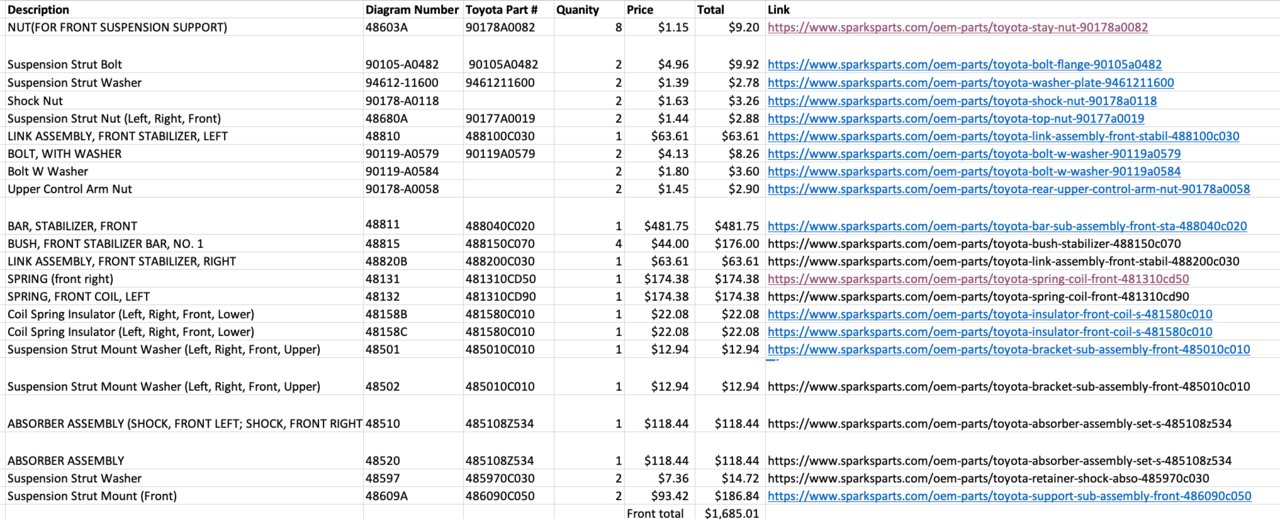

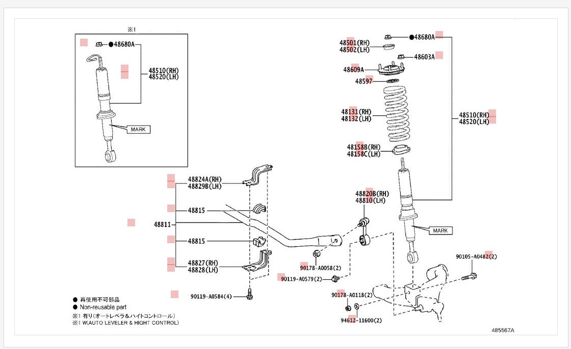

    I started to look at the Toyota parts diagram of the front suspension.
    I searched for "TRD Pro" and found the following parts:
    I"ll reach out to Sparks to try and confirm if these are the actual Fox shocks and the red coil springs -- and what the availability is.
    -c

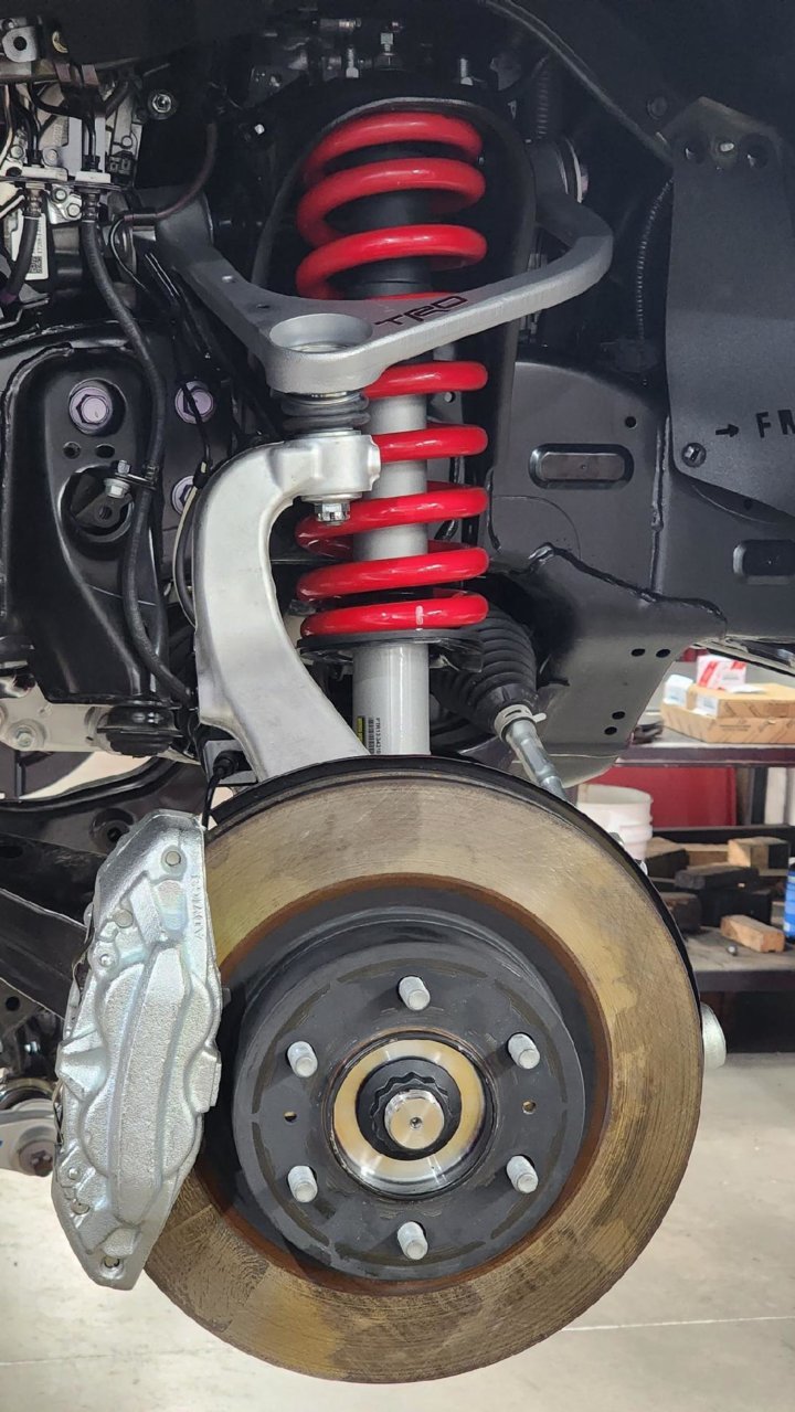

    I talked to the tech doing my install this morning and can tell they were working away on it today (thanks to Toyota app notification).
    I communicated the sway bar / skid plate info and also the fog lights. Tech has a lifted Taco, so completely understood the fog lights and just said I need to sign a waiver when I pick it up - but all good leaving them. Can’t wait to get it back!

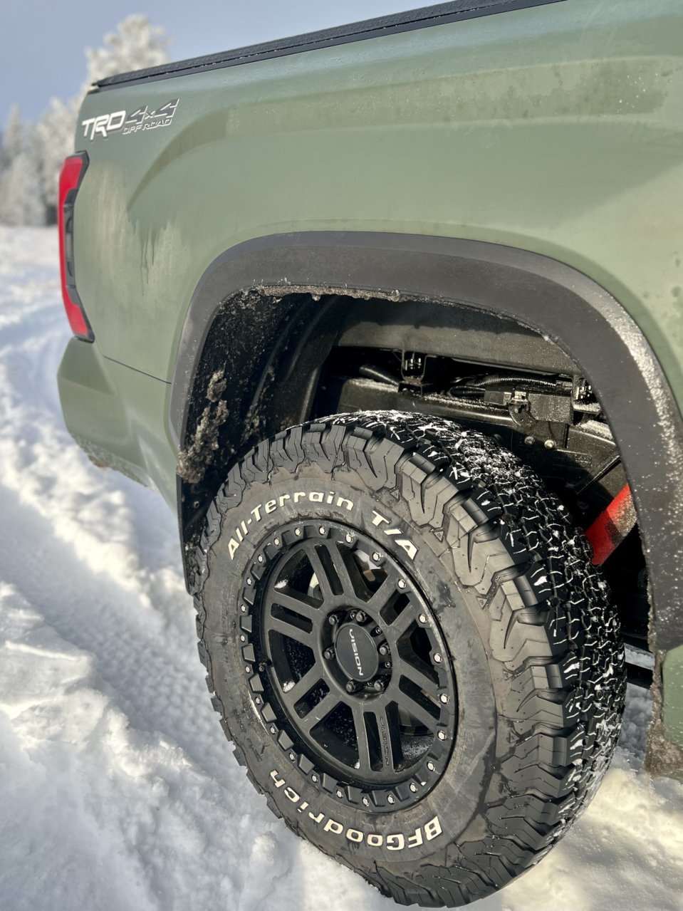

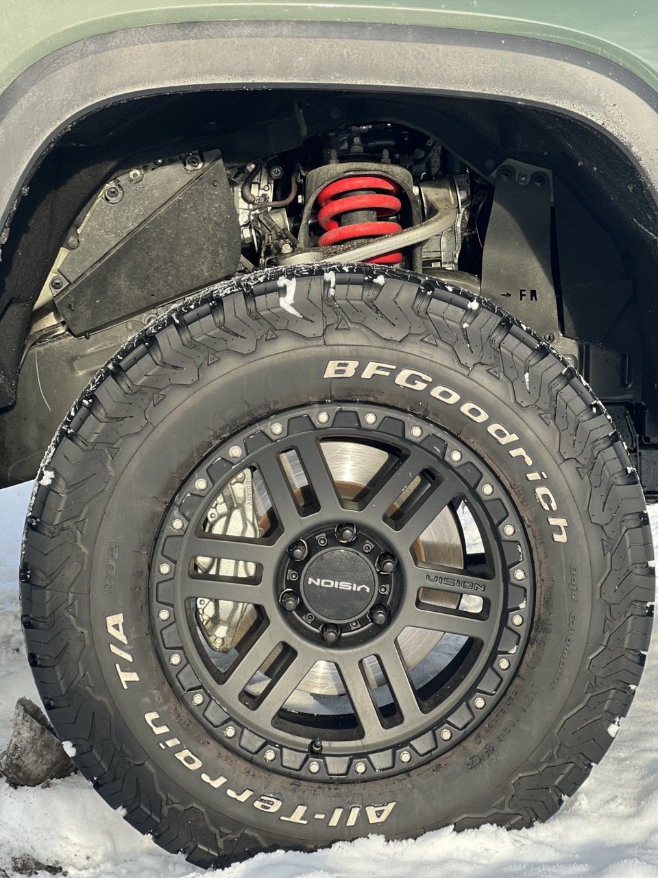

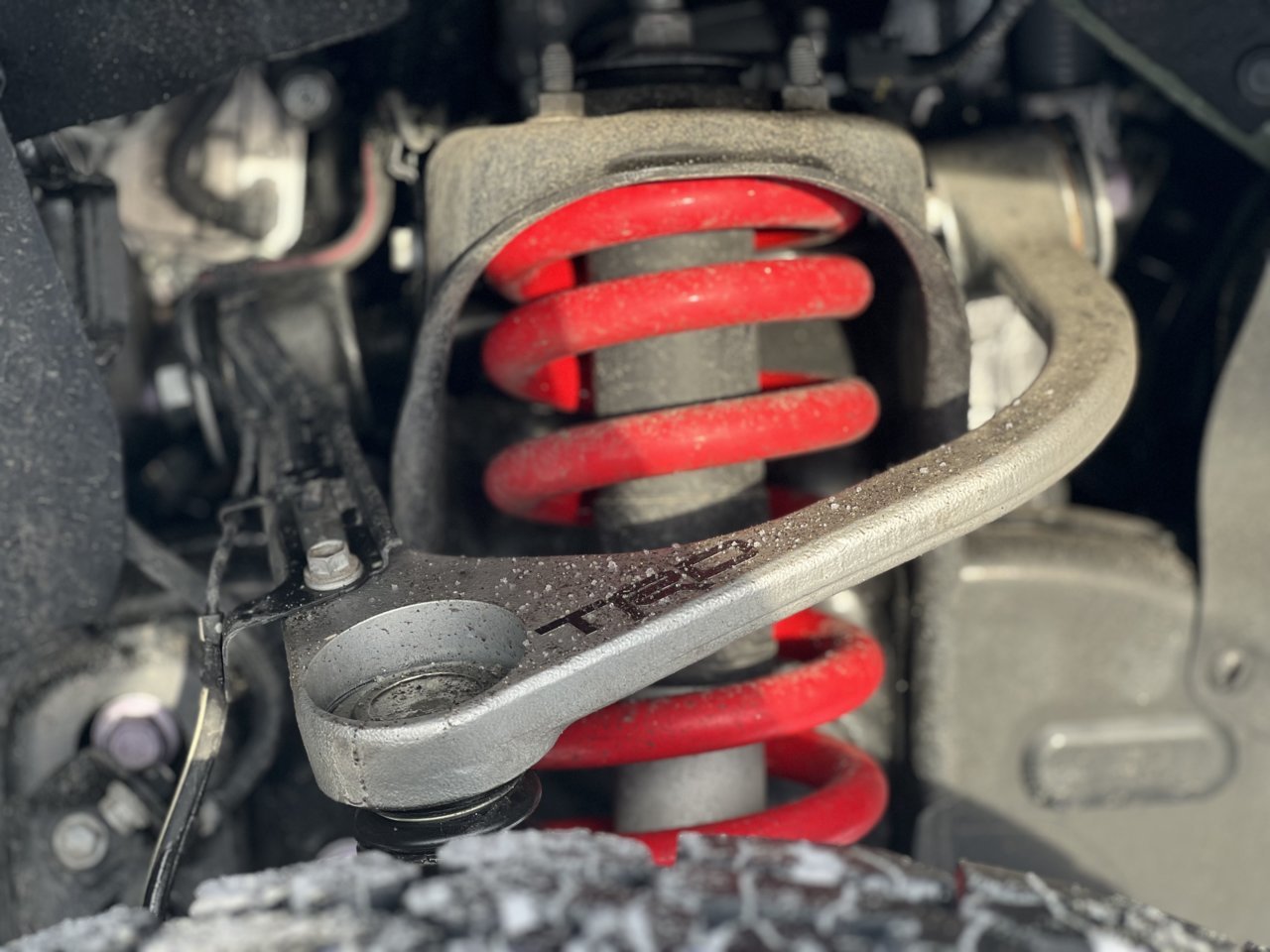

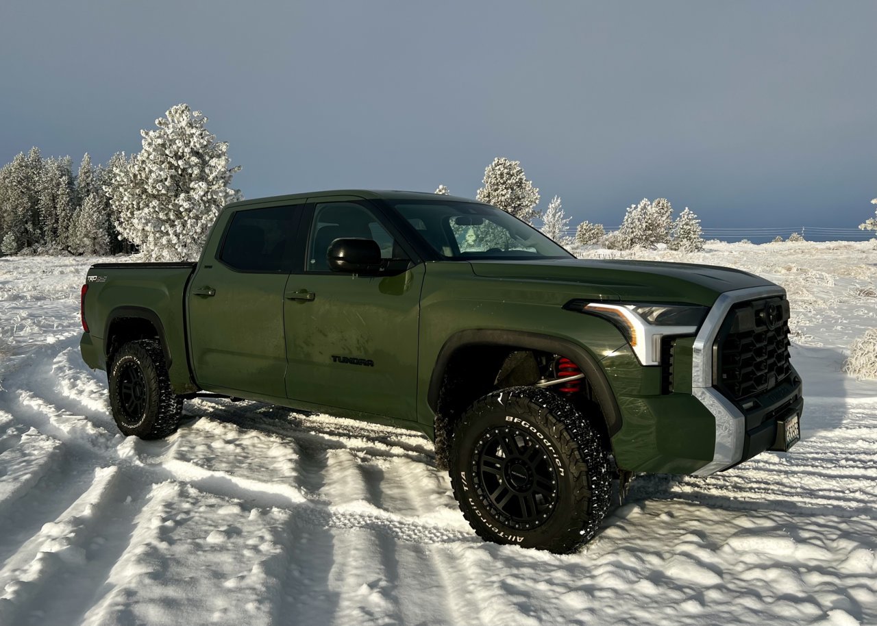

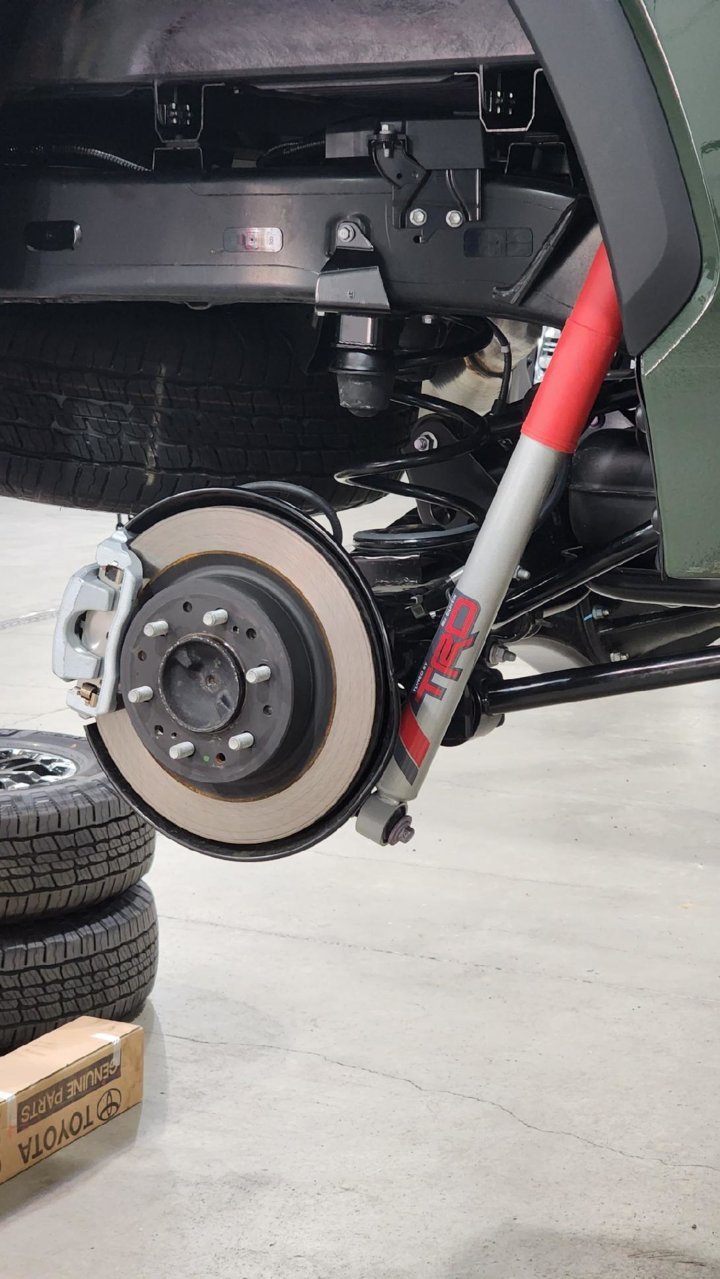

    I have had my TRD lift for a little over a month now. I am loving it so far. I chose to use all the parts and relocate the sway bar. I don’t have the pro skid, just the trd skid plates, so the sway bar doesn’t really bother me, and articulation was more of a priority to me. I had also seen pics from the Sema build and the sway bar link ends were at pretty extreme angles without the drop, not sure if that had changed at all. At some point I am hoping to try an alternative solution and get them behind the skid plate.
    7C71EA7B-301E-4E35-A10D-22B6A3AE3DF7.jpg DA06D555-3E65-45BC-8290-AB4DEDA29E84.jpg 583AF0A2-54D8-4062-97CE-9E421C26E669.jpg E56788F1-9E74-4F74-9A34-3480E8B07A29.jpg EF2A3020-DEEA-4330-96AF-1927FB40FF4E.jpg

    Love your tire/rim setup - are those 17" Visions on 35" BFG AT?
