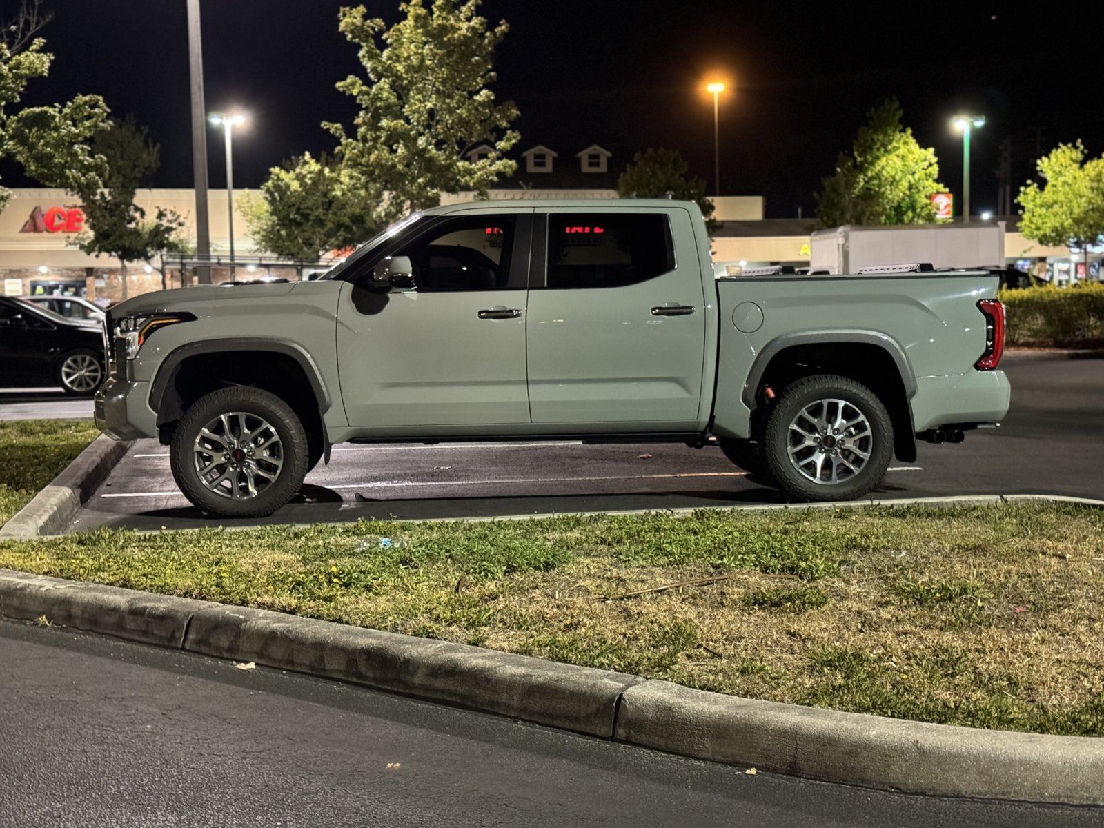

    Looking really good! About to lift my short bed Army Green w same wheels and tires & really like how yours came out.

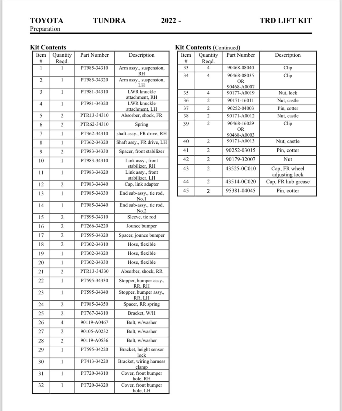

    Is there a post buried in here somewhere that lists all of the part numbers of the various components included in the factory TRD 3" lift? Shocks/struts, UCAs, springs, brackets, etc.? I may look to purchase some of the parts separately and thought it would be handy if there was a list of the part numbers somewhere.

    That is perfect, thank you!

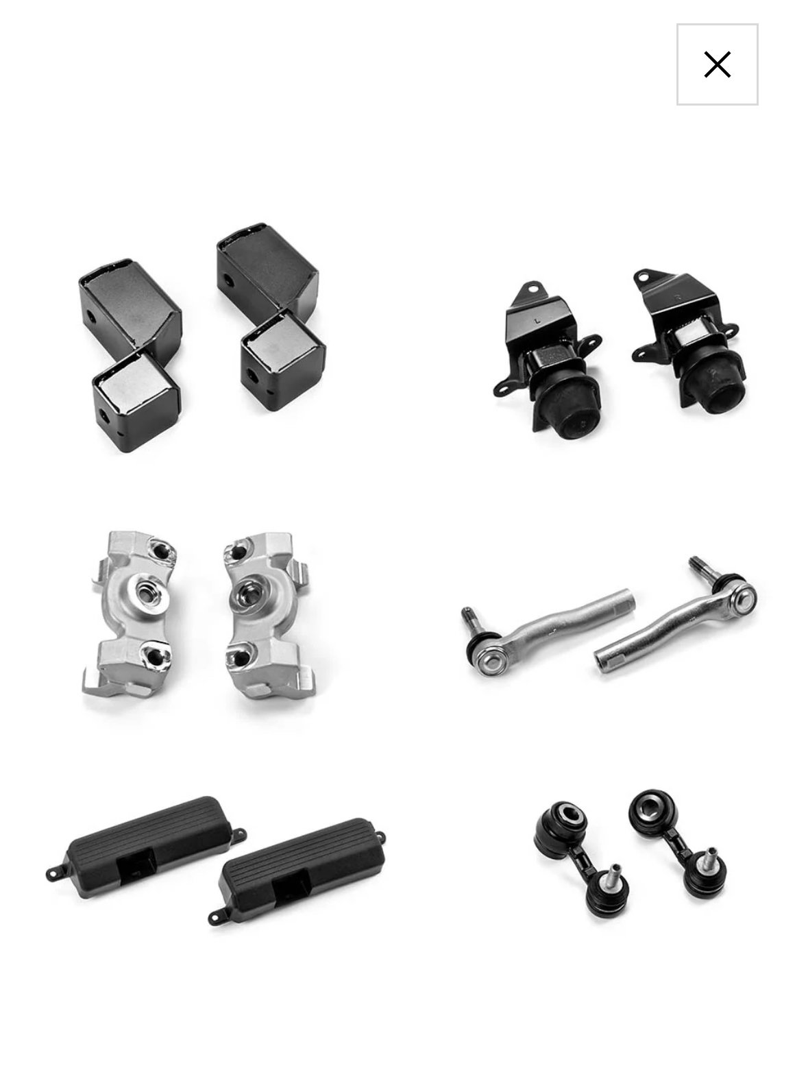

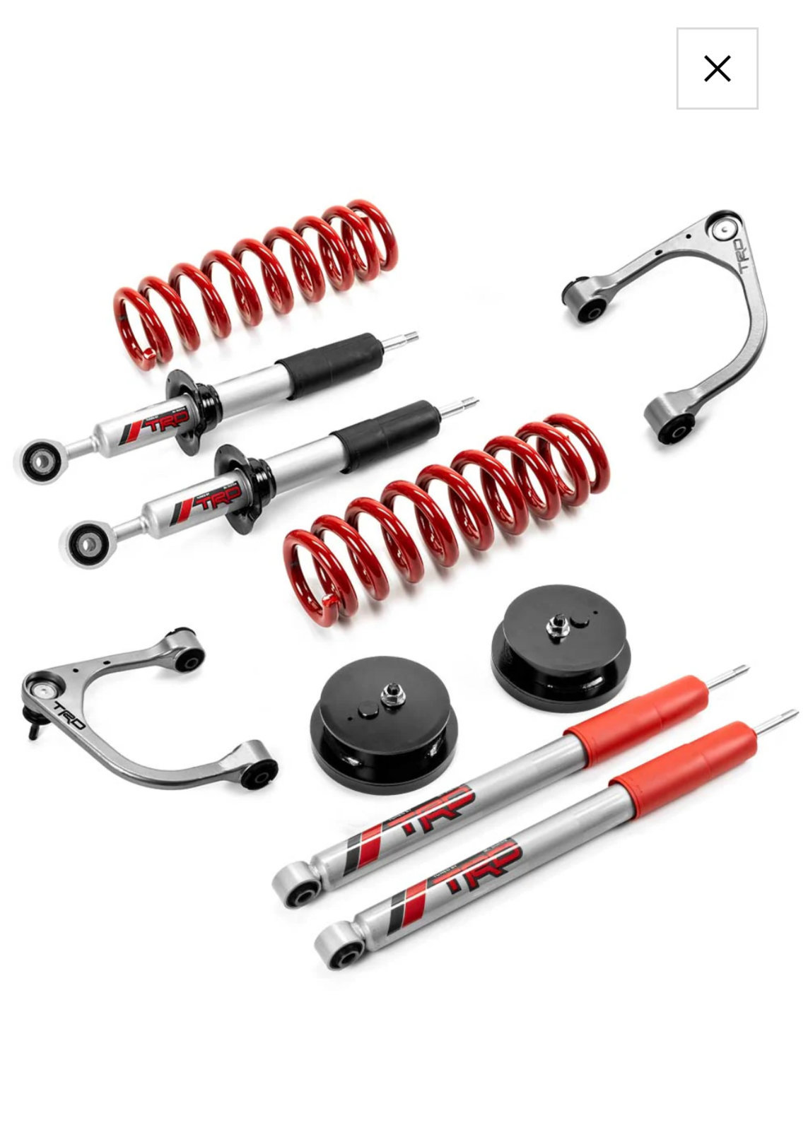

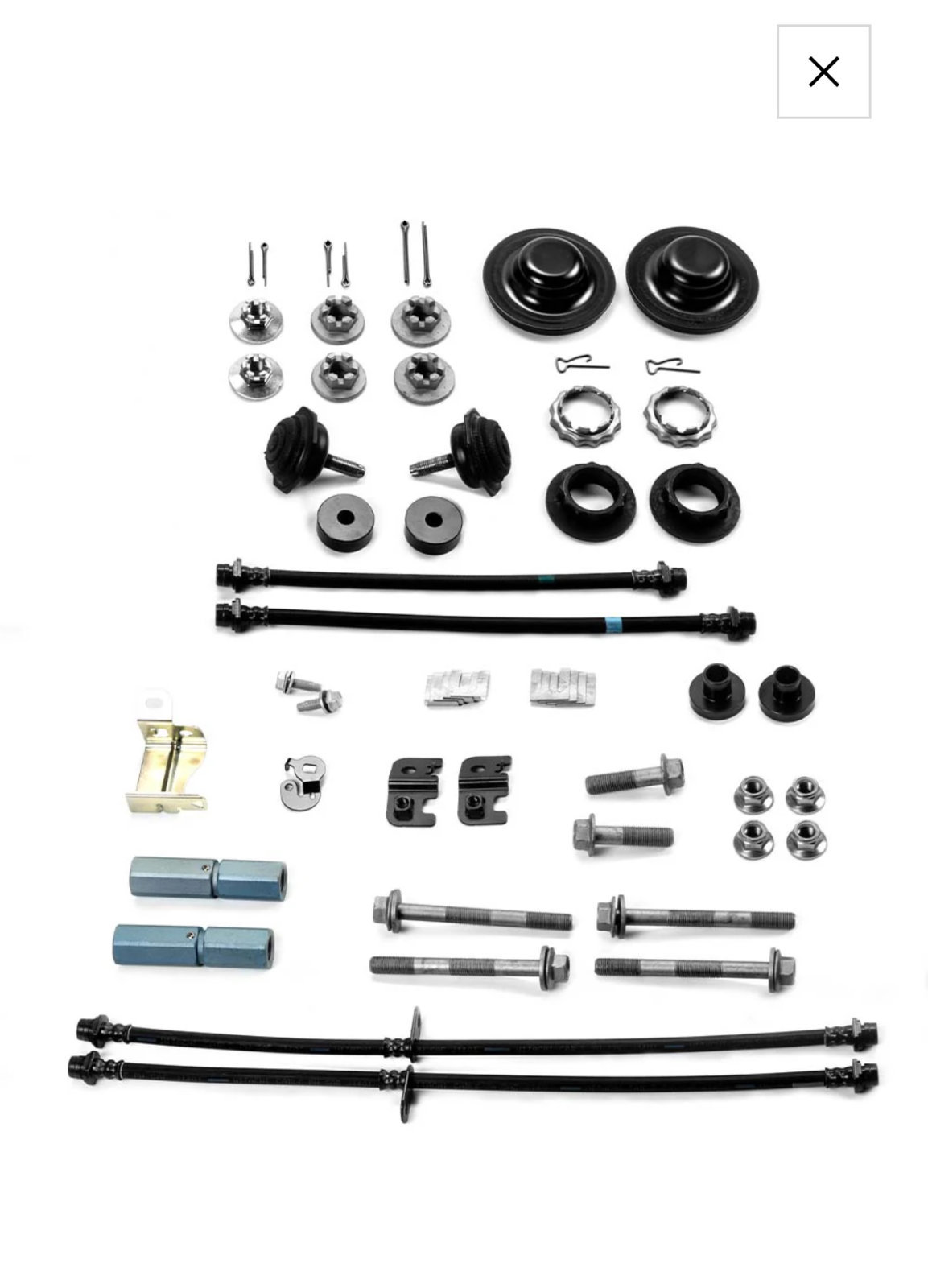

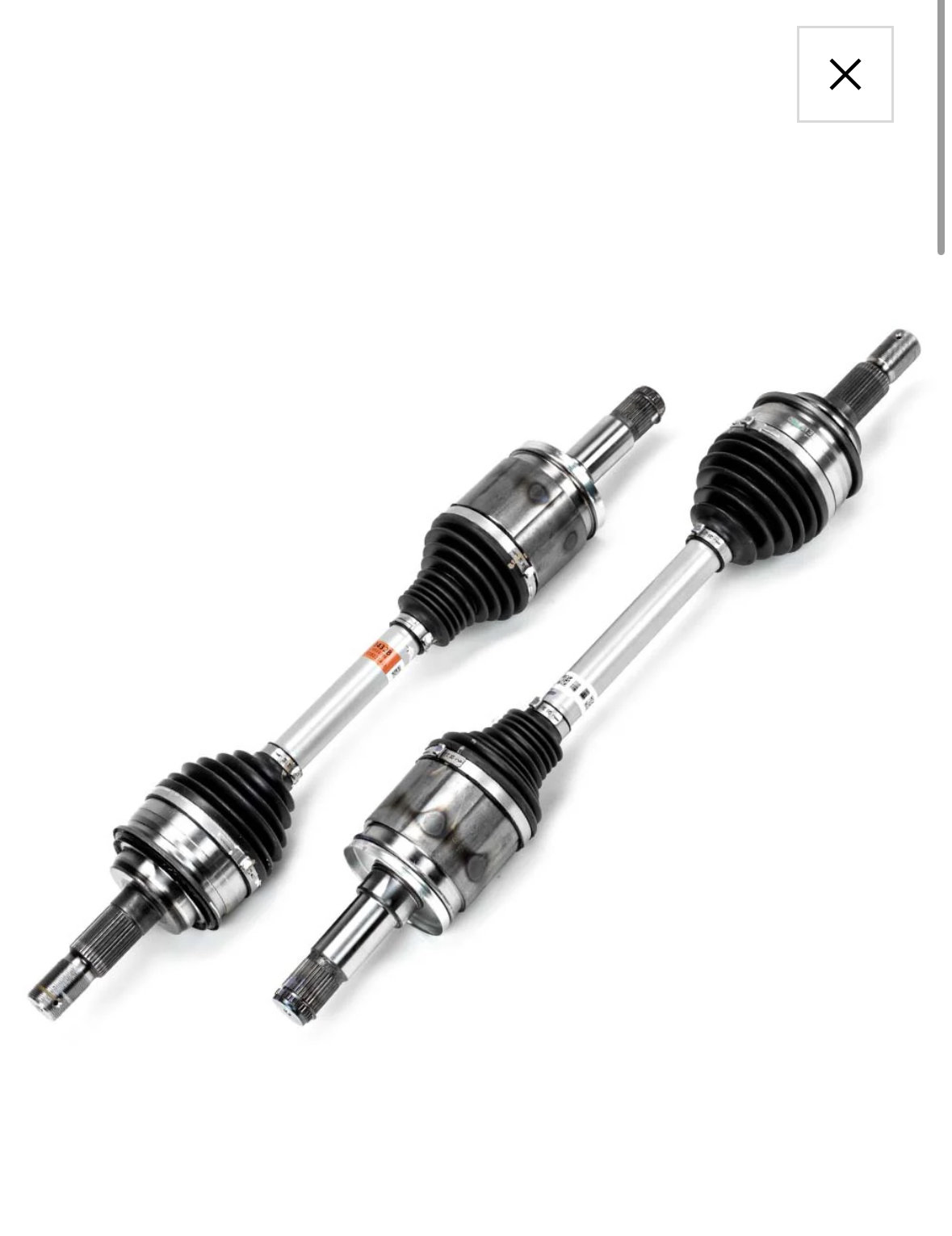

    To take it a step farther - has anyone taken a picture of the entire kit laid out so that we can see all of the parts?

    Here you go

    Wow, thank you, this is all very helpful! You guys are the best.

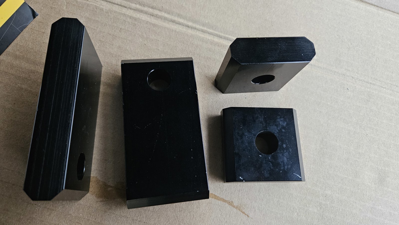

    I have a 2023 Platinum with the factory 3" TRD lift. I am getting a tire rub at full lock with 285/65/20 BFG KO2's. Has anyone installed the below Icon sway bar kit over the factory TRD sway bar drop kit and seen if it solves the rubbing issue?

    Nope. 285’s rub on the sway bar

    Yes, I removed the one Toyota sales and used the icon one and rubbing stopped, 295/65/20

    @machd08 Would you mind posting a pic or two of your rig and the icon spacers installed on the sway bar for us to see?
