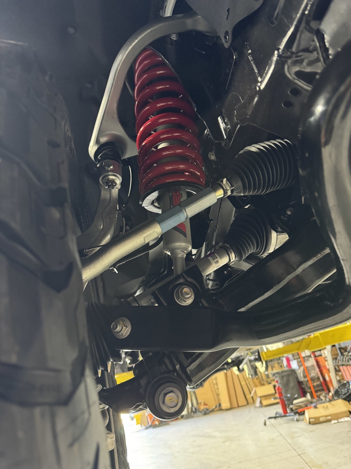

    2023 sr5 dealer installed trd lift at time of purchase. Currently 37,000 miles getting tie rod ends replaced. Luckily under warranty because I made a comment of a noise prior to exceeding 36,000 miles

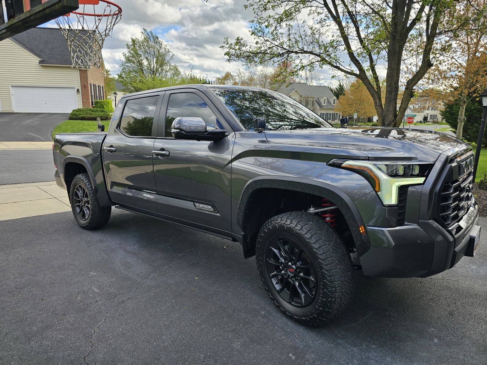

    Got my truck back from the dealer yesterday, Used a different dealer that only charged me $1275 for the install!
    So buying the lift and install total cost was $2775.00
    Still waiting to decide on tires. I'll probably run this setup for a while and keep reading the forum to decide what tires work best for my combination.
    Anyway here she is!
    Hoody and ARCOVT23 like this.

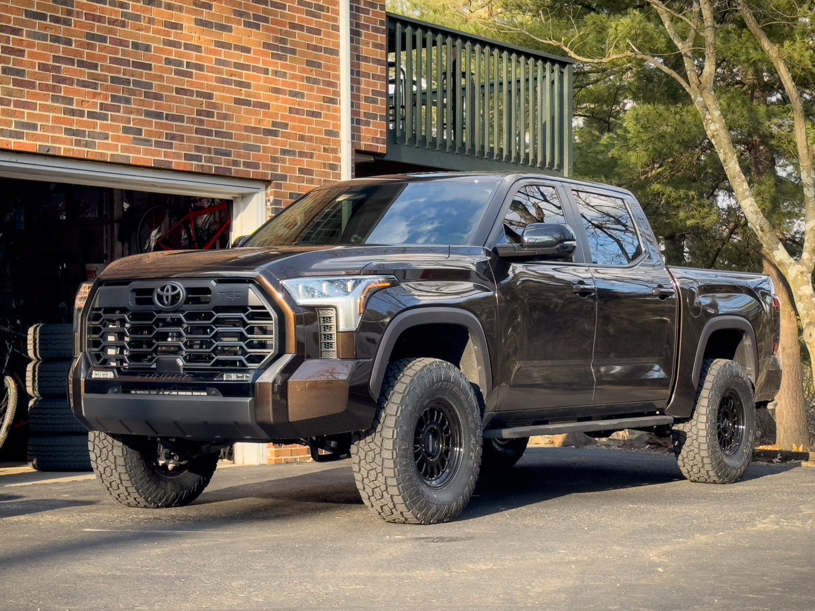

    3 inch TRD lift, TRD Skid plate, RCI Trans/Cat converter skid plate, RCI Bed Rack, Nitto Recon Grapplers, OEM bed mat, BAK Revolver X4S Tonneau, OEM Mudguards, OEM Black Chrome exhaust tip, TRD pro flairs, TRD pro grill, Baja designs light bar, Rigid ditch lights

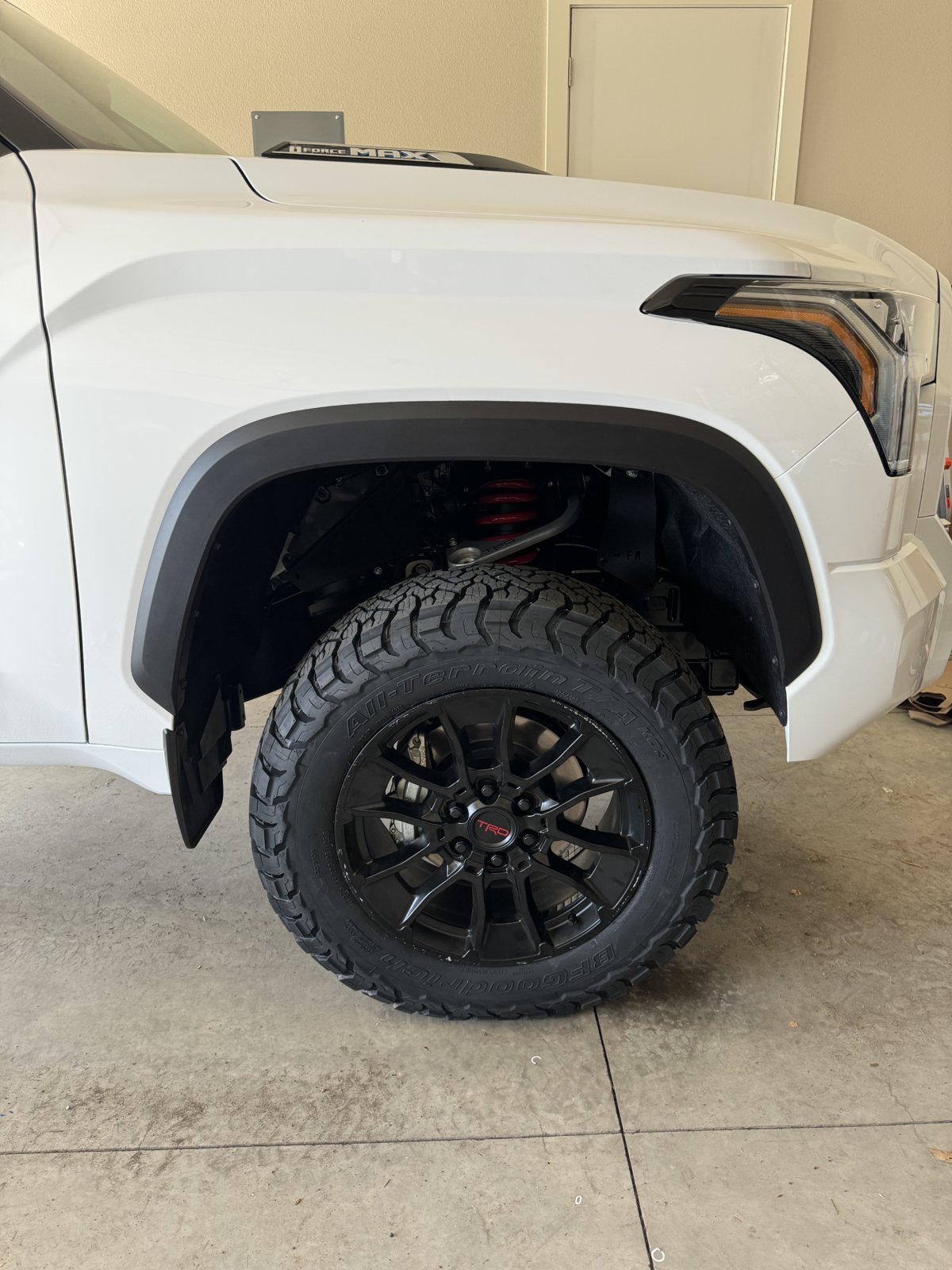

    I just got the 3 inch TRD lift installed with the sway bar drop (TRD skid plate below swaybar) I also picked up a set of the 18inch TRD pro Wheels with the +46 offset from eBay. Can anyone tell me if I can install a set of 35x11.15 18 Falken Wildpeak AT4w's without having a rubbing issue on the swaybar? I read thru the thread and saw 2 trucks had the pro rims but couldn't tell what size tires they were running. I also tried searching for this combination but could not find my answer elsewhere on the forum. Thanks!

    Trd lift rides great. But it’s not super rugged. Sway bar end links and tie rod end already replaced at 35,000 miles. Half of those miles we on stock wheels and tires.

    Hey man! Truck looks great. What tire size and wheel combo did you end up with? No rubbing?

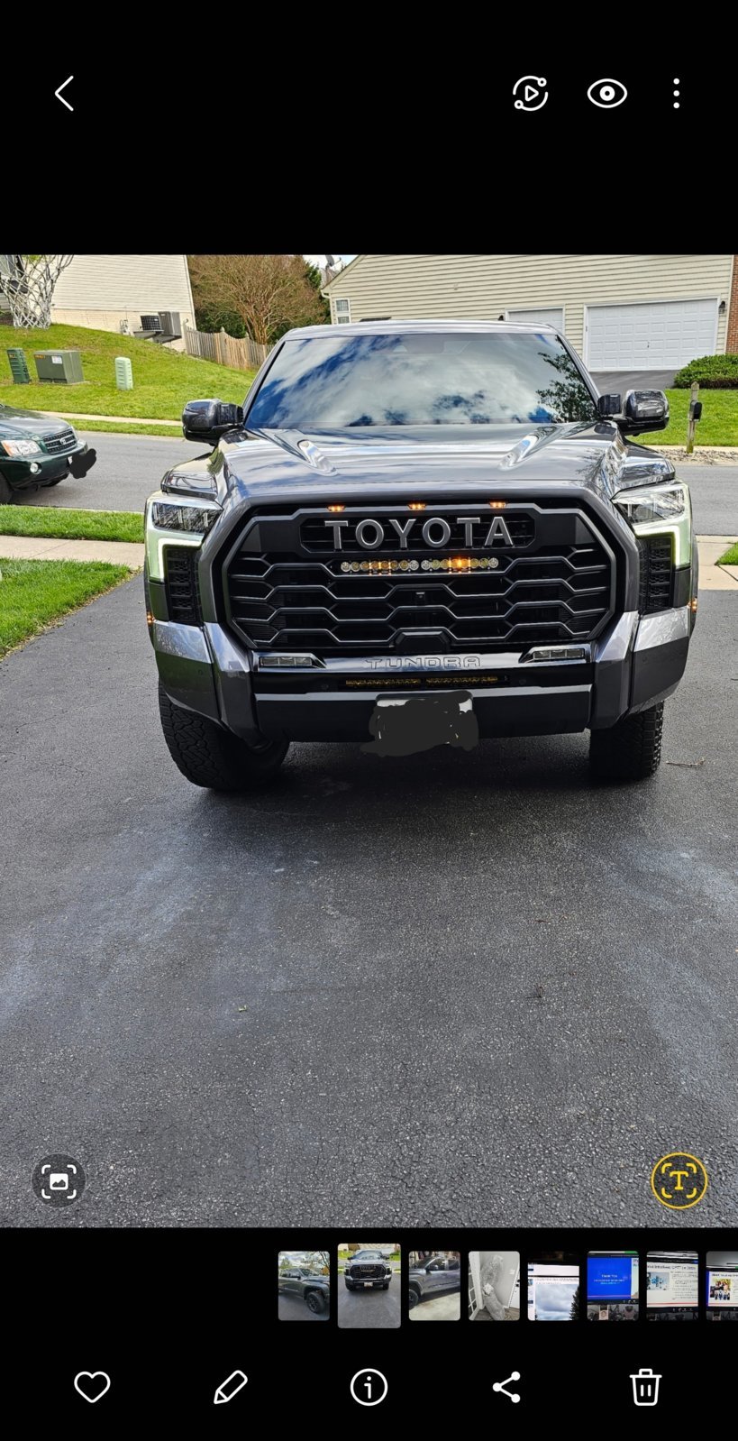

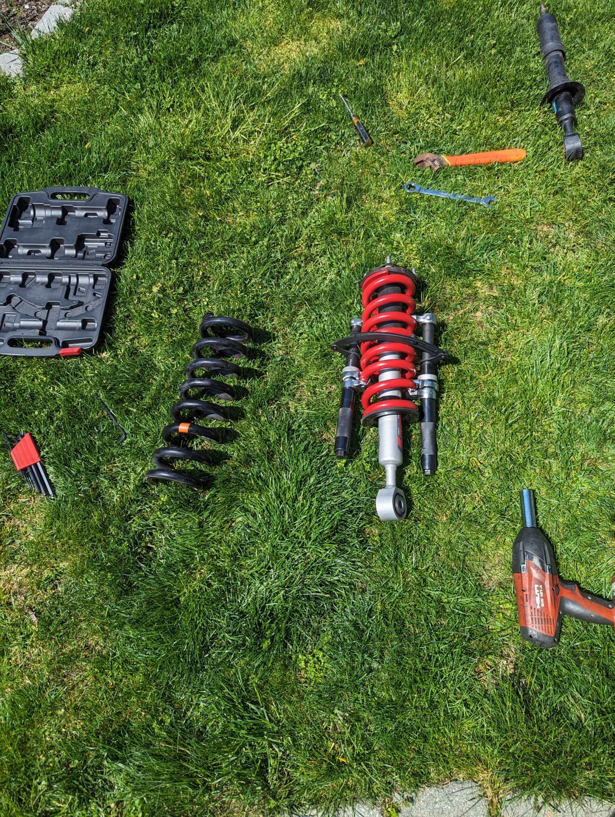

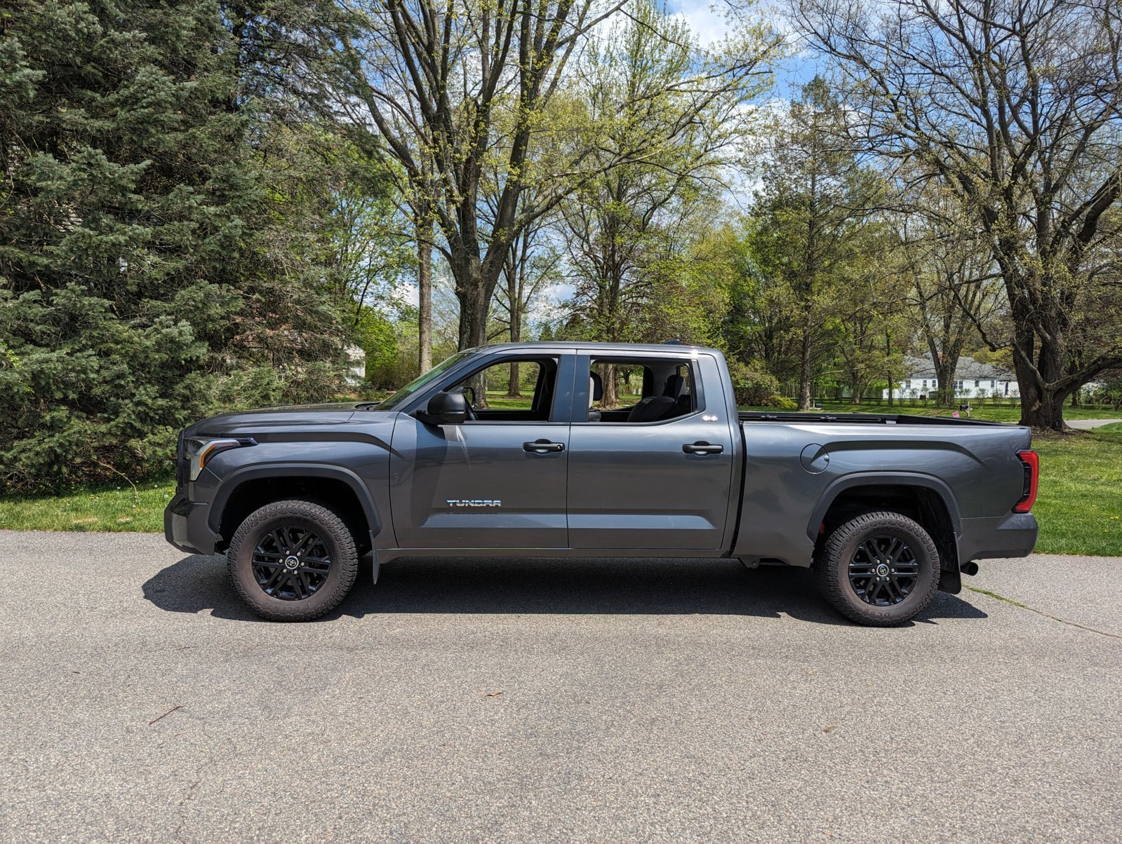

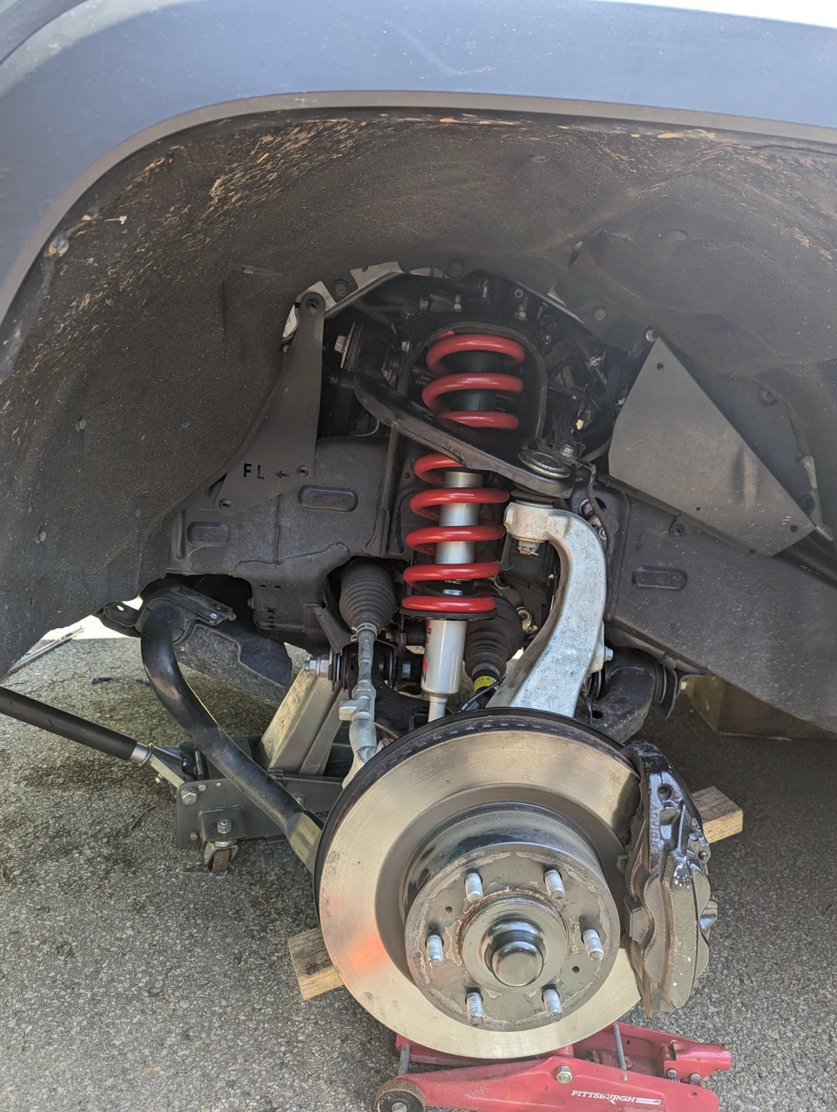

    I just installed this today. I used top circlip setting, there's only two. I didn't measure center hub to fender before I made the change, but it currently is 22.75" in the front and 23.5" in the rear. Slight rake and not too much lift is ok with me, I didn't change the axles or UCA. Looks better and rides better. Getting alignment this week. Anybody interested in some OEM springs? I also have another pair of the TRD lift kit shocks that got damaged in delivery, they sent me new ones, I can make a deal for the combo.PXL_20240429_152148167.jpg PXL_20240429_160357740.jpg PXL_20240429_173245752.jpg

    Truck looks good, I can't see the rake in the pic looks level to me. What all did you do to piece your own kit together?

    Thanks. I agree, it looks level to the naked eye. I purchased the TRD lift kit shocks separately online and OEM springs I found cheap on eBay, had the springs powder coated. That's it. Better than a spacer, all factory parts.
