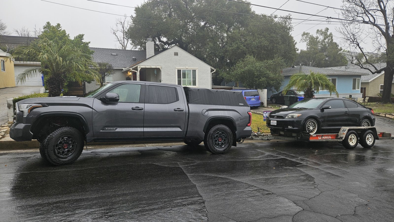

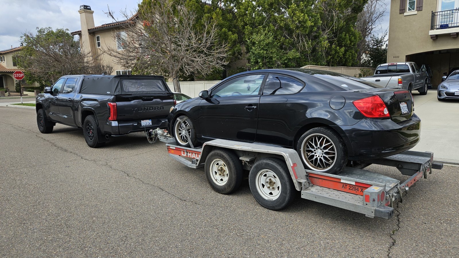

    Hauled a scion tc yesterday. Definitely need stiffer springs if you do this often.
    First picture parked on an incline. Seems to make it squat significantly compared to a flatter ground.

    934
    Too much tongue weight. Next time, back the car onto the trailer.

    72
    I was thinking about that but they were adamant about loading it forward facing for some reason.

    934
    Who's "they"? The U-Haul folks? They are notorious for being idiots.

    Yeah uhaul folks and the manual.

    934
    Not a heavy car anyway, but more weight ahead of the axles generally isn't good.

    I’ve used those auto haulers so many times without issue however never on a 3rd gen Tundra. That trailer is an excellent vehicle hauler.
    You can’t park the vehicle any other way aside from how that picture shows since the tire straps wouldn’t reach and wedge against the front section.

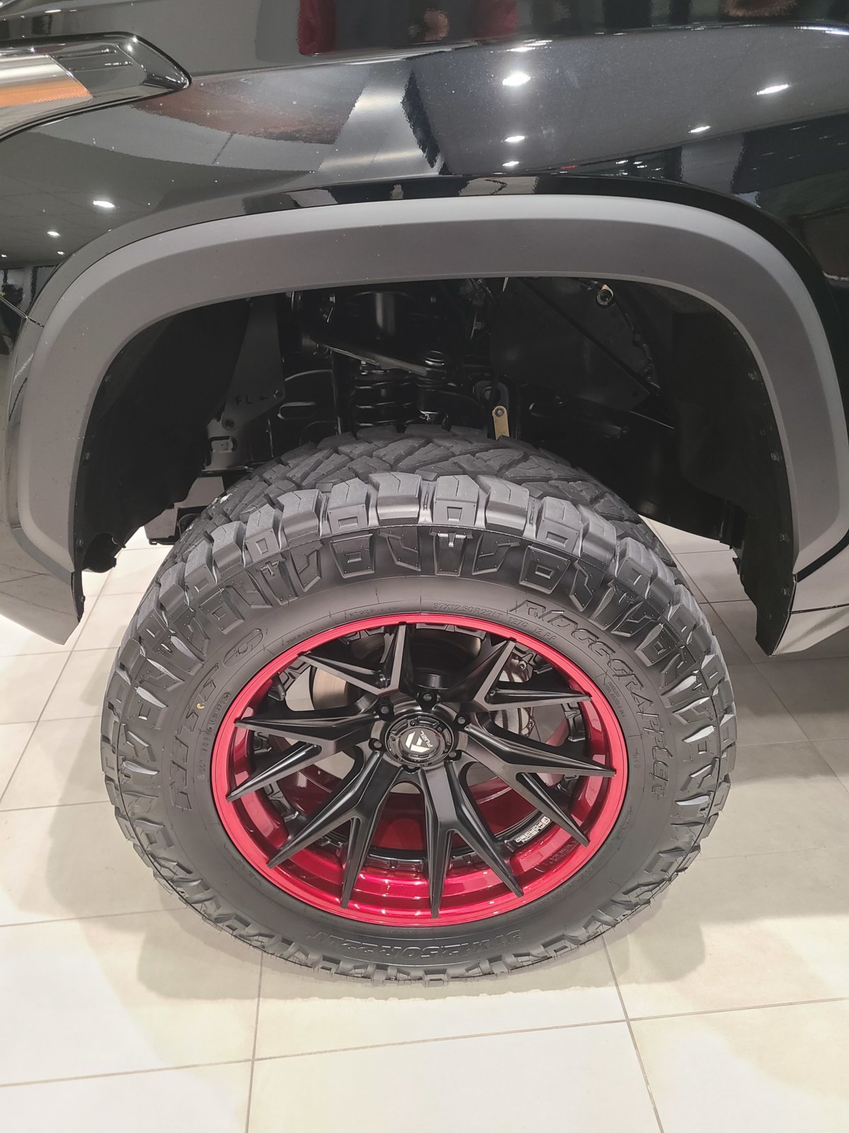

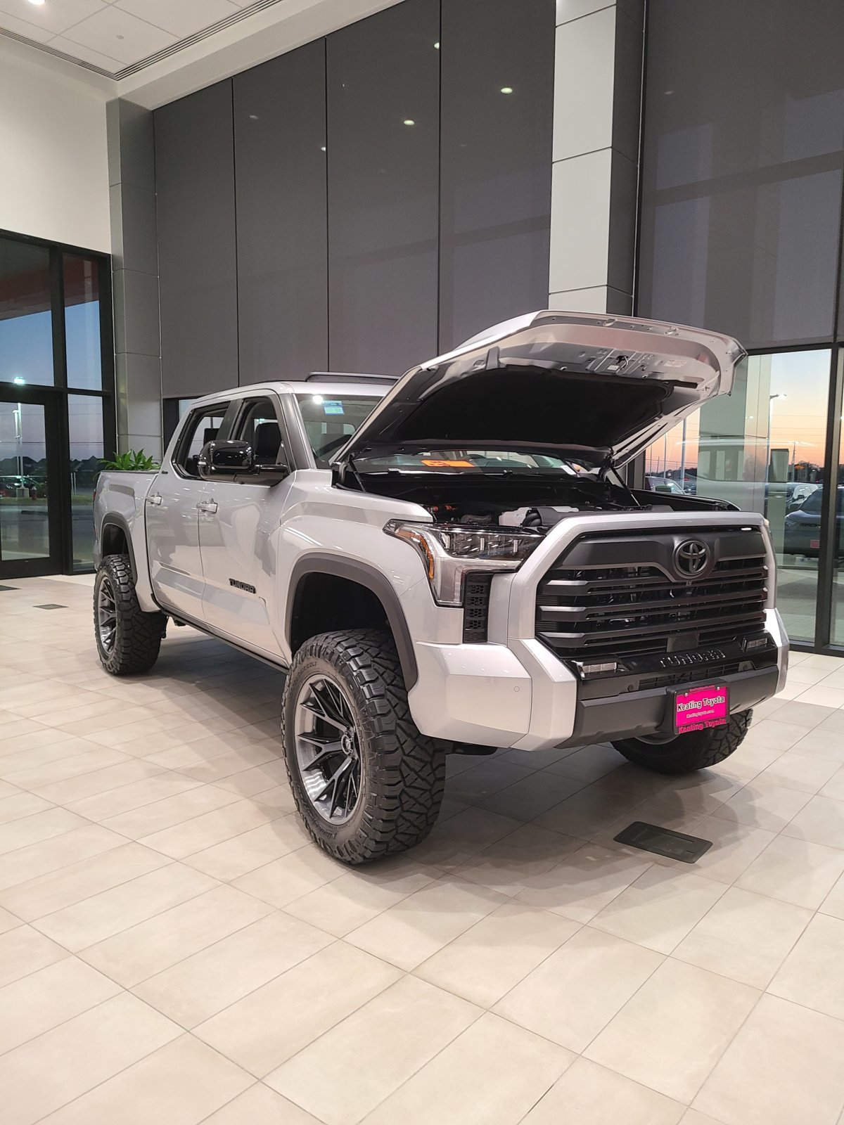

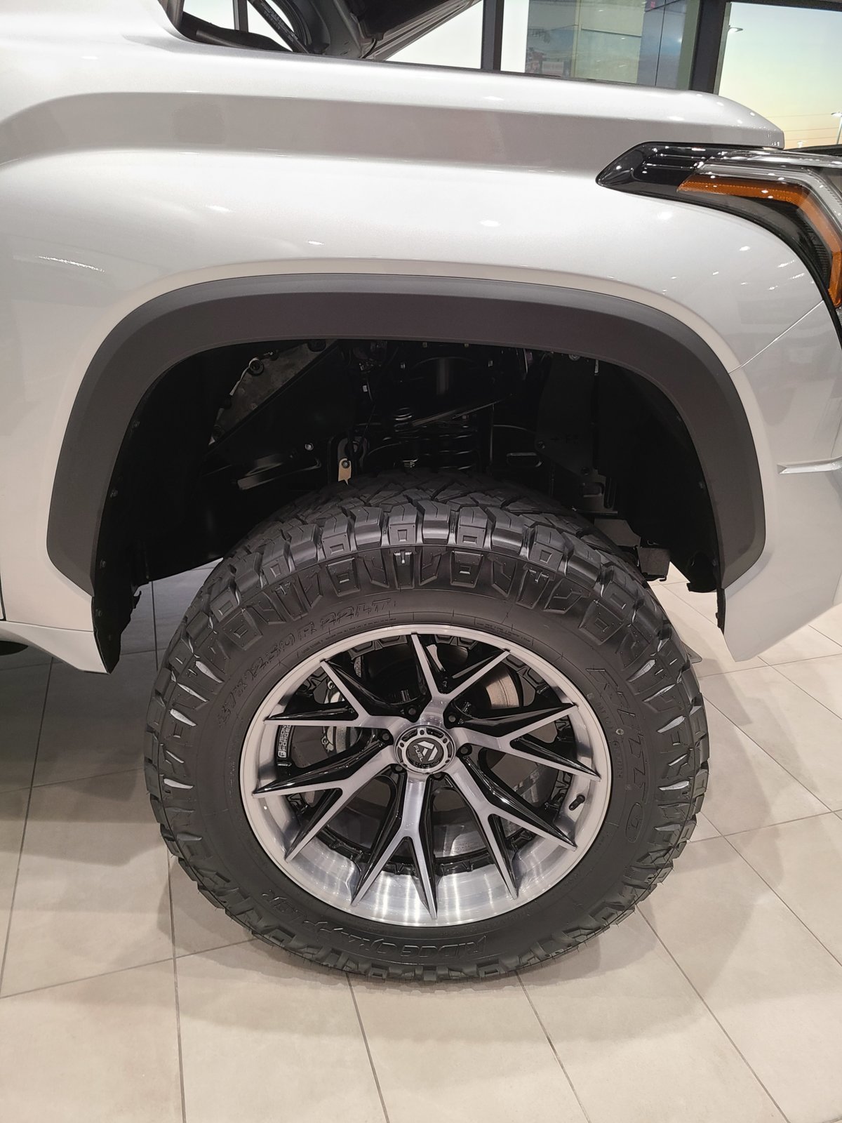

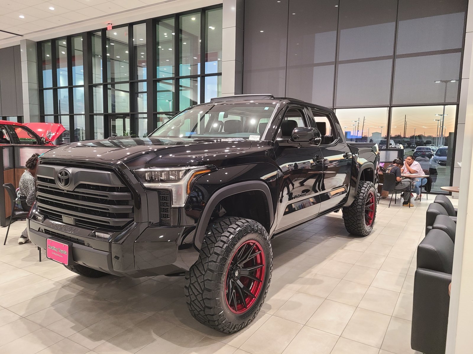

    My local dealer had these two with 6" lifts 37's. Asking $88.5k each, ouch.

    Jeez that looks excessive for something not that heavy. Makes me nervous about pulling my toy hauler, which is one of the reasons for going from Taco to tundra, hopefully the weight dist hitch helps. Haven't towed my trailer yet with the lift and before the lift I only moved it around the house once. I thought about air bags since I've used them on other trucks. I wonder if it's just your tongue weight making it look worse.

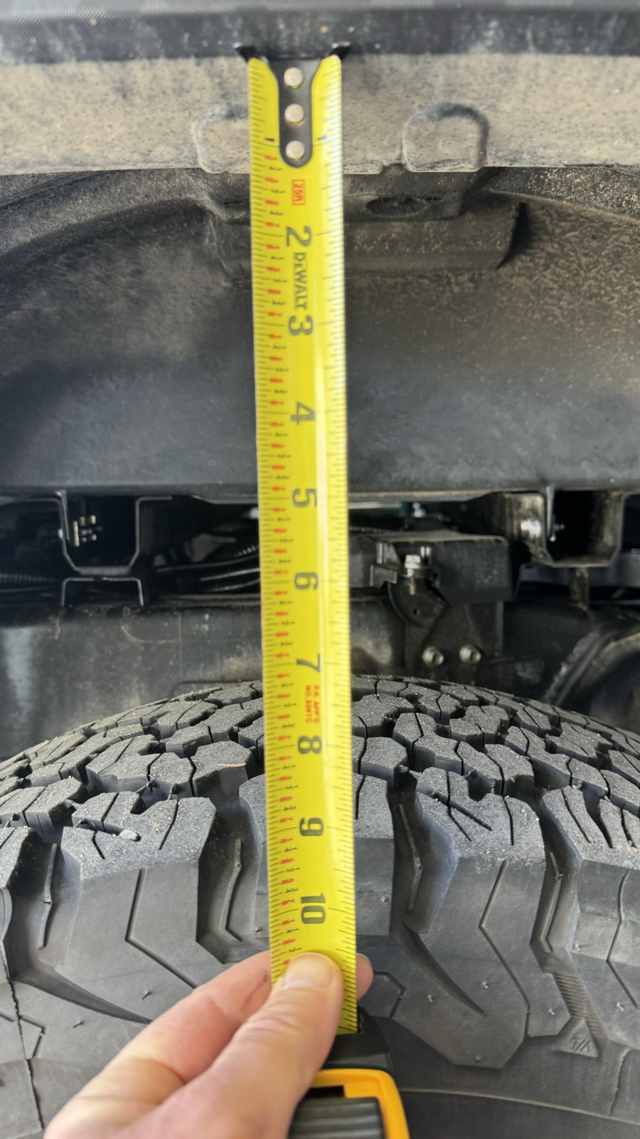

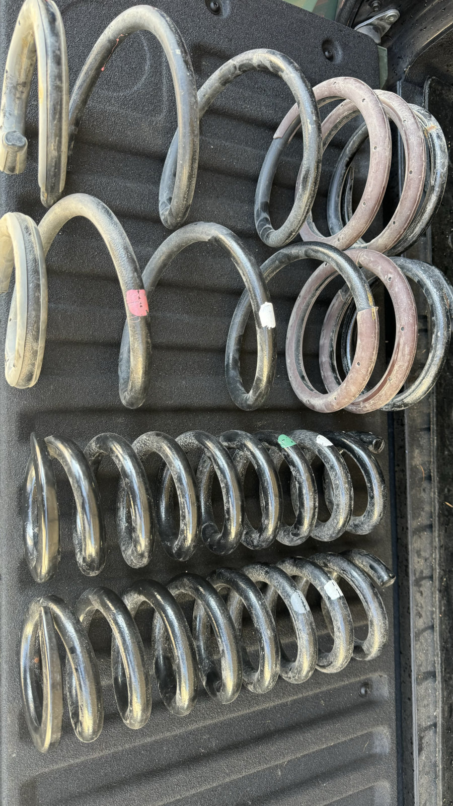

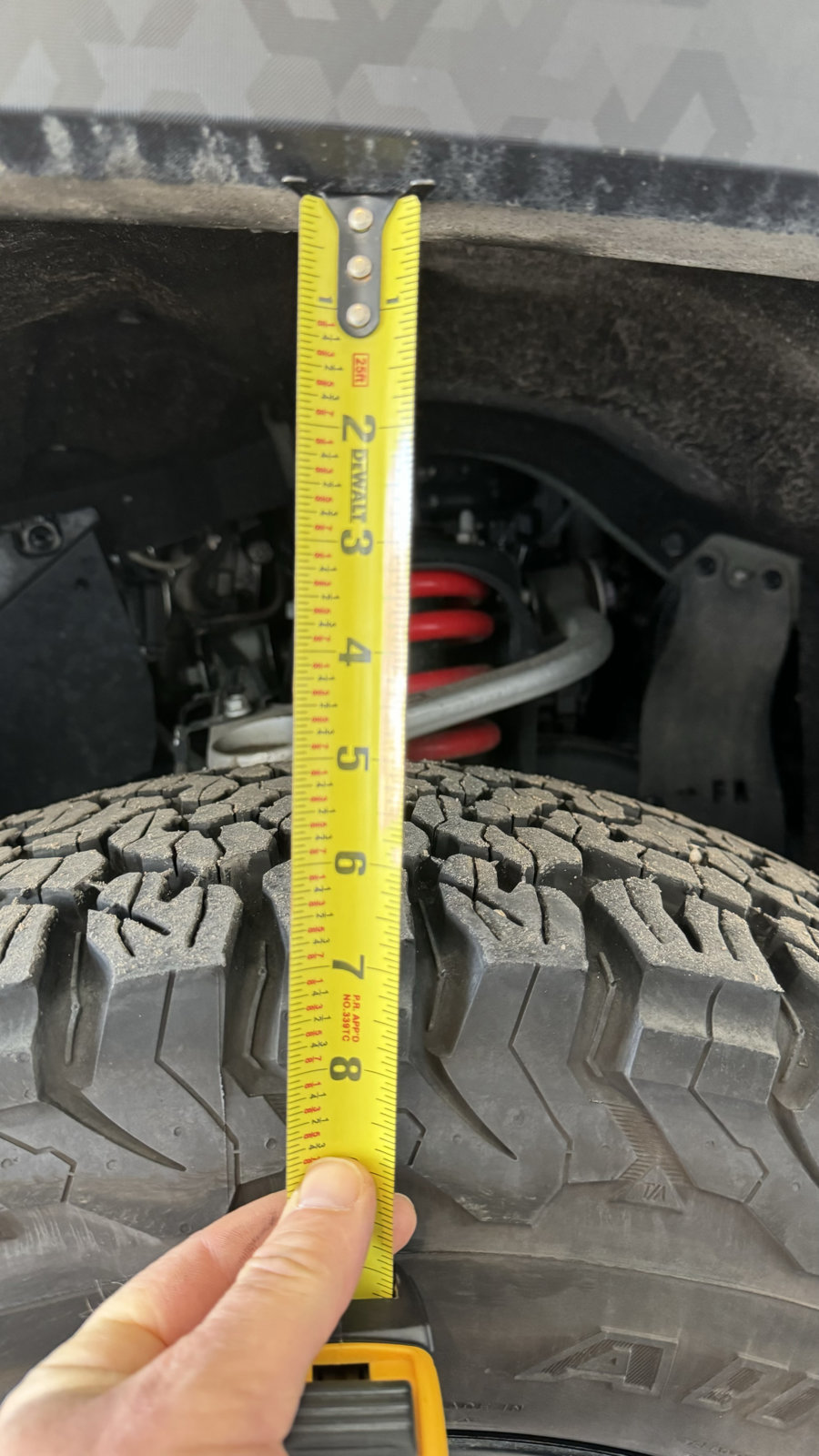

    I have a rear spring report about my Toyota 3" lift kit installed at the dealership. When I got the lift kit originally installed, I believed that a spacer was added to the rear springs to provide a lift. Recently, I changed my rear Springs to OME2866 Coils (Pair) (240-300 Progressive).
    After these were swapped, I was expecting to be told that the spacers had been removed, and that I would still be fairly level f/r (without the spacers) due to the 2866's added height. The shop however told me there were no spacers to remove, and the new shocks ended up giving me a 3" rear lift. My rear is now 1.5" higher than the front and I don't like the rake.
    I took pics here of my previous rear springs, and my previous front coils. When I'm towing my trailer my truck is level, but otherwise the 2866 rears are clearly too high (see truck tape measurement pics).
    I called Dobinsons and they asked me for some measurements. Currently my measurements are 26.5” hub to guard rear, and 24” hub to guard front. Rear is 1.5” taller. Dobinsons indicated that if I want to go completely level F/R with a 1" rear lift those springs are C59-835VR. If I want to go 2” in the rear, (reducing my height by 1”), the part is C59-841VR (2” of lift). This keeps the original rake.
    Both of these are available in red. Because I tow and use my 6.5' bed for cargo I think I'll go with the C59-841V. I'll post pics. Thanks!
