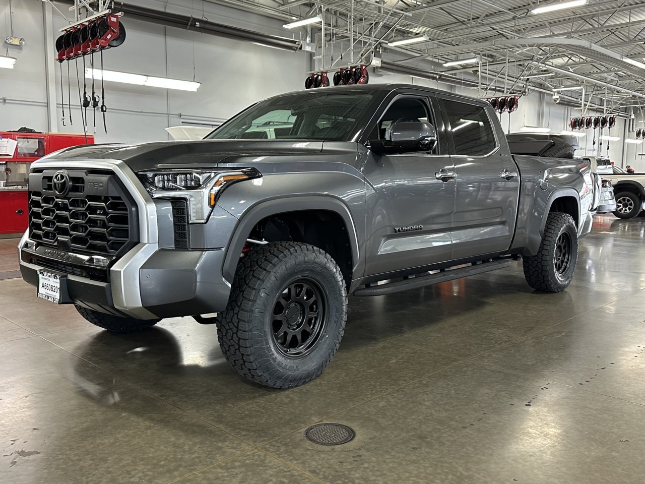

    Just had the TRD lift installed at my local dealer on my 23’ Limited. I originally planned on keeping the stock 20” TRD wheels and throwing some 285/65/20 all terrains on since that’s what Toyota says will fit, according to their literature.
    After reading that many were people reporting sway bar rub I decided to bite the bullet and snagged a set of Method 316’s in 18x9 +18mm offset. Wrapped them in Toyo AT3’s in 35x12.5X18 (D load). Will be picking up tomorrow from the dealer! The tech told me everything aligned perfectly and there is “Zero rubbing”. Will update when I pick it up! They also removed my TRD skid plate due to the sway bar drop. I may try to install it under the sway bar or have a shop machine me some spacers for it.
    Hoody, jachal, ScootARoot and 10 others like this.

    That looks good! I think that the 6.5 bed was needed on the Tundras and when it's lifted like yours it all just makes sense! it has an actual usable bed! I can't stand my 5.5

    Thanks man! I love the 6.5’ bed, it looks proportionate especially once lifted or leveled.

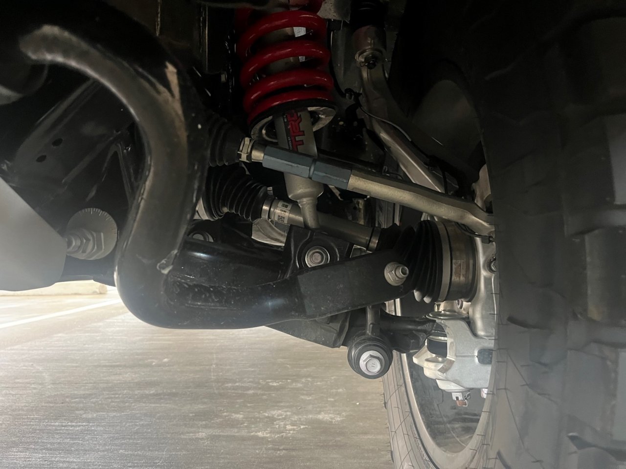

    I got the TRD lift on this past weekend with 295/65R20 Toyo Open Country AT 3's on the factory 20" TRD wheels. Rides great!

    How are the CV and rack and pinion angles after the lift?

    They are a bit steeper, but the new CV shafts that come with the kit are a bit longer and do not appear to be in a bind. The angles on the tie rods aren't bad.
