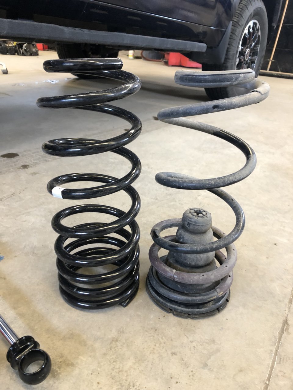

    I got my OME 2866 off eBay while they were still being sold as Land Cruiser springs. The dobinsons are nice

    Great find on your 2866s! Yaboy, is that pic a comparison of the stock TRD OR rear coil spring with the OME? The Toyota spring looks so weak in comparison! No wonder the OME or Dobinson ride so much better. I’m excited to receive my set of C59-843V. I’ve heard Dobinson are amazing, just couldn’t get my head around the pale teal green. Red on the other hand :thumbsup:

    This is a comparison, now think of spending the money on the TRD lift that just adds a 2” spacer on top of those stock springs.

    You are right Yaboy! That’s exactly what I did haha ;) while the TRD lift kit spacer is indeed red, it’s just a flimsy red piece of plastic on top of those already unimpressive coils! Having the Dobinson in its place will be a major upgrade.

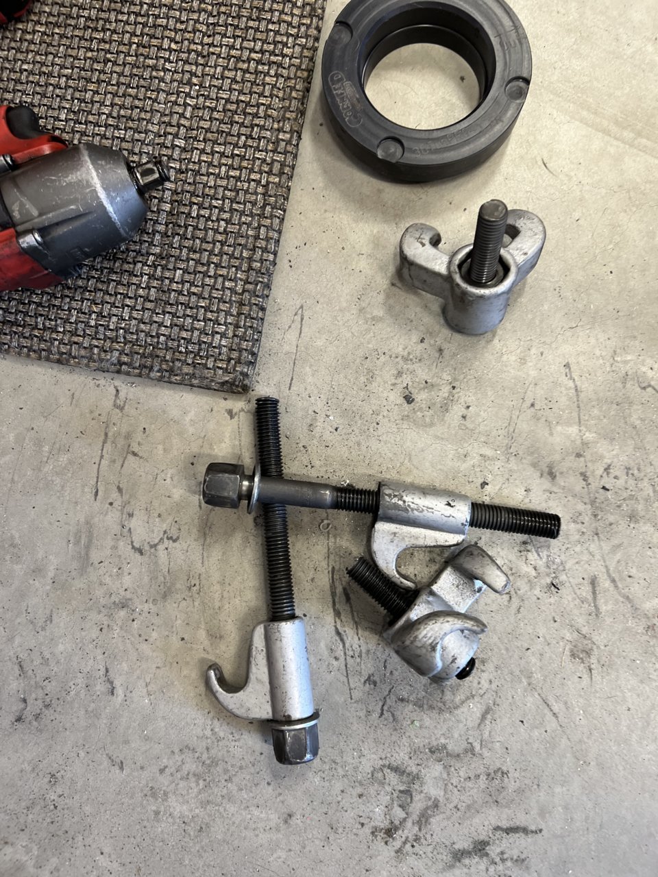

    Not a good way to start the install to my leveling kit lol

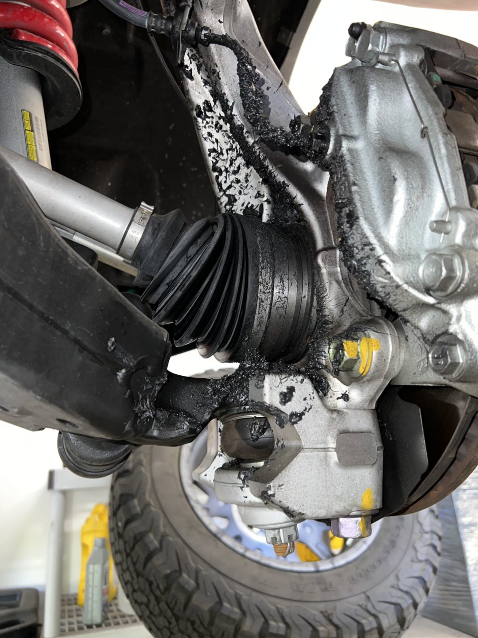

    We’ll just took my wheels off for the first time since getting installed and found this:

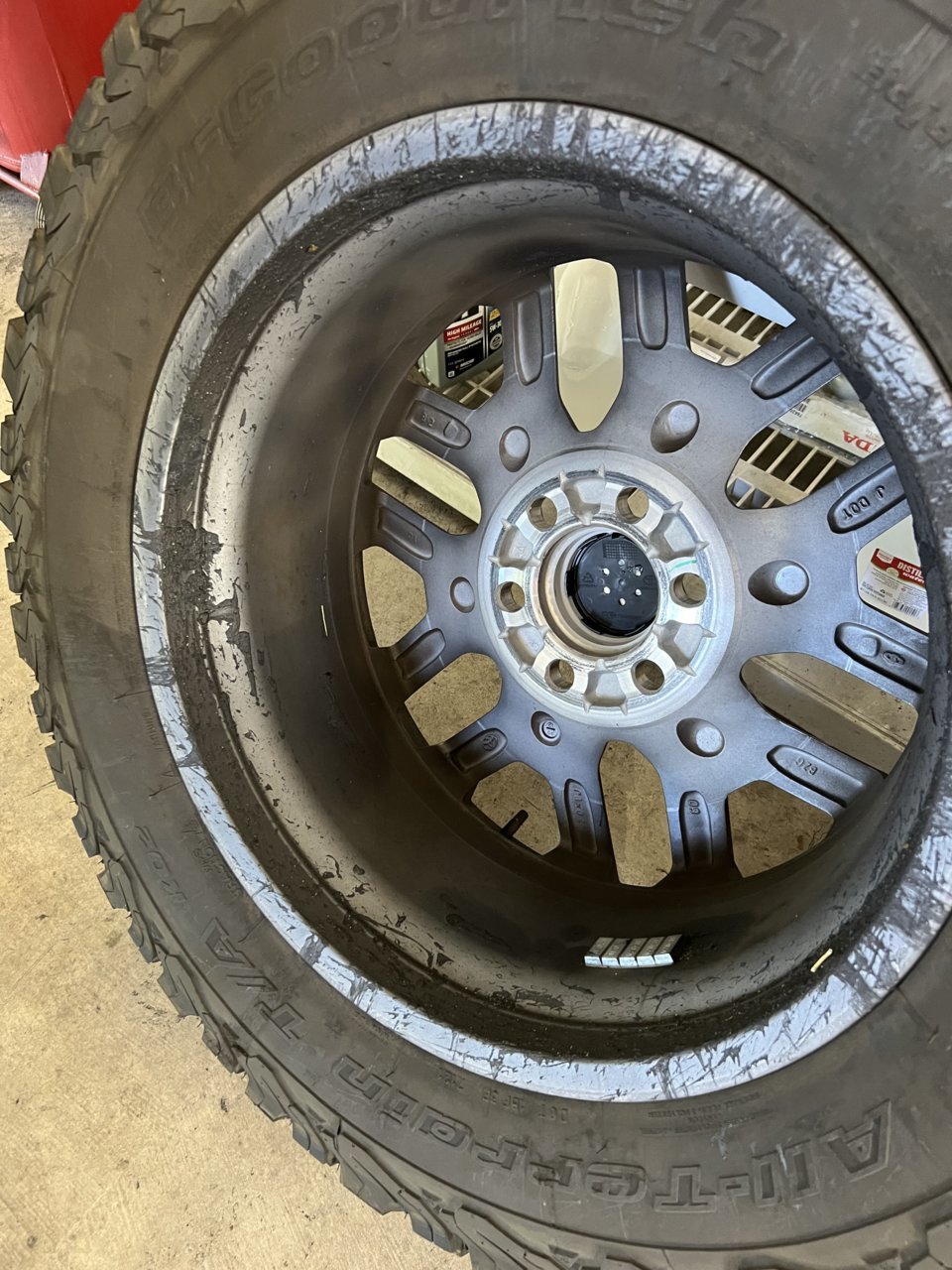

    All over the back of the wheel too:
    What worries me a bit is I just went on a 1500 mile road trip. Trying to get ahold of the dealer now. Shoot.

    No bueno and seeming to become all too common with this lift. Anyone diagnose if this an install issue or just an issue with the parts? I’ve had mine for almost five months and haven’t had any issues with the seals like this

    what is the fix for this?

    Sounds like something might have gone wrong in the install. There some element of tolerance stack up here. I have almost the exact same truck as you with the same size tires and no rub. I bought spacers but never wound up using them.

    Thanks. I’m dropping the truck off at the dealer now to have them fix the axle seal problem. I told them about the rub and they are going to look at that as well.

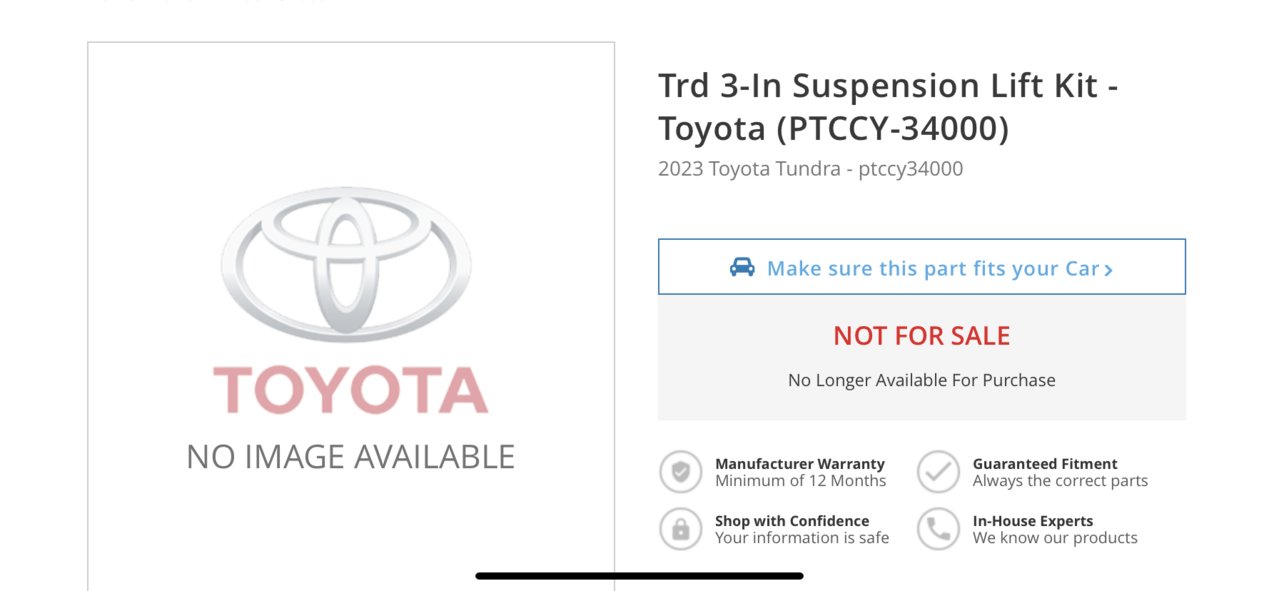

    IMG_8808.jpg Was about to order this kit today and found some of the online Toyota parts stores are starting to say that part no. PTCCY-34000 is “No longer for sale”…. And the places that still have it in stock, are starting to discount it… I like savings, but that’s not a good sign.
    Wondering if there are perhaps further issues with this kit than we know.

    Mine had about 1000 miles on the kit when I had problems. It’s fixed now…dealer said most likely came defective, but they couldn’t be sure. They said there were razor like cuts in the boot.
