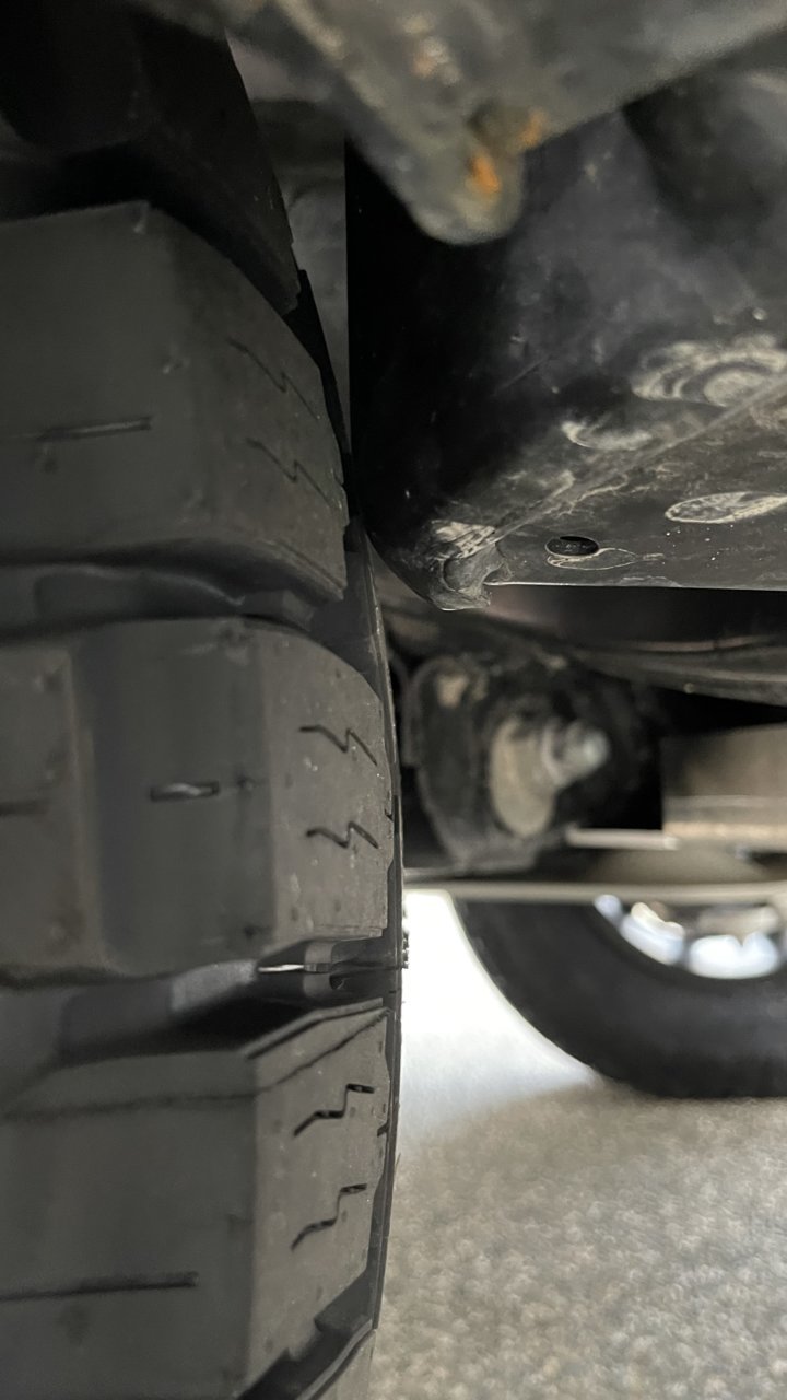

    I decided to have the 35s mounted and I’m taking it to a 4x4 shop on Tuesday to have it chopped to prevent the rub. I had them look at it with the stock wheels before I went back to have the new wheels/tires mounted.
    I’ll post another picture in a bit at full turn to show the rubbing. No issues on the sway bar/control arms. It was just hitting at full lock at Discount.

    So the passenger side does not hit at full lock, but the the driver side does. Method 705 18” +18 with Toyo AT3 35x12.5x18

    It’s got to be the sway bar - or, at worst, the extension in front of the body mount. I did the TRD lift on mine (installed myself) and preemptively did the body mount chop. With 37x12.5 BFG KO2s on 17x8.5 +28 Icon Vector 6s, the only rubbing I get is on the sway bar at full lock

    Yes, it’s the body mount that has a slight rub. I noticed I said frame, which may not have been correct. I’ll be getting the body mount chopped. My understanding is this is a type of crash deflector to prevent the wheels from going up into the cabin?

    That’s an extension in front of the body mount. You can remove it easily with a grinder with a cut off wheel. Here is what it looks like after cutting it off (and painting):

    Not sure why they included it… Toyota did the same on Tacoma, and, in some of those, you have to have a plate welded on to cover the resulting hole in the frame. In the case of Tundra, as you can see from my pic, the frame remains fully enclosed and intact, as long as you don’t cut too deep.
    FWIW, people have been doing the body mount chop on Tacomas for years.

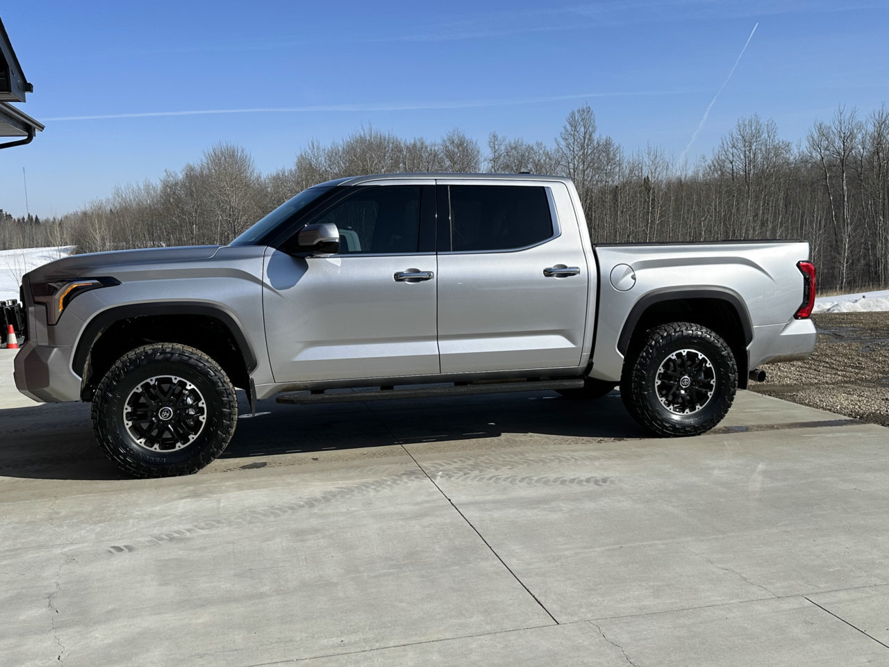

    Just came back from the dealership, TRD Lift and 285/75 R18 Recon Grapplers.

    Looks awesome, congrats.
