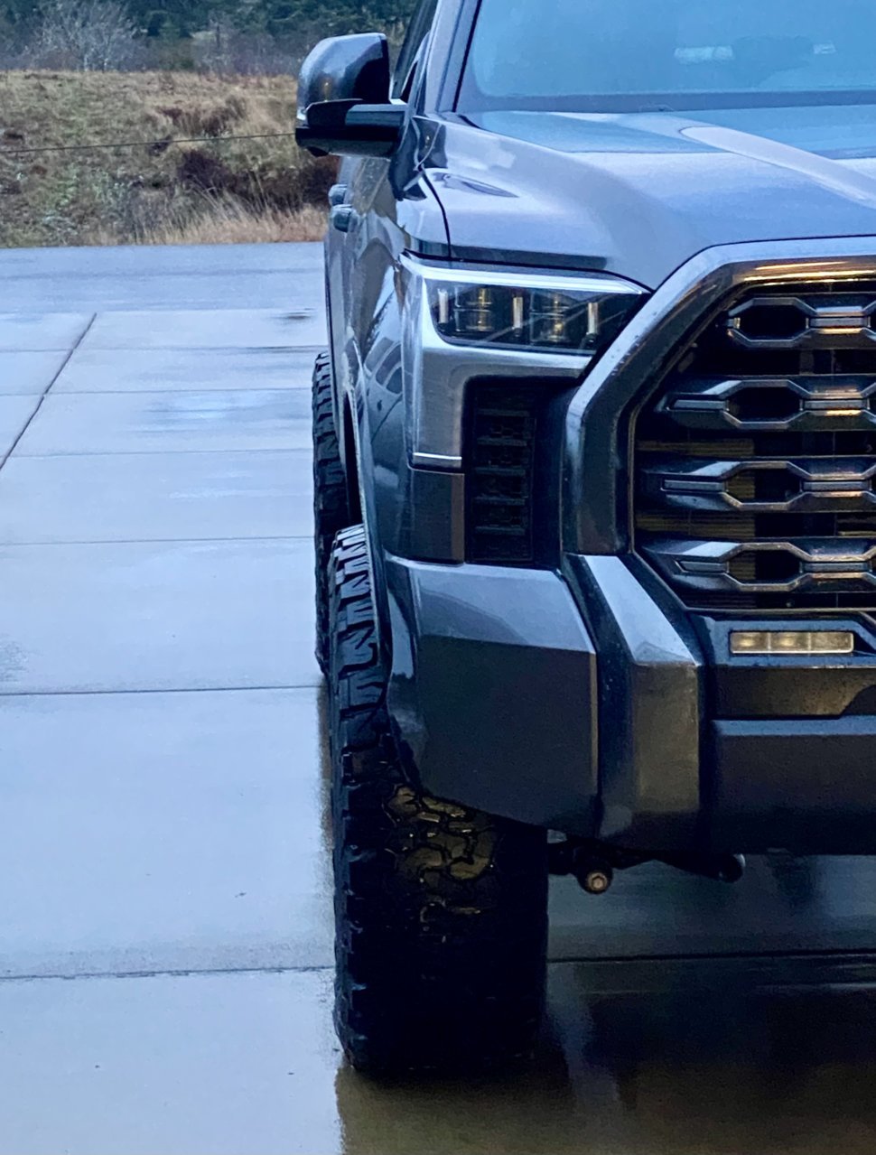

    @RJ29 Great looking truck! I have a similar truck hitting the lot in a couple weeks. The dealer already has the TRD lift waiting. Trying to finalize the wheel and tire order now. At +18 offset, how much do your tires "poke" out the side? I am looking for flush or minimal poke. It looks like the stock platinum wheels sit a little inside the fender, without using a spacer. Thanks
  17. Mar 8, 2023 at 10:49 AM
    #587
    RJ29
    RJ29 New Member
    Feb 9, 2023
    #91751
    7
    RJ
    Oregon
    ‘23 Tundra Platinum 6.5’
    OEM TRD Lift, 35x12.5 KO2’s, 20x9 +18 Mayhem Wheels, Go Rhino RB20 slims
    Thanks! stocks were too sucked in for me, and I believe the 35’s would rub without a spacer. +18 offset does have some poke.

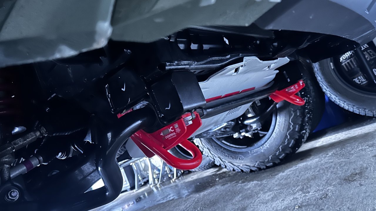

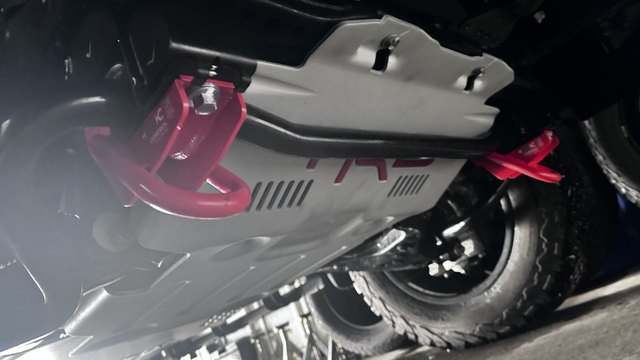

    Hi guys! I wanted to share an update re my TRD lift kit sway bar spacers and end links that I did not have installed when the rest of the kit went in.
    My thinking was that I wanted the sway bar under the TRD skidplate for protection. Toyota should have designed it better so that those would fit.
    I was happy to have the clean look under the skidplate, however I became aware that this limits the geometry and full articulation of the front coilover.
    Since the install I’ve been struck by how harsh the suspension was running, I was required to really lower my tire PSI. I returned to my dealer for the suspension check-up and re-torque they had promised, and they very generously agreed to install the kit’s sway bar spacer and end links as part of the original install cost.
    They ordered some additional bolts (not sure yet of part number) for optimal fitment. They provided me with a loaded 1794 as a loaner while this was being done, very nice to compare trims.
    Yesterday I picked up my TRD OR and my first impressions were that I have no problems with the sway bar outside the TRD skidplate. Invisible unless you’re under the vehicle. The positioning looks far more natural. I should have had it installed this way from the get-go.
    The ride is *significantly improved* even with much higher tire pressure. So this is the way it is supposed to feel!! I do NOT recommend keeping your stock sway bar spacers and end links in order to retain your sway bar under the TRD skidplate.
    I suggest either using spacers to drop the skid below the sway bar, or go this route running the sway bar over the skidplate. I want to thank all of you on this thread for your help, @KroppDuster you really helped me understand the impact of retaining the stock sway bar spacer and end links: thank you! Also my dealership and the master tech have been amazing re this process.
    I am very happy with the setup now. Next change is installation of OME 2866 variable rear coil spring replacing the spacer (Toyota cheaped out on that IMHO). Congrats to all of you who recently had the lift kit installed, looking great! Cheers, Taiko
