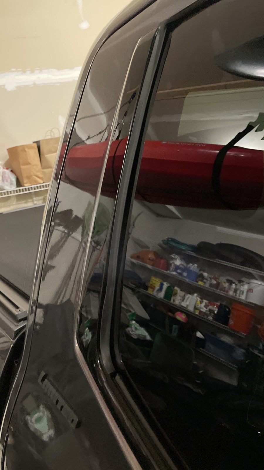

    I have a 2024 CrewMax and both rear window seals (back edge) have massive gaps… not only between to window seal and belt line seal as everyone else, but on the back vertical edge as well… allowing water to pour in, but surprisingly no noise of note.
    I worked in the auto industry as an engineer on door trim, so know this is not right. The triple seals on the door allow water (which will come in the window seals some) to run out the bottom of the door steel and none should get into the vehicle… but this gap is unacceptable. The rear doors are also steel… with less rustproofing internally, so salty Michigan road grime dripping in isn’t ideal….

    My gap concern isn’t that 1/4” gap between the belt seal and window seal that he pokes at…
    My gripe is the warped window seal on the vertical edge.
    And, from an automotive engineer who worked on door trim and seals for 20 yrs….
    1) Water is not ‘supposed’ to get in as he says. It does, and that’s ok, as the weep holes will let it drain out on the bottom of the door steel.
    2) The gap is a tolerance stack issue but is a poor excuse and can and should be controlled better.

    Gotcha. This thread was about “the gap” so I assumed you posted about that. That vertical seal does look warped in your picture. I personally don’t have that problem although I do have other fit and finish issues with my door seals.

    Do you think this is due to sub par materials or installation issues?
  11. Jan 6, 2024 at 1:49 PM
    #71
    Spartanfam
    Spartanfam New Member
    Dec 13, 2023
    #108408
    98
    West Michigan
    2024 Tundra Limited TRD Off-Road
    The 1/4” gap?
    I think the belt seal is too short. Despite the slight upward curve, I’m pretty sure it’s just an extruded seal… so can be trimmed longer. The supplier probably meets the low end of the length spec and was PPAP approved and Toyota had bigger fish to fry than a seal gap on a rear door…
