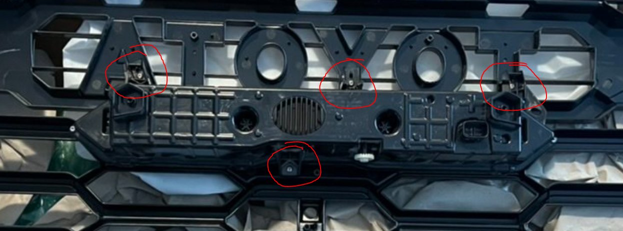

    Anyone know how the oem TRD pro light bar mounts to the PRO grill? I'm purchasing an oem used light bar but doesnt look like it comes with any mounting hardware. Are there pre threaded homes in the Pro grill? Pushclips? Or will i be needing additional hardware to mount? Bolt size?
    Thanks, any tips would be appreciated. My pro grill is still probably a ways out.

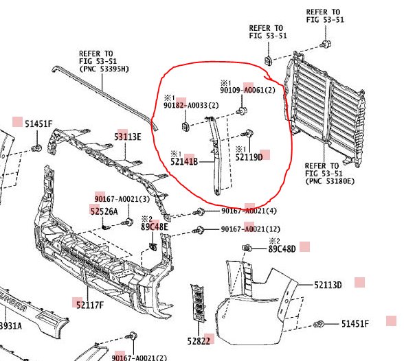

    there are 4 brackets made onto the light bar itself, they screw into the grille, i don't know if they are threaded, i want to say the screws you use will cut threads
    there is also another bracket that the parts.toyota site shows for the Pro, but you can't see the description of what its for, but as far as i know, no one has tried to order, don't know 100% if its for the light bar, but the look of it kinda makes it seem like it would be, to hold the back of it up
    also lots of information in this thread

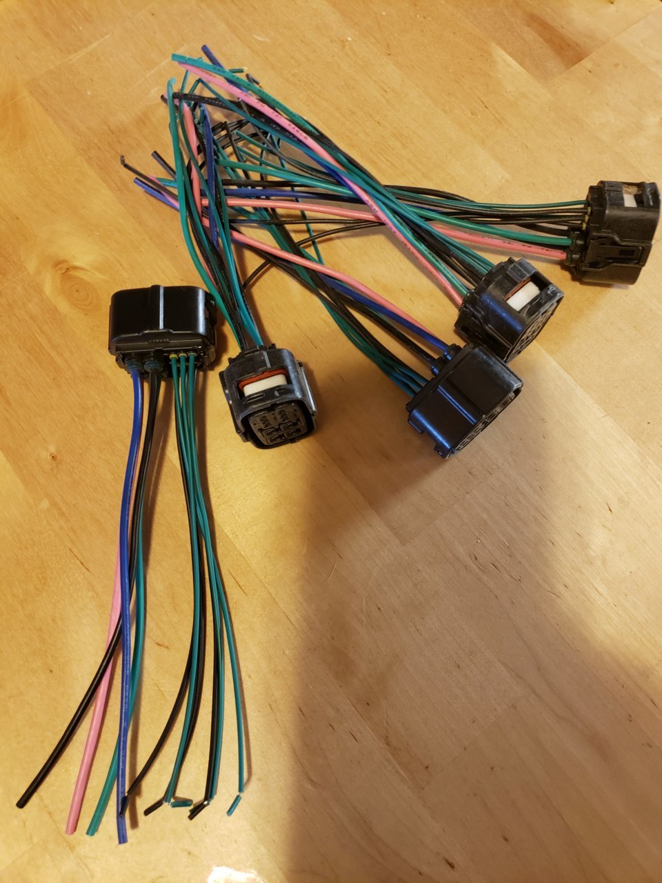

    yea i actually got 5 of the oem connectors with wires in from china yesterday, guess i dont need em now :crazy:

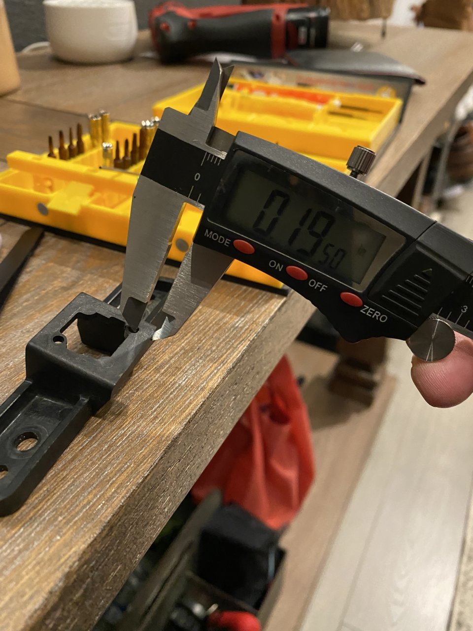

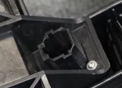

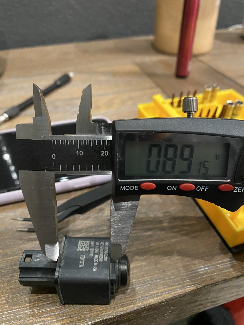

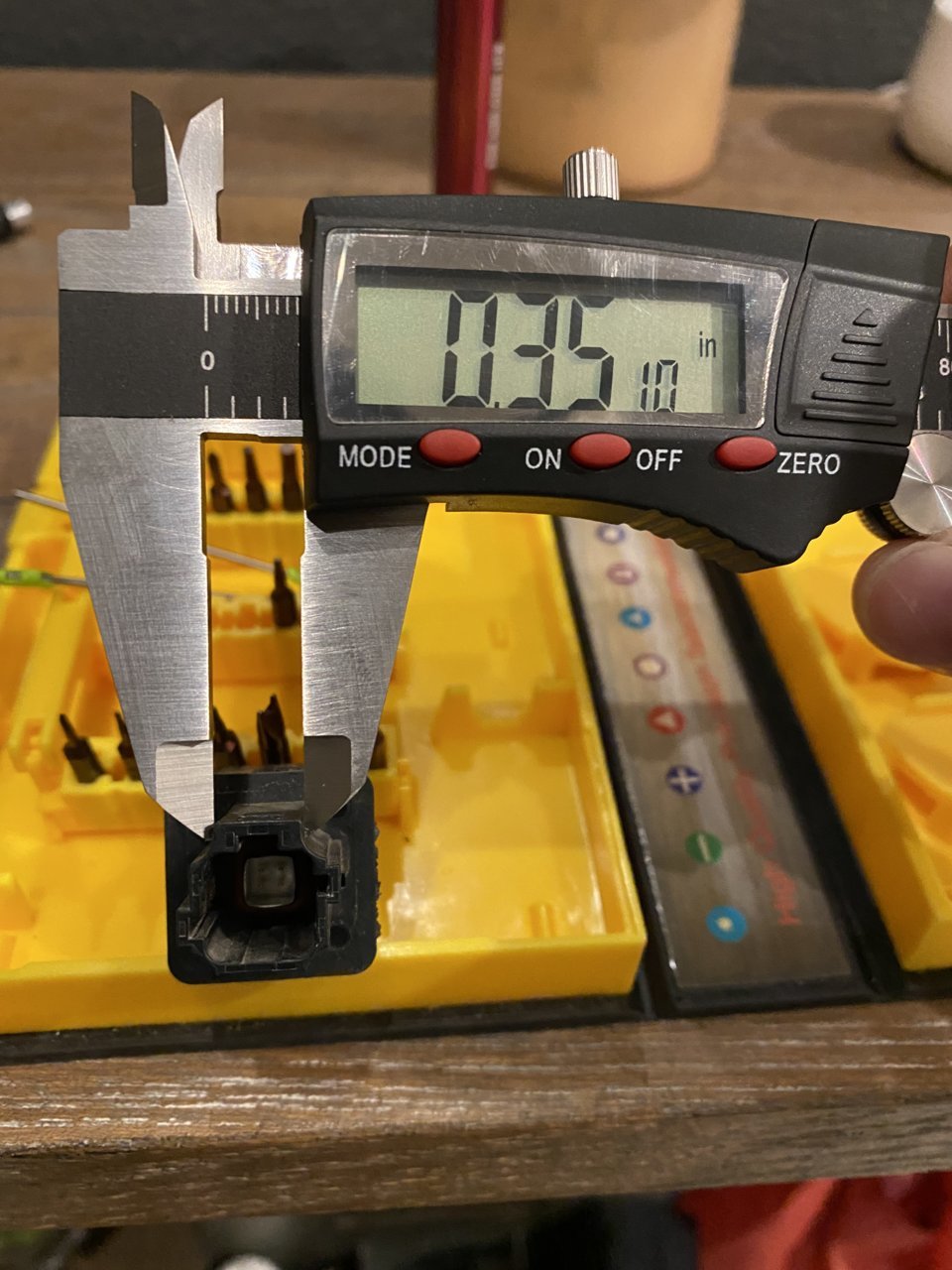

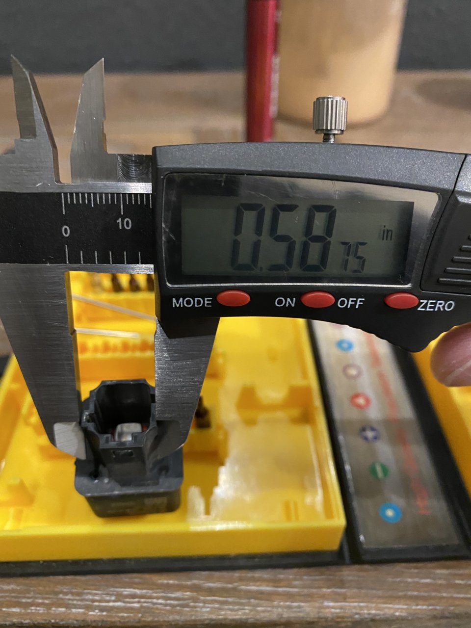

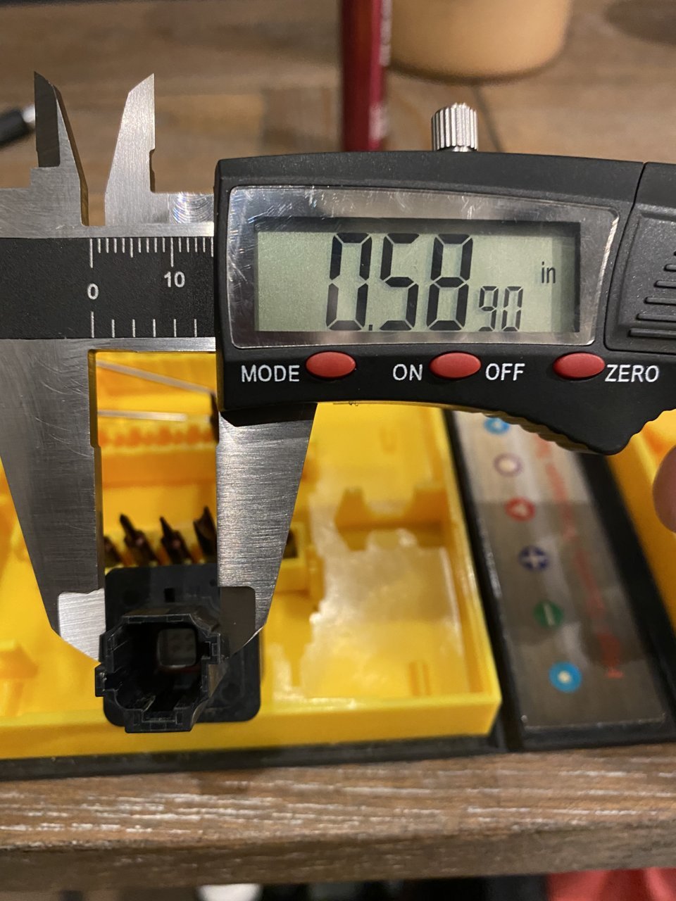

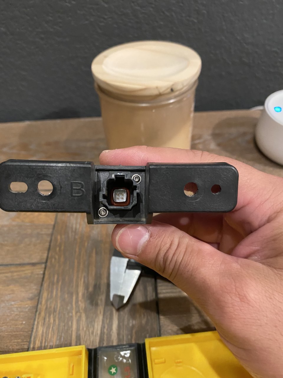

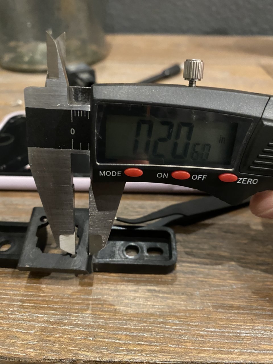

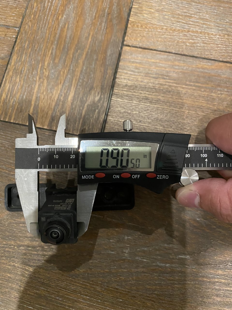

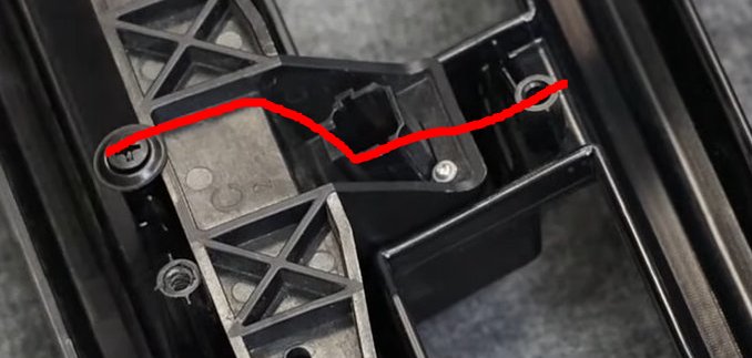

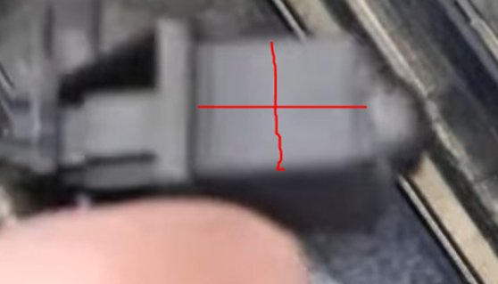

    ok,

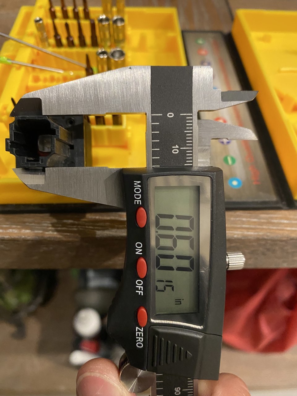

    Camera
    Dimensions of the camera body itself, then dimension with the lens
    Is the camera a true square? Equal on all sides?
    how many mounting points / screws are on the back of the camera where it attaches to the bracket?
    Are there any alignment tabs for the camera?
    What are all the dimensions of the camera connector? One mounting screw or 2??
    how far is the center of the camera mounting screw from the edge of the camera connector?
    How thick is the OEM bracket that where the camera is mounted?

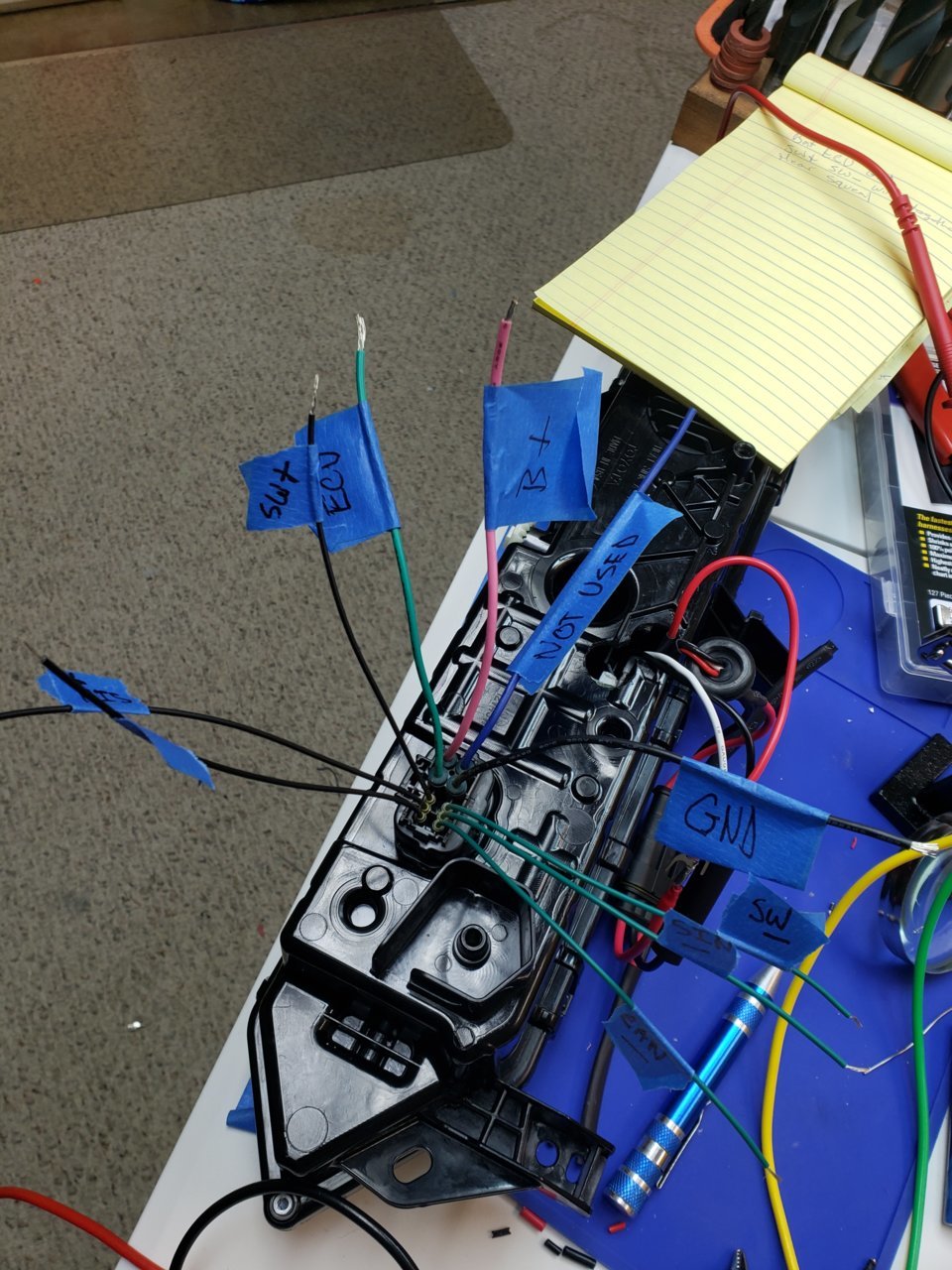

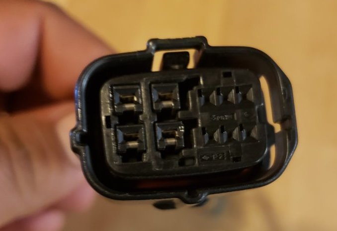

    @TakiEvo , Taki , Tak, im gonna call you Tak, like this guy..

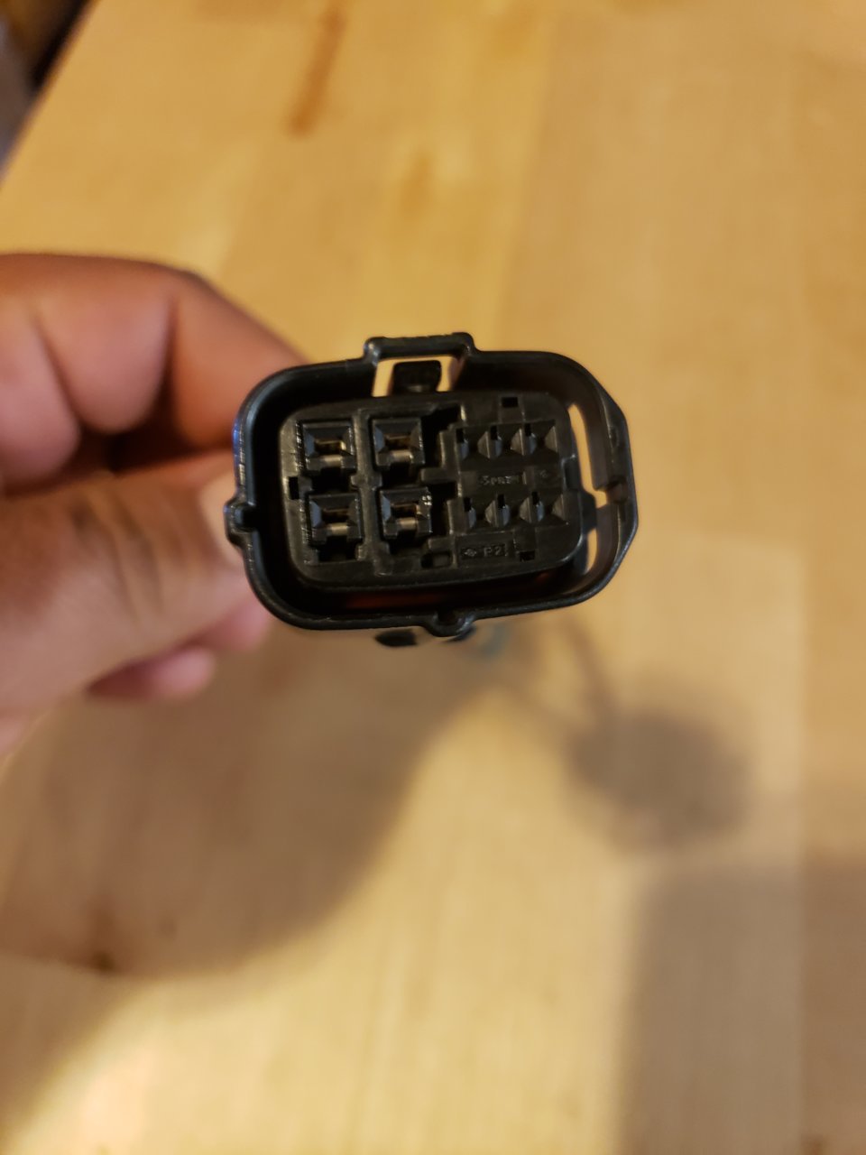

    lets see if we can all work this out together
    So, got some connectors from good ole Chiner,
    i wired my white plug back in and stuck it back in the circuit board
    Bottom of light is the left hand side of this picture
    so following the TIS diagram i labeled the wires as looking straight on the connector pins facing me, with the push clip latch facing up
    running bench power supply at +12V
    B+ & G = no other pins have power
    SW- & SIN- have continuity to ground
    from here down assume GND is connected.
    B+ & ECU @ 12V
    SW+ , Jumps voltage from 0v to +12v, 3-4 times then goes to 0 and stays there, this happens every time ECU wire is connected to +12v
    SIN+, has +12v
    CAN+, has +2.5v
    CAN-, has +2.5v
    SIN-, has 0v
    SW-, Has 0v
    B+ @ 12v
    ECU @ 5v
    SW+ does the same jumps 3-4 times 0v - 12v, then goes 0
    other pins are same as above
    B+ & ECU @ 12v AND ECU @ 5v
    Wire SW+ & SW- Together = High pitch Squeal like somethings about to give out
    B+ & ECU @ 12v
    Wire SIN+ & SIN- Together = Squeal & no light
    Other notes
    Grounding CAN- at any point makes CAN+ go to 0v
    Putting all +'s to 12v and all -'s to Ground does nothing
    this is the testing that i have done,
    if anyone has any suggestions/ combos to try, please let me know and i shall try
    i do have the ability to do multiple voltages on different pins as i have some buck regulators that have adjustable voltage,
    from my experiences in automotive, B+ is 12-14.5v , ECU's run +5v, CAN is +3v

    went and backfed the little white connector with power and ground and had the light on, measured the wires at the external connector
    didn't try to jumper any together
    B+ +12v
    ECU 0v
    SW+ Jumps the voltage 3-4 times 0v -12v - then settles 0v
    SIN+ +12v
    CAN+ +2.5v
    CAN- +2.5v
    SIN- 0v
    SW- 0v
    GND - 0v
    powered back through the external connector
    B+ & SW+ @ 12v
    ECU 0v
    SIN+ 0v
    CAN+ 0v
    CAN- +2.5v
    SIN- 0v
    SW- 0v
    i wanna slap whoever designed this light
    ryanwgregg likes this.

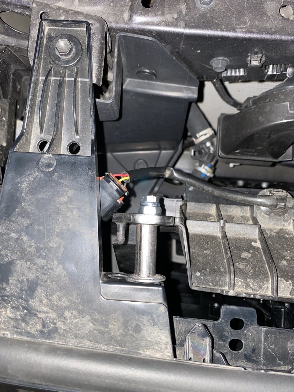

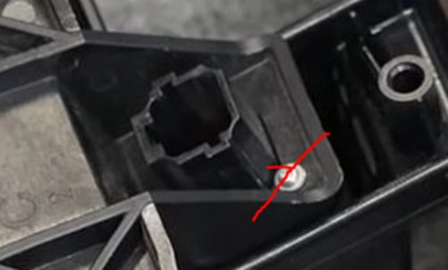

    For sure the platinum camera mount will not work with the trd pro grille as it has no where to mount.
    I might have to use silicone as a filler until something comes out.
  18. Jun 16, 2022 at 2:56 PM
    #48
    Brums
    Brums [OP] New Member
    Apr 24, 2022
    #77540
    415
    Bethel, OH
    22 Tundra DC TRD Sport

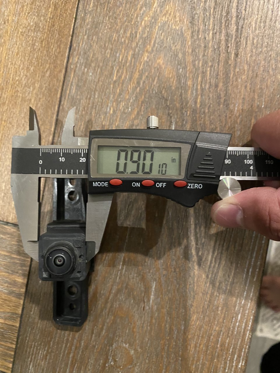

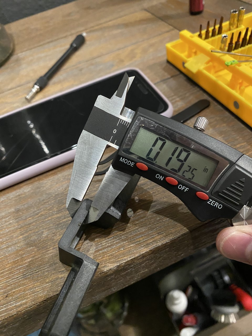

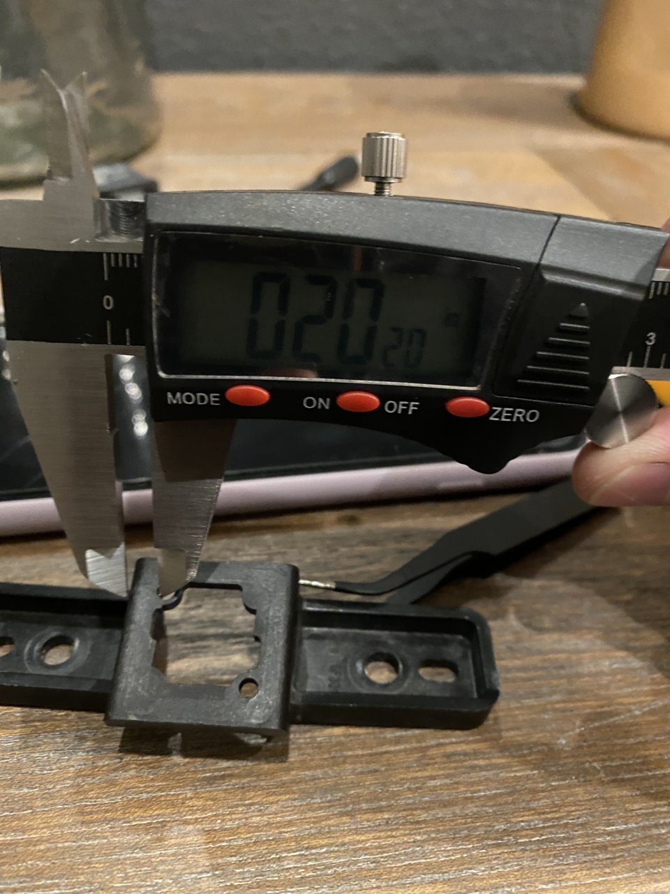

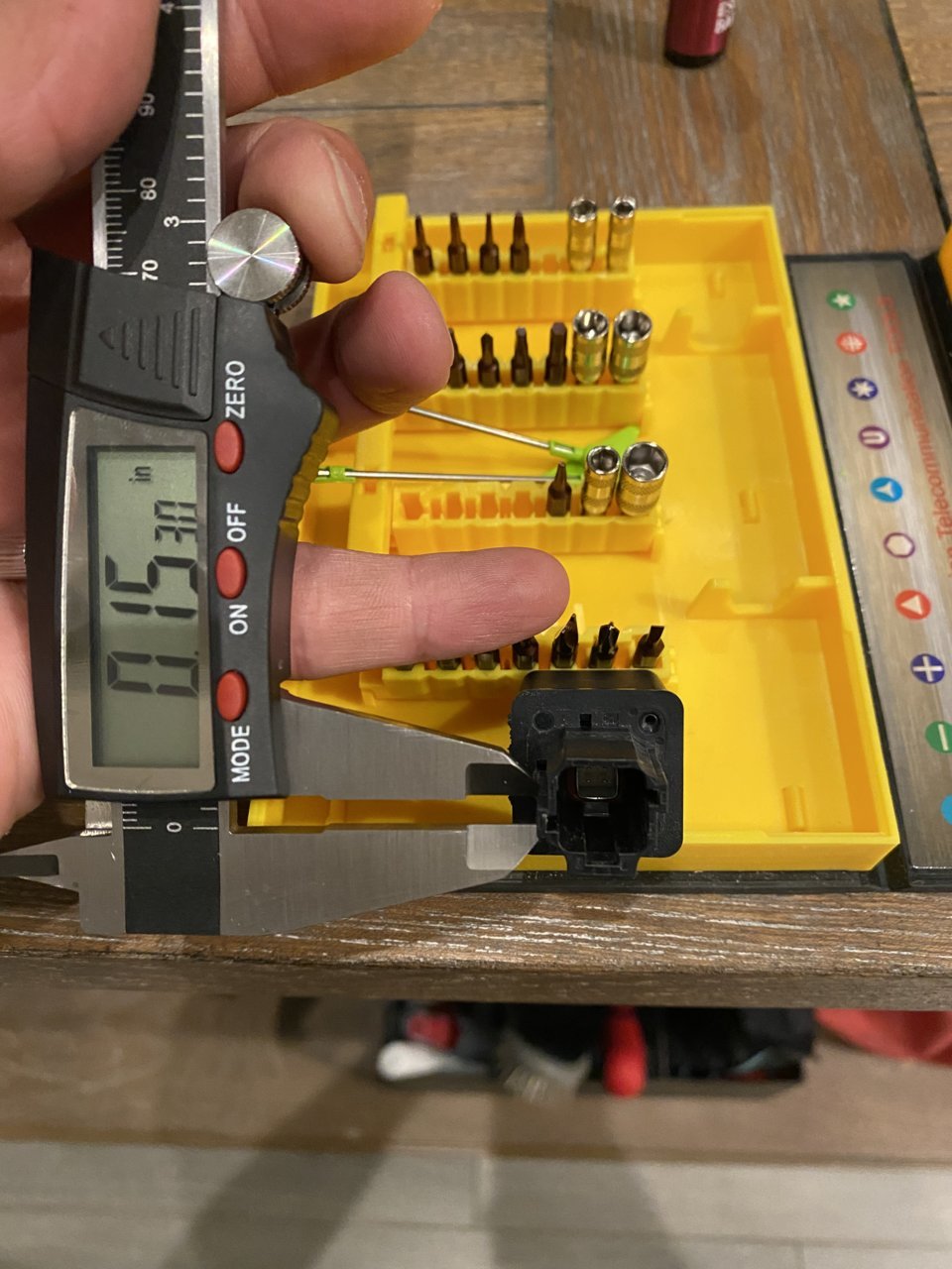

    did ya happen to take those measurements?
    Jr3volution[QUOTED] likes this.
  19. Jun 16, 2022 at 8:43 PM
    #49
    Jr3volution
    Jr3volution New Member
    Dec 2, 2020
    #55586
    211
    Johnnie
    DFW TX

  20. Jun 16, 2022 at 8:48 PM
    #50
    Jr3volution
    Dec 2, 2020
    #55586
    211
    Johnnie
    DFW TX
    2022 Tundra Platinum
  21. Jun 16, 2022 at 8:51 PM
    #51
    Jr3volution
    Dec 2, 2020
    #55586
    211
    Johnnie
    DFW TX
  22. Jun 16, 2022 at 9:15 PM
    #52
    gr8fasushi
    gr8fasushi 22 Tundra Limited TRD Off Road
    Dec 27, 2019
    #40378
    109
    thx for the details, will definitely be doing this mod

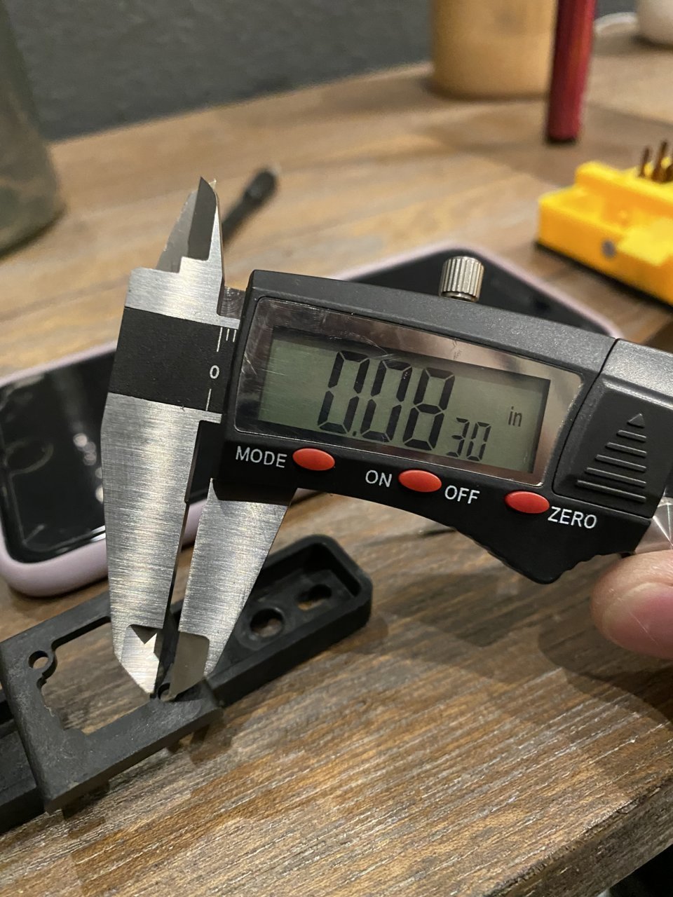

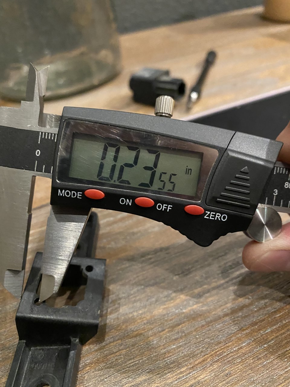

  23. Jun 16, 2022 at 9:28 PM
    #53
    Brums
    Apr 24, 2022
    #77540
    415
    Bethel, OH
    pictures are worth a million freaking words!!!!!
    Thank you!:bowdown::bowdown::bowdown:

  25. Jun 16, 2022 at 10:34 PM
    #55
    Brums
    Apr 24, 2022
    #77540
    415
    Bethel, OH
    details?
  26. Jun 16, 2022 at 11:12 PM
    #56
    Jr3volution
    Dec 2, 2020
    #55586
    211
    Johnnie
    DFW TX
    I’ll shoot y’all the details tomorrow as I packed most my junk up.
    One thing to note is that the front camera isn’t stitched well with the other cameras
    2A1F8B24-F897-4E69-BECF-B7EBB7DD959A.jpg 1F96F0A8-2FDE-491B-A992-8F4553C90F6E.jpg

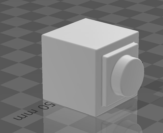

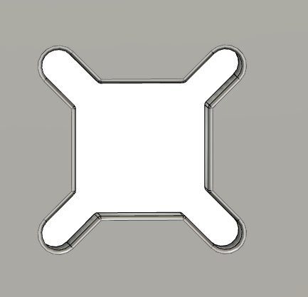

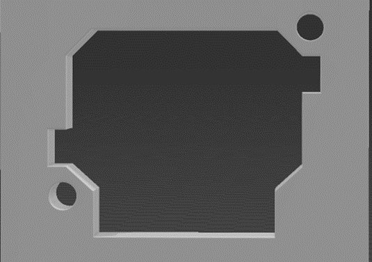

  27. Jun 19, 2022 at 12:38 AM
    #57
    Brums
    Apr 24, 2022
    #77540
    415
    Bethel, OH

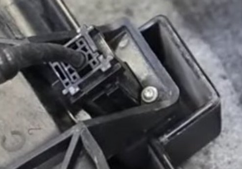

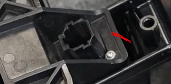

    well i got the camera mock up complete, just needs printed
    got the design for the camera connector / mounting scews pass through, i was going to do the shape of the connector, but its just too much, figure be little less precise make it a square just wide enough will be fine
    My grille should arrive on Tuesday, hopefully i will be home and not out of town working, that way i can get the angle of the bracket, and the locating pins and mounting holes and be able to get it all situated and drawn out
    Hugo Stiglitz, Yaboy and KClav like this.

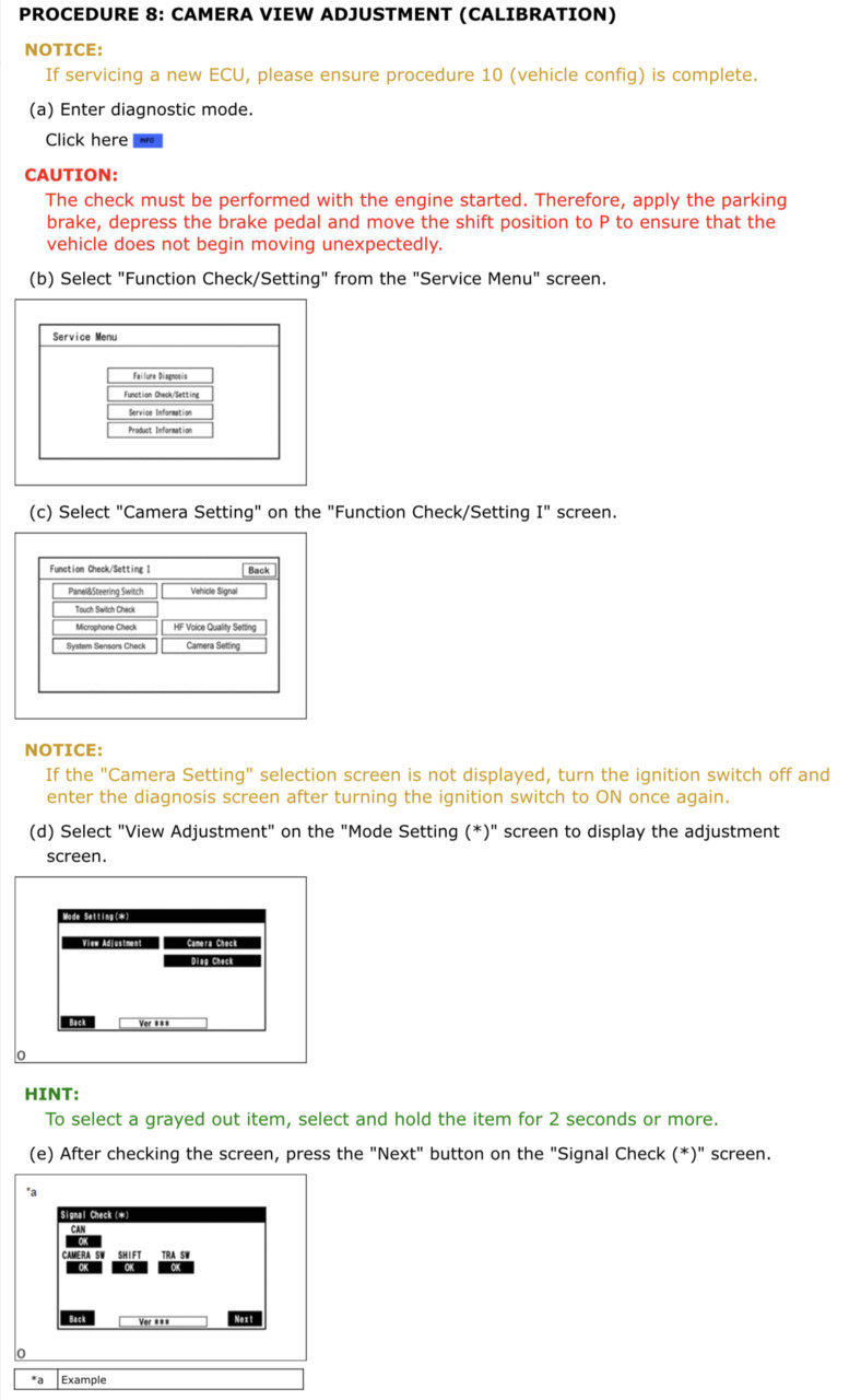

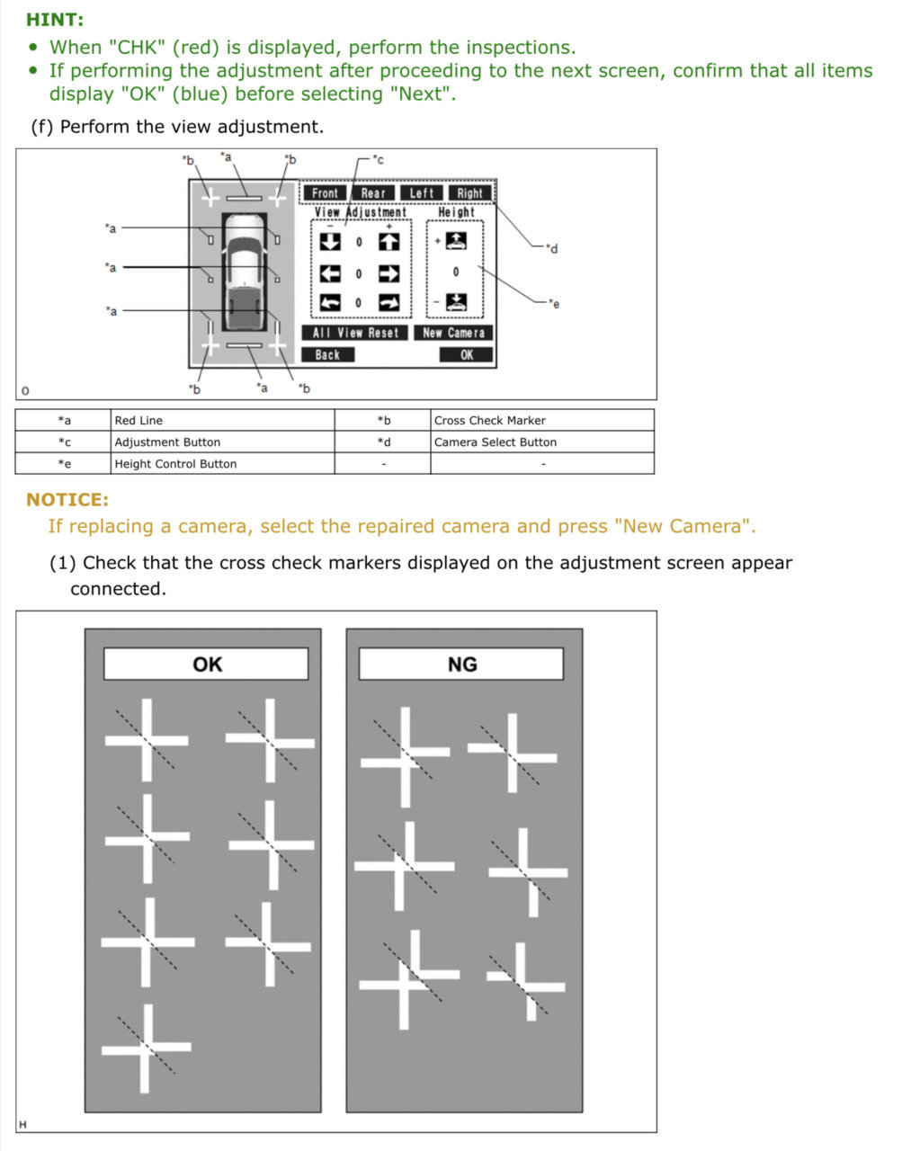

    You can put into diagnostic mode. You can calibrate the camera through the radio.
    mayan and rohit_trd like this.
  29. Jun 19, 2022 at 10:25 AM
    #59
    roboots21
    roboots21 New Member
    Jan 30, 2022
    #73899
    229
    Brian
    2022 MGM Tundra Limited DC
    This is great! How do you exactly go about getting into diagnostic mode?
  30. Jun 19, 2022 at 10:36 AM
    #60
    TakiEvo
    TakiEvo New Member
    Dec 28, 2021
    #72363
    662
    Allentown, PA
    2022 SR5 TRD Sport Crewmax White
    There’s 2 ways.
    Method 1: Using Techstream.
    Method 2: swiping radio screen procedure.
