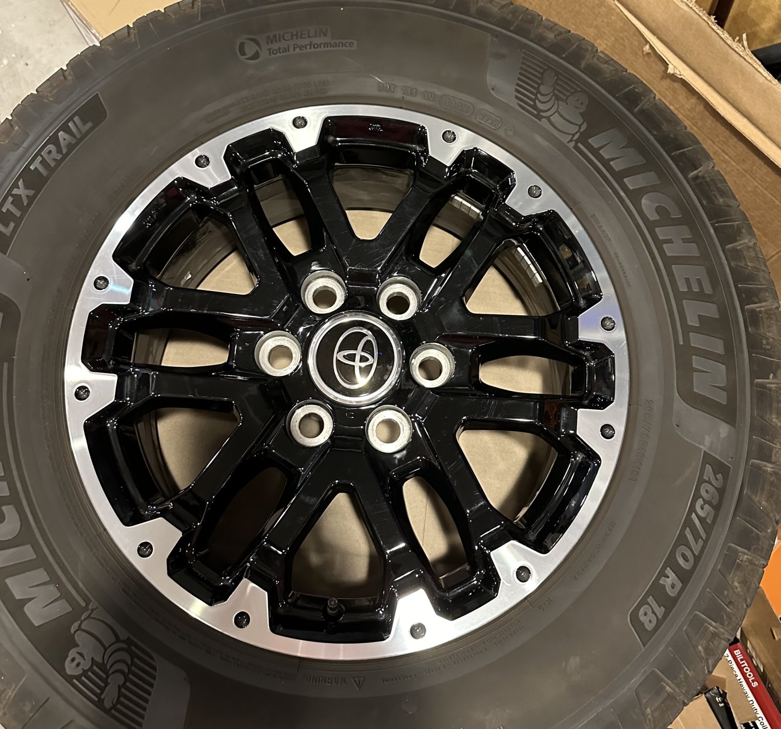

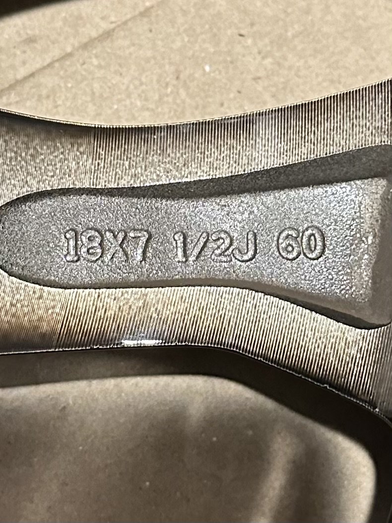

    Last Saturday, I took these wheels off my 23’ SR5 TRD OR and they are sitting in my garage.

    I think the Taco wheels have a 106mm center hole and the Tundra wheels are around 95mm. I think the Taco wheels have a more negative offset as well? Also, I am pretty sure that the Taco didn't have those wheels as an option.
    I got the same wheels with my 22 Limited TRD OR. You will need the lugnuts that match the wheels, the cone/taper shaped lugnuts that come with steel wheels won't work with these wheels.
    I don't see any reason why they won't fit over the brakes. You should be able to fit 17 inch wheels on your Tundra.
    Can you take a picture or 2 of the clearance issue and the brake and hub. Try to measure the hub bore and hub as well. These wheels will be hubcentric so they should fit snug on the hubs.
