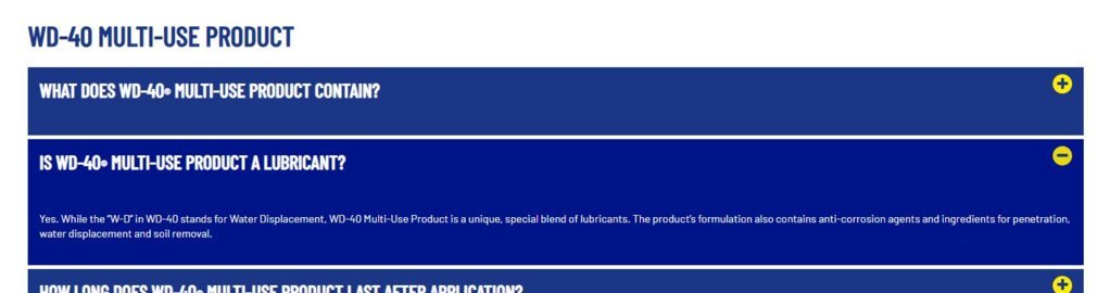

    I’ve only ever seen it promoted as a penetrant. Has lubricant and solvent properties. Intended to help get things “unstuck”.
    I use kroil. Add an actual lubricant once things are cleaned and moving freely.

    Maybe in marketing/advertisements, but on the WD-40 website FAQ, they clearly state, it IS a lubricant.
    I've found it to be a much better solvent than a lubricant.
    I will say that because it is such a terrible lubricant, they should get rid of that statement in their FAQ.
    It's like saying water is a lubricant. Yeah.... technically. Another really poor one.
    *EDIT* Or 0W-20 motor oil!!:crapstorm:

    Huh, everything I've seen just said "lubricating properties" so I stand corrected.
