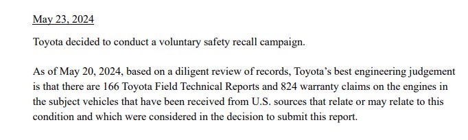

    So there's 133 trucks listed in there. That kinda proves my point. I don't think that sample size is enough to carve it in stone. Do we know how many engine failures in total have happened?
    They recalled something like 100K vehicles with the engine, and as of May of 2024 Toyota was reporting 824 warranty failures. Bump that to 1000 failures for easy math and out of 100K recalled it is a 1% failure rate. That means the 133 trucks in that document are 13.3% of 1% of the total data on just the recalled engines, let alone the total number of engines. That's not enough of a sample size to say that more frequent oil changes does or doesn't help.
    Source: https://static.nhtsa.gov/odi/rcl/2024/RMISC-24V381-8150.pdf
    Filtering the google doc to only show those who did 10K OCIs gives a total of 69 failures. That's just over half that had 10K mile oil changes. 51.8% actually. So in the sample, which is statistically very small, it's about an even split on the failures.
    The data that is missing, though, is how many that have not had failures are also doing early oil changes. If the majority of the trucks that have not failed are also getting 5K OCIs then it could indicate that it is helping. That data is missing, and nearly impossible to obtain. If it showed a similar 50/50 ratio of 10K vs 5K OCIs, then the case could be made that there is no impact to the failure rates based on how often the oil is changed. Still, without that data it can't be declared one way or the other.
