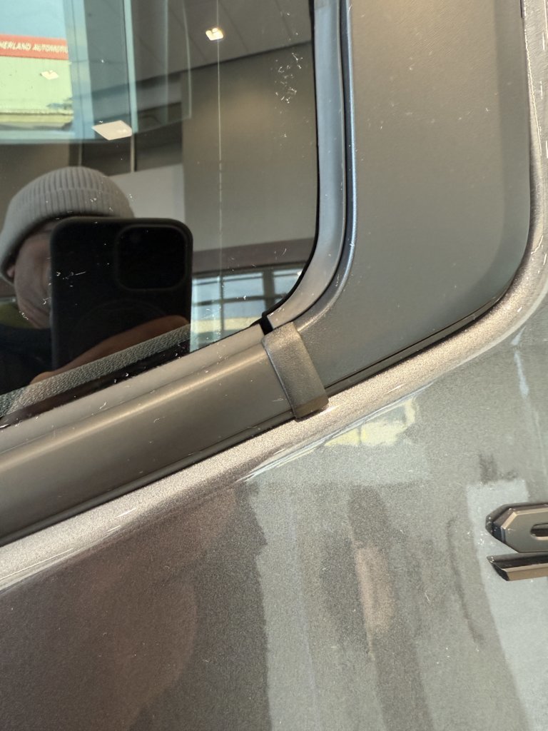

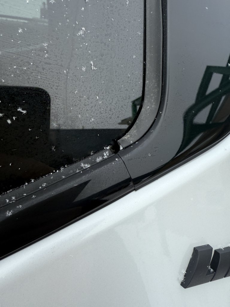

    2025 Tundra TRD Rally
    It's a beautiful truck and we love it. It drove beautifully until I came out of the grocery store and tried starting it. Hopefully the issue is fixed and we don't have any other breakdowns. I do have to say, the dealership was amazing with their response and help with this situation.

    You won’t get that piece on the gloss or chrome window “trim”. I always have thought that is ridiculous.

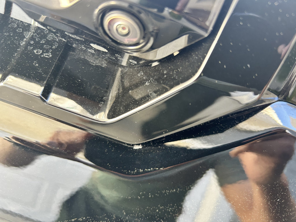

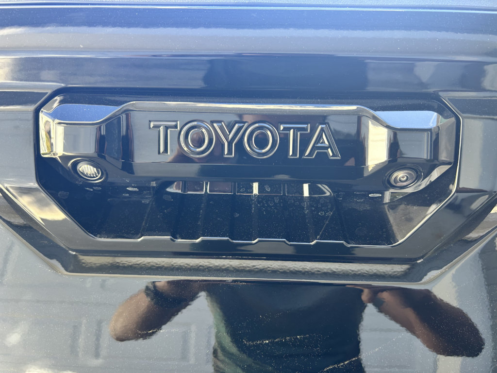

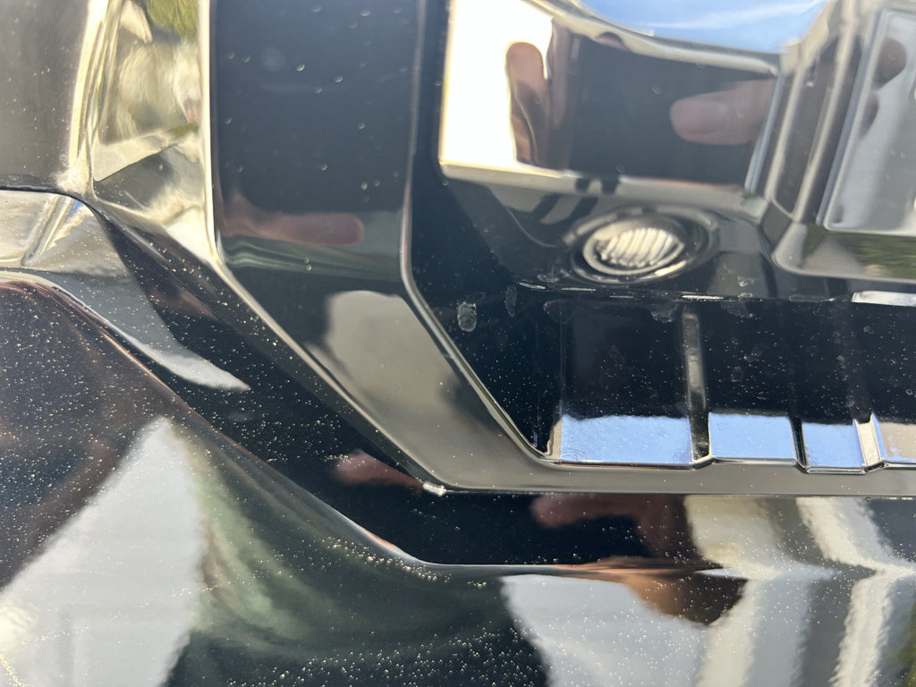

  6. Mar 17, 2025 at 3:55 PM
    #66
    Alphagreen
    Alphagreen [OP] New Member
    Dec 26, 2024
    #127852
    11
    25 Tundra TRD off-road limited
    Anyone have any paint chipping on/around their tailgate handle? Here are some picture of what I'm seeing on my truck. I'm starting to think that they installed the lip spoiler and painted it. Instead of painting both separately then installing?
  7. Mar 17, 2025 at 4:28 PM
    #67
    jaxadam
    jaxadam New Member
    Aug 19, 2018
    #18336
    106
    Common on almost every one I’ve seen.
  8. Mar 17, 2025 at 4:32 PM
    #68
    lapoolboy
    lapoolboy New Member
    Jan 15, 2024
    #110274
    962
    I was proactive and spaced out the spoiler on mine to keep it from contacting the tailgate in those corners. Take the inner tailgate access panel off, remove handle, put a couple of rubber grommets in between the spoiler and tailgate, and reassemble. I now have about 1/16" clearance all around.
