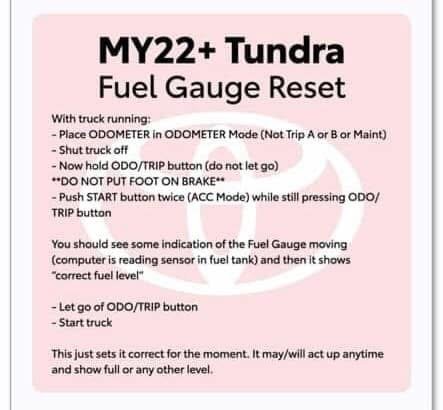

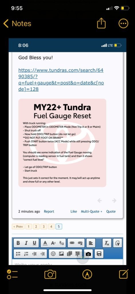

    This works for me when it happens.

    I followed this image that I found of this forum. I don’t remember the original thread.

    Oh, Ok. This sounds like the Maint reset on my other Toyota's ('07 Tundra & '13 RAV4) for when I've changed the oil/filter. I assume it does a recalibration of the fuel gauge as well?
    Thanks for the info!

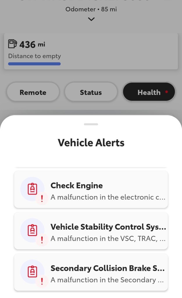

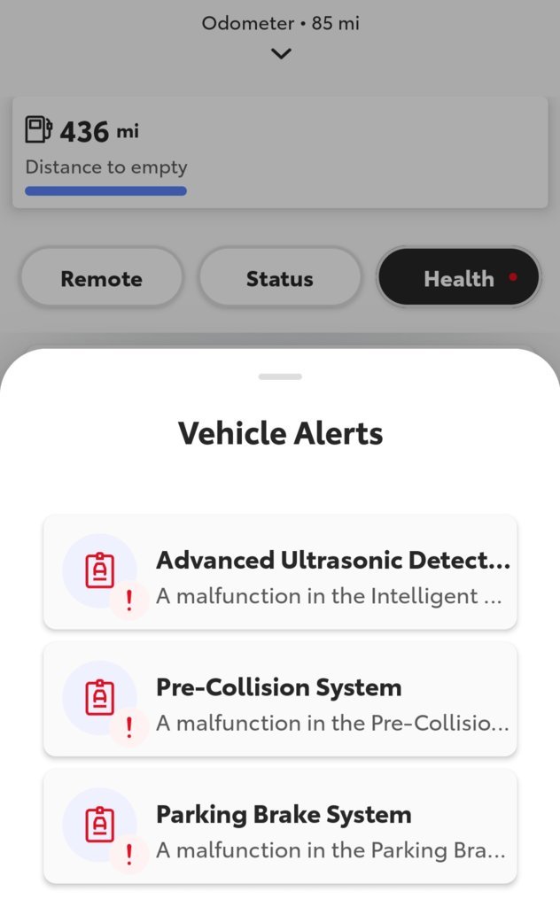

  28. Mar 13, 2025 at 5:04 PM

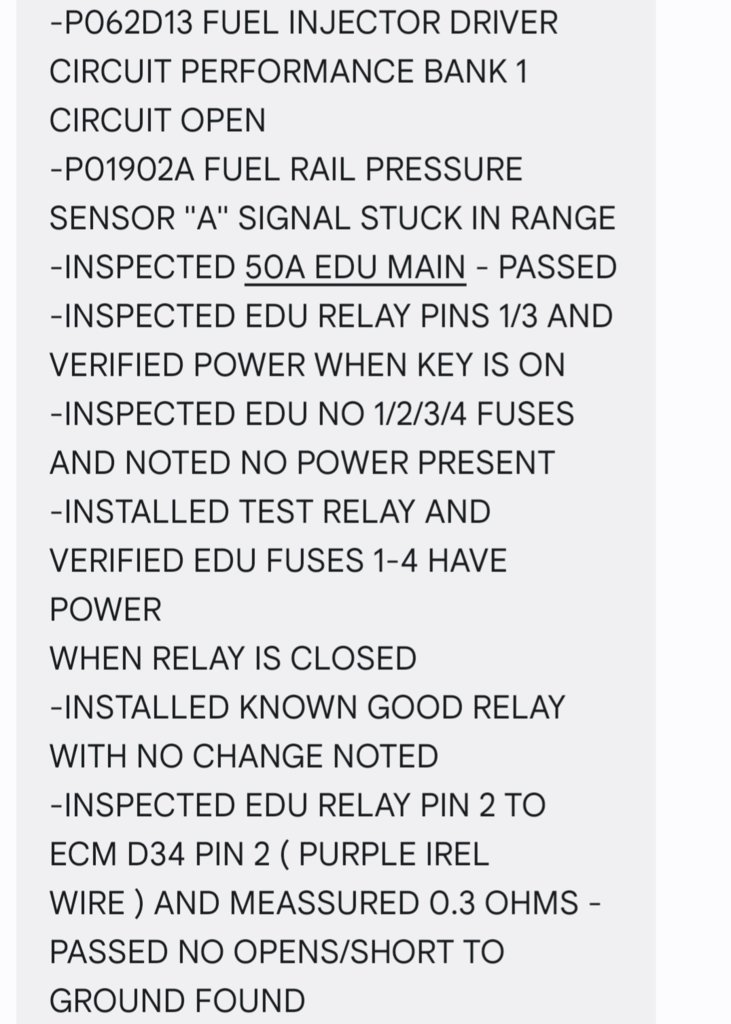

  29. Mar 14, 2025 at 12:49 PM

  30. Mar 14, 2025 at 1:15 PM
