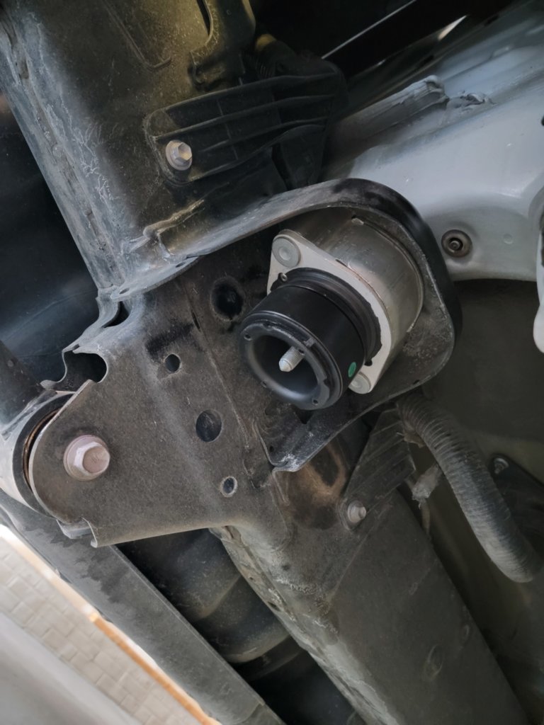

    I torqued my cab mounts and that significant reduced the clunking on bumps I was experiencing. I still get it on big bumps so might consider replacing them eventually.
    I also retorqued the bed bolts after backing them out and greasing the contact points with the frame. I found when I loosened the bolts, half of them popped like they were holding a bunch of tension from the composite bed. Now my bed rattling is gone!!

    Any chance you can post a pic showing the location of the cab mounts/bolts? New owner here with only 1,000 miles but already scared I’ll develop the clunk and want to be prepared when the time comes ….

    Happy customer over here finally. I have 13k miles on my 24 Platinum and I told my dealer about a noise that was driving me crazy at low speeds over bumps at my 5000 mile oil change. They inspected truck and didn’t find anything abnormal. I have a lot of stuff in my bed and I figured it was something rattling cause I took everything out and for a quick mile jaunt I didn’t hear it. Since then I tried securing things better but the noise was still present. Went in for an oil change the other day and showed my dealer this forum and insisted they check my bed bolts and my cab mounts especially the drivers side. After a little back and forth he agreed that it was most likely the cab mount and he replaced drivers side. My noise is finally gone. It was a light thumping noise that I was hearing. Thank you to this forum!!!! Hope this helps someone else.

    The noise baffled them too. My guess is this was their first go around with it. They had truck there for 2 weeks. Ordered and installed bolts, washers and bushings for the rear seat. At this time I took to the interwebs LOL. Found this thread and played the video and had immediate PTSD. There was the exact noise! Kept reading to discover yall had rear cab mounts replaced. I mentioned this, and sent a link to this thread to my dealer. Another 4 days go by. They reach out to tell me they replaced the bolts and bushings I mentioned above but the noise was still there. Shakes my head. Once again I point them to this thread, a bit more sternly and make a strong suggestion that they check the rear cab mounts. A week goes by and lo and behold, I get a text that they checked them, and replaced them. Problem solved! If only they had listened to me the first time. Would have saved themselves a lot of time and money. Anyhow this thread is a lifesaver. Hopefully it helps out fellow owners as I am sure there are many more out there going through this right now.
