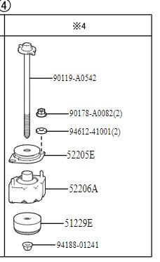

    May 16, 2024
    #116974

    Here is my update. After 3 hours and 4 techs they finally read these threads and listened to me about the cab mount. He took off the drivers side mount, test drove it and no clunk!! Showed me the mount and it had been installed offset and you could see the grove worn into it from the clunking. He put it back on and the clunking is back. They have ordered me a new one and should be installed in a few weeks.

    Yes same sound as mine. Narrowed it down to the cab mount and physically took it out and drove with it removed and clunk went away. Also saw wear evidence on the removed mount. Not getting mine replaced until mid October, so will confirm then. Right now I am still driving with the same mount and clunking noise.

    Has anyone recently got the can mount fix done? I was told parts are on national back order so just curious if anyone has started to get an allocation on the fix.

    For those that have replaced the hydraulic cab mounts, do you have the part number from your repair receipt? Just curious if this was it: #51229-0C030

    Just had the cab mount replaced today on driver side and rattle is gone.
