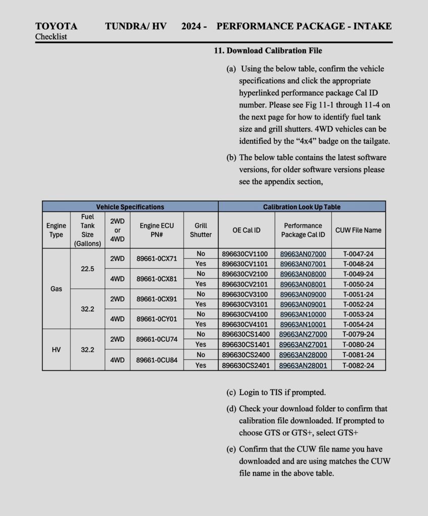

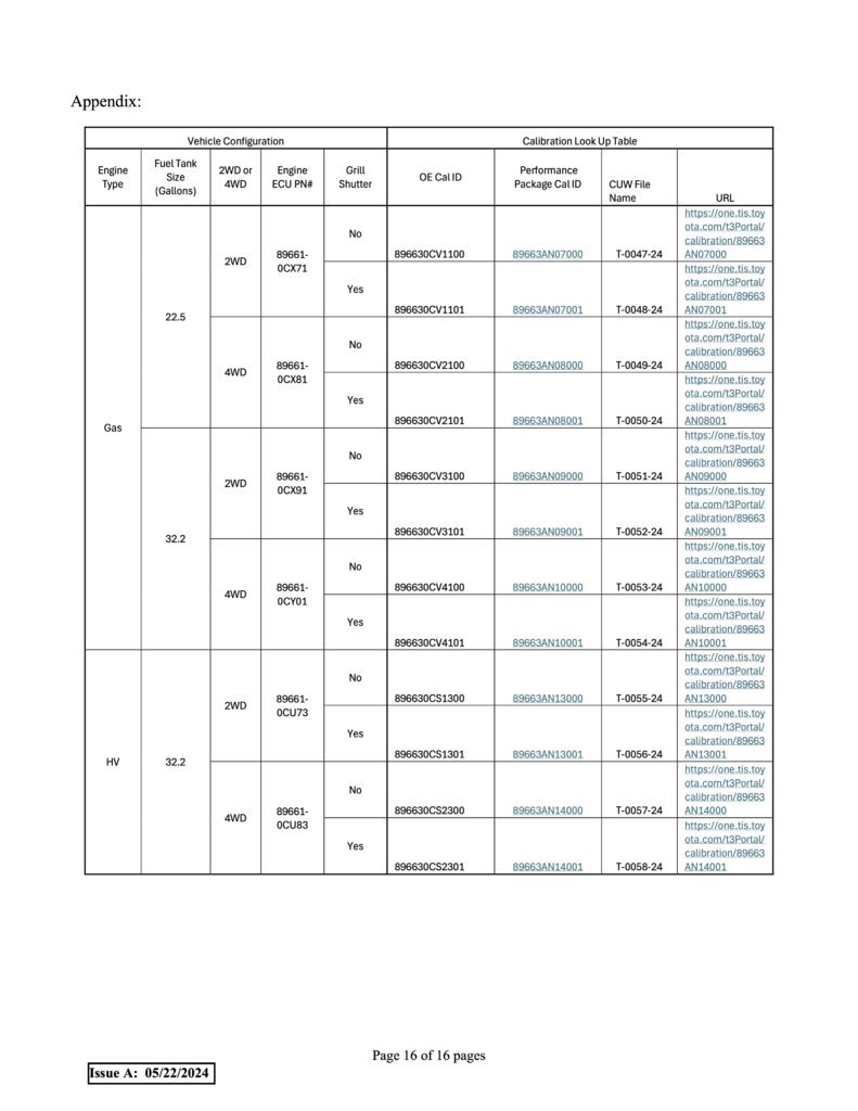

    Well got it reprogrammed, my build date was 3/15/24.
    Luckily I was able to get in touch with someone who use to be on here, we looked into it was able to find the program that was issued in May 24, there is newer one is out, but doesn't include my ECU. Technican at my local Toyota dealer was able to get the May 24 issued program for the ECU, installed program. Throttle response is allot better in my opinion, feel smoother and crisper and by seat the pants feel, seems as advertised by Toyota. If you have Carista, you can get either the Engine ECU PN# or OE Cal ID, which mine was the 896630CS2301, and they programmed it to the Performance Package Cal ID 89663AN14001. Took took the technican about 45 min, was $162.13.
    I was able to get the Air Intakes at $596, so I am into it $758.13 this doesn't include the exhaust which I got 2yrs ago from. Keith at Dirty Deeds Industries, have the cat back exhaust system, which was on my previous gen3 tundra.
    Some may say its to expensive, your not getting what you would from JB4 or Stillen etc, but for me to still be under Factory warranty was a plus.IMG_2406.jpg IMG_2433.jpg
