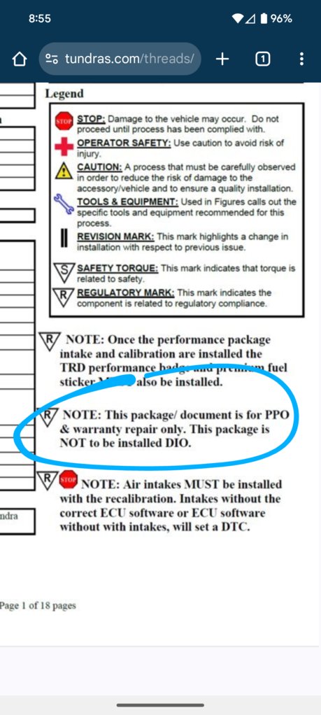

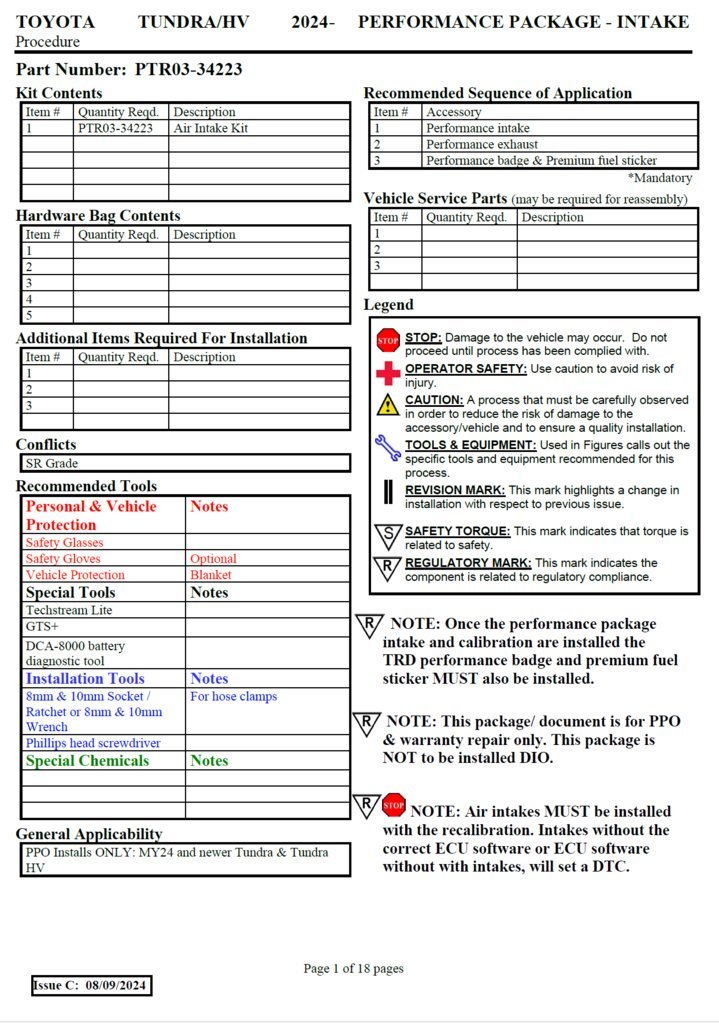

    Cannot be dealer installed.

    It has to be installed at factory or port before delivery to dealer.

    I dont think that is correct, or they wouldn't let you order the parts and have the software update done. I just bought the CAI, will have it Tuesday, dealership will do the software update

    Good luck. That's not how it's written but keep us updated.

    Found this on Toyota parts page.
    Disclaimer
    The TRD Air Intake is to be sold as a dealer-installed or over-the-counter option after the retail sale of the vehicle. The Performance Air Intake may not be sold to the customer at the same time as the new vehicle and may not be financed together with the new vehicle. Please see the TRD catalog, visit www.trdusa.com or call 800-688-5912 for a complete list of TRD products and warranty information. Emission-legal for aftermarket sale via C.A.R.B. Executive Order.

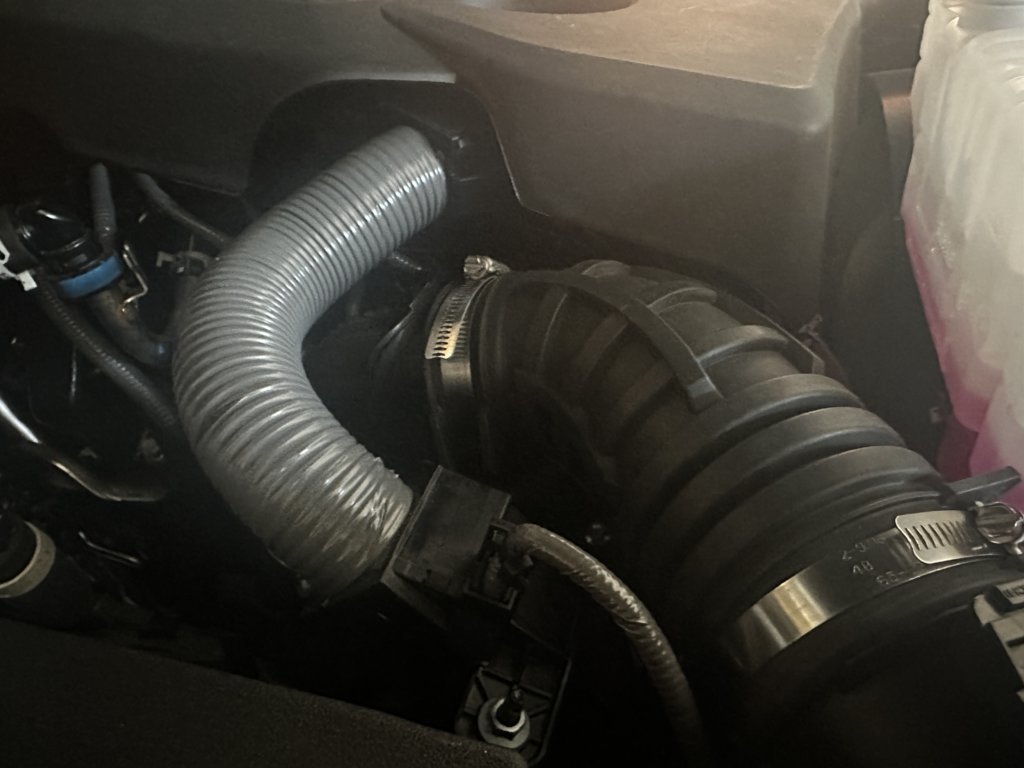

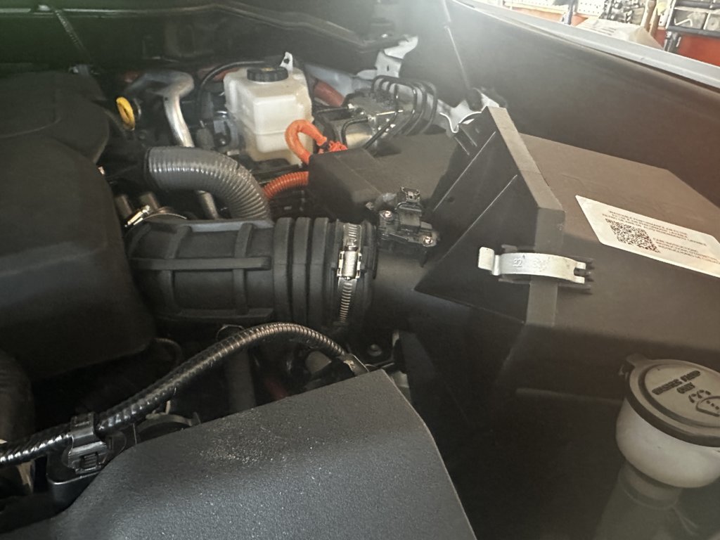

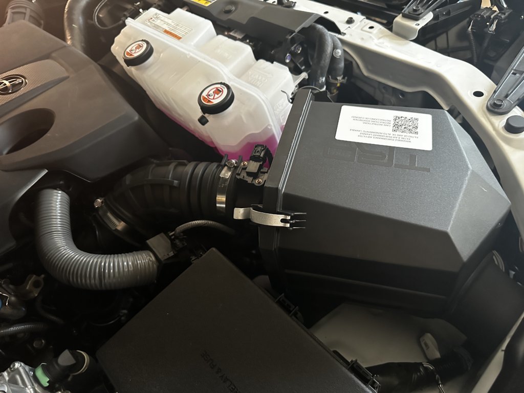

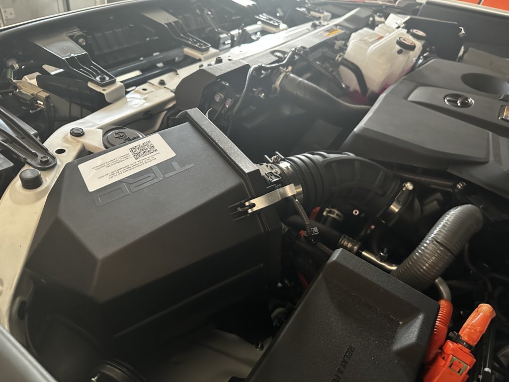

    Just installed the CAI, after about 30 miles, CEL did come on, taking it in tomorrow to get it programmed. It is a quality CAI, fits better than the AFE CAI, seems to be easier to get the filter in and out than the AFE. Will see after tomorrow how it feels and runs.
    Will take some pictures later on today.

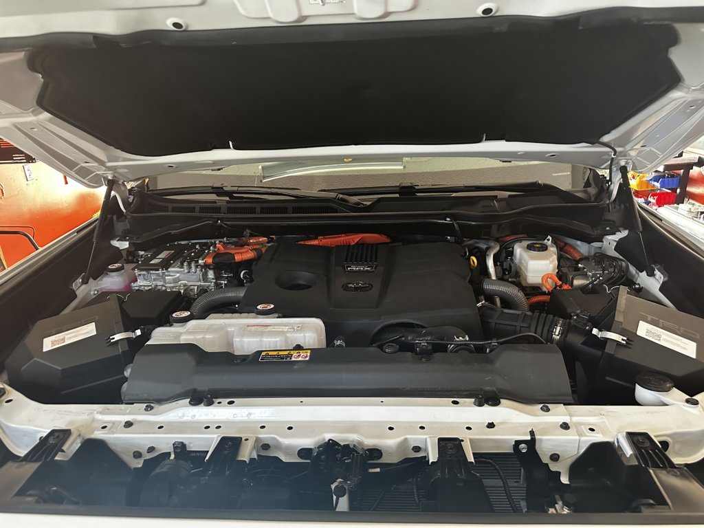

    Here are the pics.

    looks factory as it should
