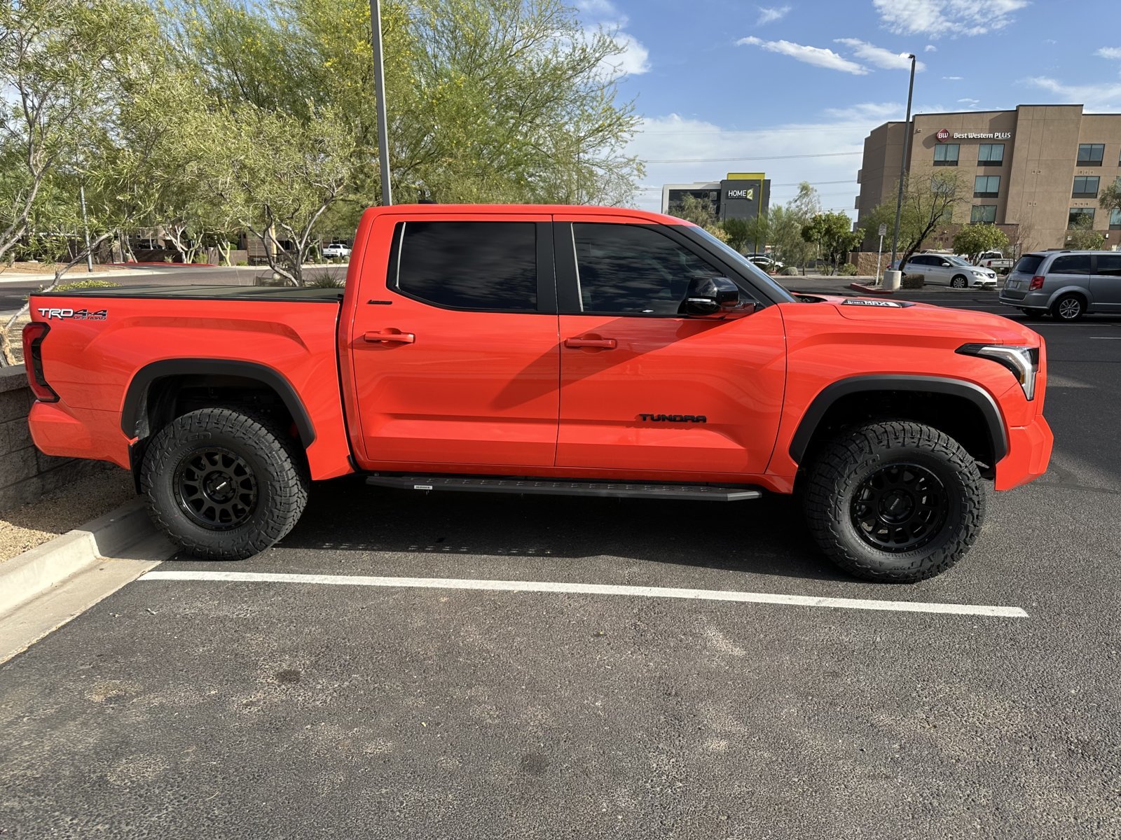

    I just went with the Westcott lift, but added the TRD Bilstein Shocks from the TRD lift kit, and Dobinson's rear lift springs, because I still wanted a little rake since I tow. Ended up getting 1.5 inches of rake out of it. I'm in Phoenix, so Westcott installed the lift. Added 35s and some Method wheels too. My son works at Discount Tire, so I got a smoking deal on the Methods and tires. Ride is amazing, almost as good as stock, looks fantastic, about 2 inches of poke on the tires, and I feel like I'm a foot higher than I was, even though I'm only 4 inches higher, as measured at the wheel arches. The best part, the cost for all was about the same as buying the TRD lift and having it installed. The TRD lift doesn't come with wheels and tires. Heck of a value.

    Beautiful truck,,,first Solar Octane non Pro I’ve heard of. Looks very sharp!!!

    Thank you sir. Actually we have 2 Solar Octane non-Pros in the house. 3 weeks after I bought my Limited, my son got an SR5 because he also loves the color.

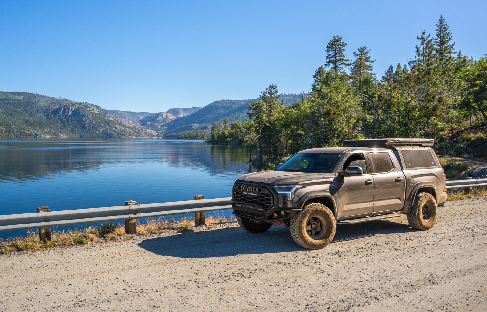

    I went w/ a full Dobinsons MRR w/ adjustable reservoir setup. If you don't plan on taking it off roading a lot, their IMS will be sufficient. Mine often sees the trail and love the ability to adjust how soft or hard my suspension is. Like others have said, there are many aftermarket options there.

    Nice looking rig my man!

    What bumper is that? 35's or 37's?

    Lil B's fabrication bumper w/ 37 Toyo's
