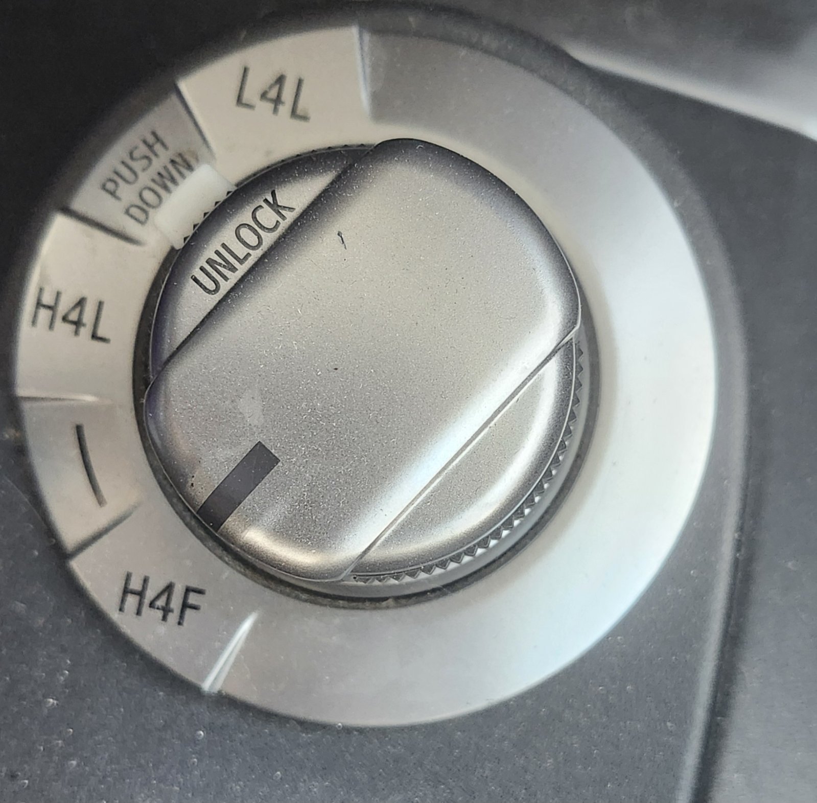

    You want the truth? Can you handle it?
    Go up to your Front Diff and have a Come to Jesus Mtg with it.
    Look at its round face. Stare it down and ask it nicely.....
    Hey Diffy……if we are travelling on a good dry road, and I reach over to that thingy, button, dial thing on the dash and turn it so it points to 4Auto. Are you at this point going to be helping me drive the vehicle or are you just hitchhiking?
    It will give you the truth.
    '8^0

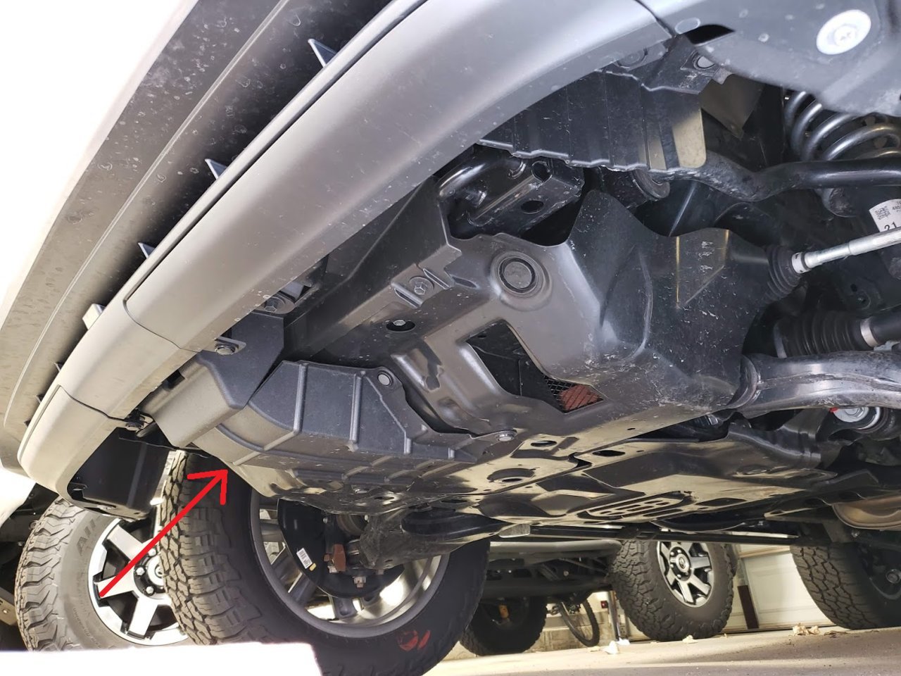

    If you want to keep and enjoy driving the truck in the same manner, add an external oil to air heat exchanger for the transmission.
    This is not Toyota’s first screw up with transmission cooling in a Tundra. Early Gen 2 trucks have high load low speed issues.
    As for skid plates blocking air flow, they certainly can, do, and may cause high temps and/or over heating of various components. How much are they contributing to your transmission issue? Testing back to back will be best. The dealer testing your truck and several others shows it’s an issue even w/o skids.
    Examples of skids causing issues.
    3rd Gen Tacomas have an oil temp sensor and overheat warning for the front diff. Toyota possibly deemed mpg more important than cooling the front diff.
    Some AWD 4-Runners received serious cooling vents and ducting. Obviously there was some cooling issue here… a grill fed duct and vent.

    Sorry for the frustrations. My '17 4Runner is a better vehicle for 70% of what I do. But it doesnt allow me to just toss and inhale stuff in the bed and not worry about it. You need to be careful not to scratch and mar the inside. Yeah you can put a full enclosure inside but still.
    And it returned 10.5 l/100 on my last trip fully loaded. Thats 22 mpg. The Tundra would have returned 19-20 mpg. So @Terndrerrr
    I think 19 is very efficient ? very happy with it.
    Yes my 4Runner has that opening in the skid plate. Calling it AWD however is not the right term fwiw. You don't have 4Hi and 4Low with AWD. There is a reason Toyota uses an "F" for Full time 4wd on the shift knob. Just saying.
