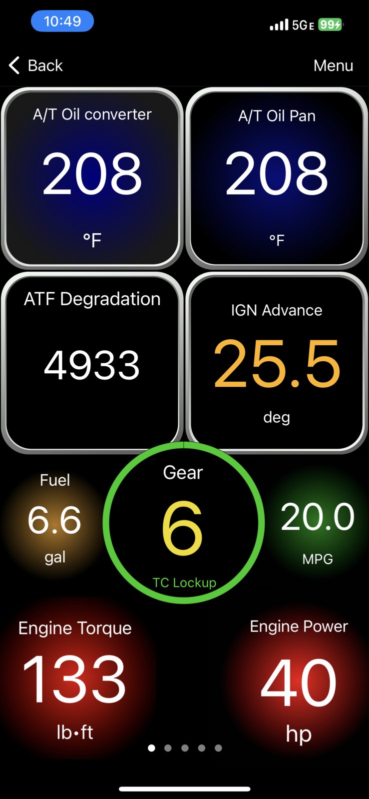

    @Terndrerrr have you ever looked at your ATF Thermal Degradation estimate?

    I have

    Is that OBD Fusion? I have never been able to find gear status and TC lockup.

    Yes, both in here
