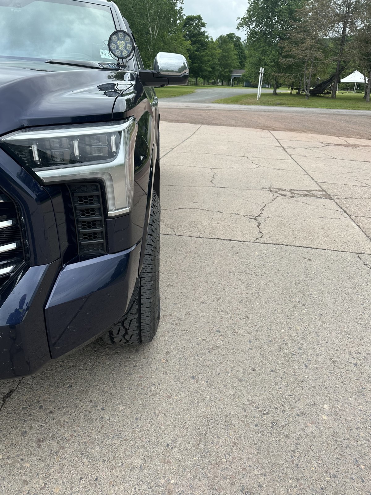

    '23 Sequoia here with a Westcott lift. It fits 35s with absolutely no trimming. It rubs a slightly at full lock.

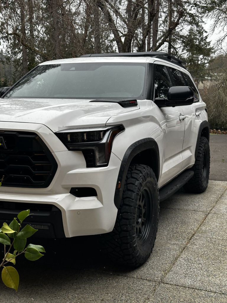

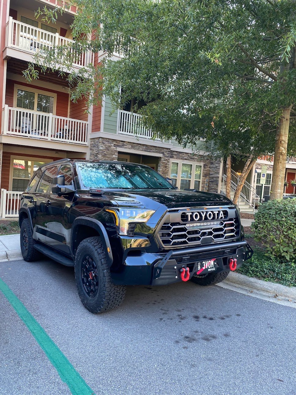

    35x12.50x18 +20 offset. Did have to do some trimming. If you did a +30 offset you would probably have to trim less.

    2025 Mudbath Sequoia
    All great looking vehicles! I’m looking to do the same. The stock tires are not cutting it. I lm LOVING the +20 offset.
    @Runn4est Was that on stock suspension?

    Thank you, yeah this is fully stock trd off-road. I have 2 4runners on big tires, one that I exclusively wheel, so I'm not shy about trimming. I really like the OEM + look on the Sequoia. With the +20 offset, I had to trim about 1/4 inch off the top of the inner fender flares. For good measure I rolled the lip of the fender a little, but I think that was unnecessary. I also spoke with durobumps and their offering is about 1/2 inch taller stop, so that could potentially eliminate any full compression rubbing all together. I currently only rub a smidge at high speed dips and bumps.

    Thank you, I appreciate that. They're Fuel D664 in 18x9 +20. As I mentioned earlier, you will have to trim some, so as long as that doesn't bother you, this size rim looks great. I think it's the perfect amount of poke.

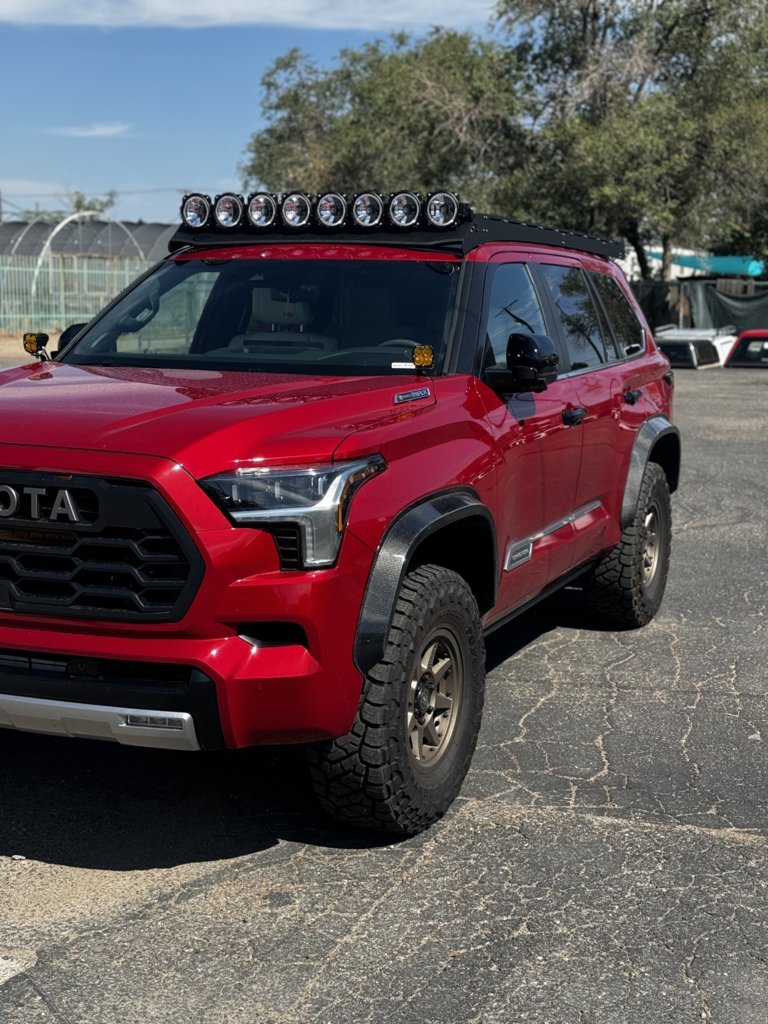

    Here's my setup on my 25' TRD Pro. Love how it turned out.

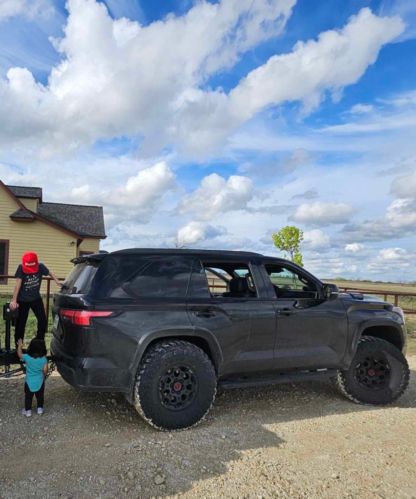

    Icon stage 3 lift, icon wheels wrapped in 35” Toyo open country rt tires. TRD pro conversion grill, Prinsu roof rack with 50” KC Hilights gravity pro6 light bar, and Baja designs ditch lights. And NYTOP gloss carbon fender flares.
    Our 24 Sequoia capstone with icon stage 3 lift running toyo open country m/t 35x12.5. Love this setup and definitely turns heads everywhere we go.

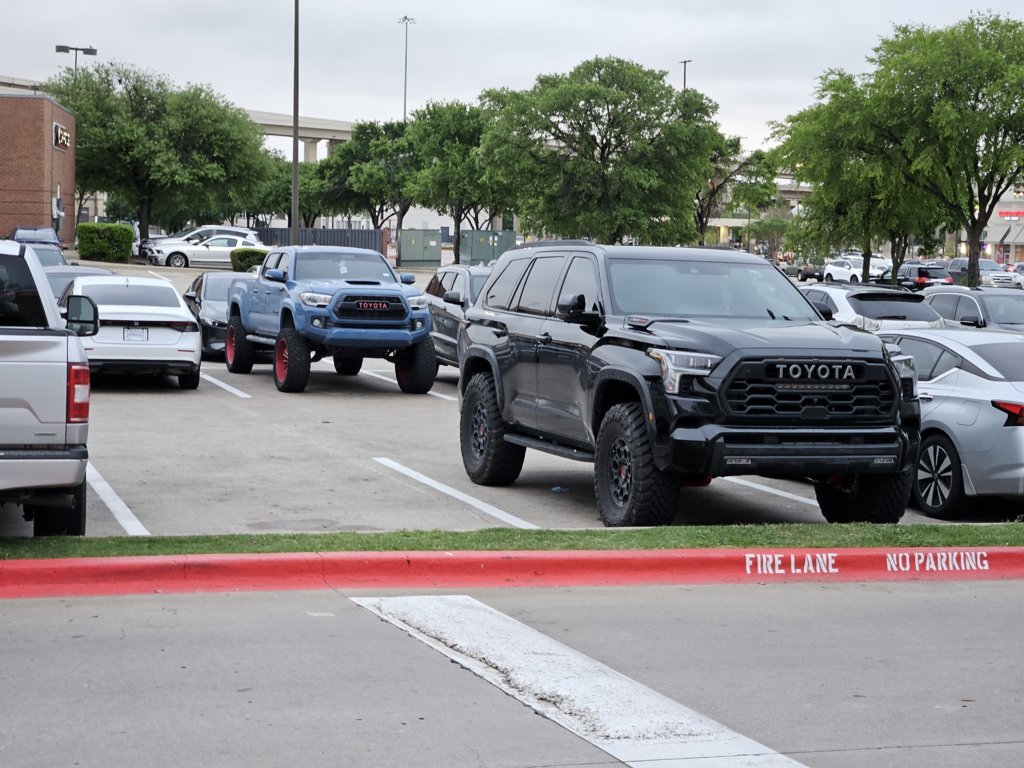

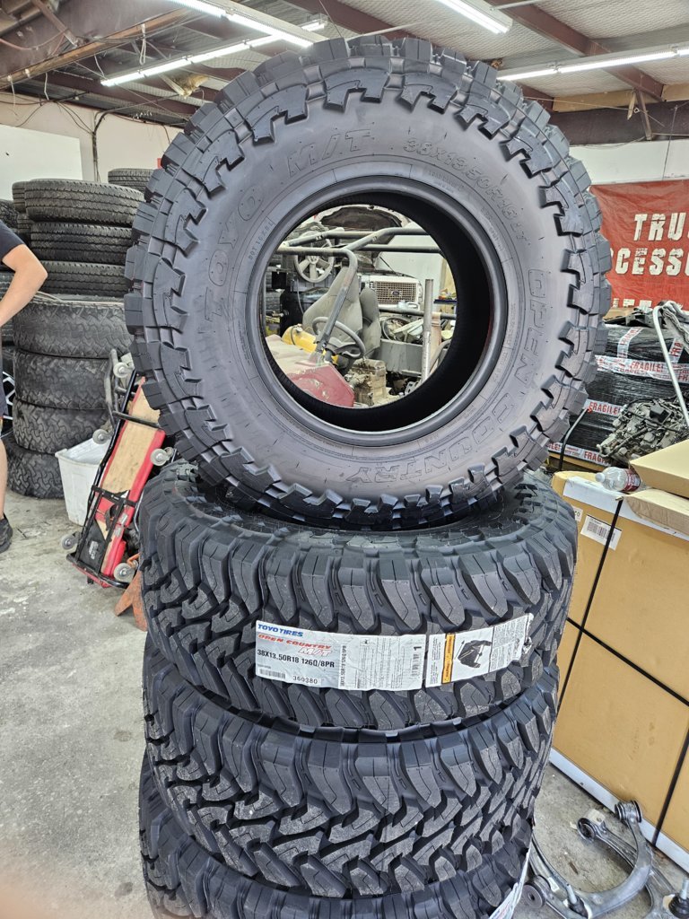

    Eibach 1.5" tundra trd pro 38x13.5 Toyo m/t
    20250325_105717.jpg Screenshot_20250329_000146_Messenger.jpg 20250326_225618.jpg 20250404_190843.jpg

    Westcott designs 3"/1" lift 295/70/18 Falken Wildpeak RTs Canvasback cargo liner aFe Tow hooks
    What the hell kind of hacking did you have to do to get those to fit?

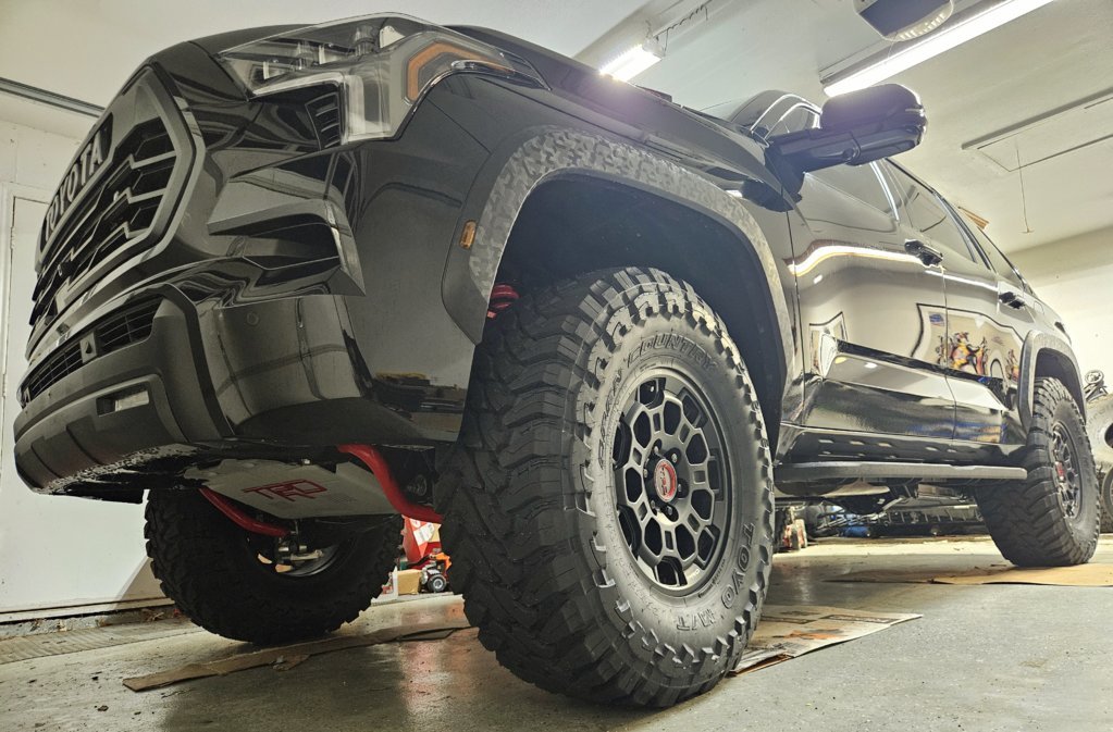

    No hacking. Rear fits perfect. Test fit with 39s I had for another vehicle so those could fit. Liner mount unbolts in front and removed tire horn just to be safe.
    38" mud Knobbs lightly rub on stabilizer bar at full lock. Thats it. Never full lock at any appreciable speed.
    Eibach springs for the oem foxes and 37x12.5 will fit perfectly all day. Offset them out and u f everything up...

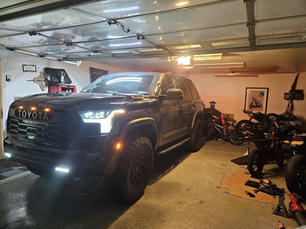

    I'm considering ordering a 2025 1794 for my wife and immediately installing the icon 3" lift with icon 17" wheels and 35x12.50x17 tires. I'm concerned that her car would no longer fit in our 7' tall garage opening. Can any of you who have a similar setup tell me overall height?

    Looks like factory height is 78, so, 4 inches more than that, puts you at 82 inches, which is just below your mark. The width of these trucks are what get me. I can't fit in my garage because it's too wide.

    20250405_010452.jpg I still fit in a standard garage door and im on 38s sitting 1.5" higher eibachs than a trd pro tundra. Also fits on 40s.
