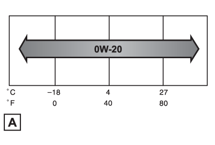

    I'm searching the o'reilly auto parts website and there are some, mostly all of the 0-20 Mobile1, says "does not fit Vehicle" (2025 Tundra) ?!?
    Anyone know what the recommended Viscosity Index is for our trucks?

    Engine oil selection“ Toyota Genuine Motor Oil” is used in your Toyota vehicle. Use Toyota approved “ Toyota Genuine Motor Oil” or equivalent to satisfy the following grade and viscosity.Oil grade:ILSAC GF-6A multigrade engine oil Recommended viscosity: SAE 0W-20[​IMG]Outside temperature SAE 0W-20 is the best choice for good fuel economy and good starting in cold weather.If SAE 0W-20 is not available, SAE 5W-20 oil may be used.However, it must be replaced with SAE 0W-20 at the next oil change.Oil viscosity (0W-20 is explained here as an example):The 0W in 0W-20 indicates the characteristic of the oil which allows cold startability. Oils with a lower value before the W allow for easier starting of the engine in cold weather.The 20 in 0W-20 indicates the viscosity characteristic of the oil when the oil is at high temperature.
    this is in the owners manual.

    On O'Reilly's website, the only difference I can see between a Mobil1 (Not Fit) and Royal Purple (Fit) is the Viscosity INDEX.
    Mobile1 has 175 and Royal Purple has 168. I'm just curious to know how a store like O'Reilly/Autozone/AdvAutoParts/etc can determine this specification.
    If you go to Mobil1's corp website, they say all their 0-20w fit the truck..
    Is this just marketing? They trying to push one brand over another?
    Maybe I'm just thinking too much into this, i've always been a Mobil1 user and am not worried about a website saying it doesn't fit. ;)
